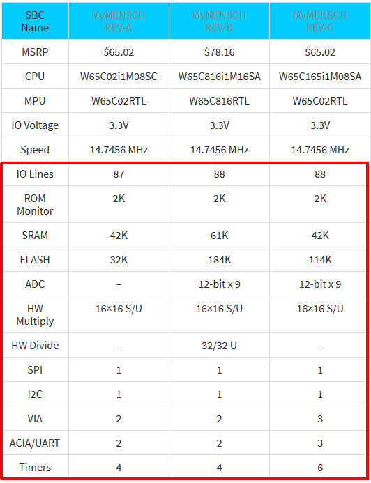

It seems to be an updated, upgraded, enhanced w65c256s. It even has one of the features I miss from the '265: being able to program it with custom boot code instead of relying on an external ROM.
It also has enough internal RAM to not to consider it a toy and different interfaces that allows to communicate with devices so the address and data bus can be left untouched.
Is anything wrong with this design?

Were to begin...
1) Its too expensive. Put out a base price that is comparable to the component cost and license the software separately. Most SBC's have alot on the board, but the Mymensch is more like a PicoPI or Arduino nano at the moment.
2) Power requirement. The 65x02 series is known for its low current consumption. How does this solution compare? I can't find anything about current in Rev-C. Its superimportant.
3) Make the oscillator frequency source a choice for the user. Either internal oscillator or external. 14MHz is comparable to very cheap arduinos. You can get a STM32 card that runs >100MHz. A Risc-V runs at several hundred. If you don't have 2), you need this.
4) 5V interfacing. The 65x02 series can go there, so why change to this at same speed?
5) Its often about shields. The Arduino has them, The Raspberry PI has them, most STM32 SBC's has them. Today we want to put on a display and get something up and running. All schools here use Arduino if speed isn't that important, and its because you can plug in everything from gas sensors to displays and lasers.
6) Software. Make it Arduino IDE compatible to get a chunk of that market. Most other SBC's can be controlled from that, either through a supplier's library or a third-party library. Its always free and its relatively easy to use.
7) More software. Think Lego mindstorms. They are super-easy to program for anyone. Click-n-drag objects to get functionality. Graphic IDE.
If you want into R&D market you need 7), but also interfacing. Think Labview. Researchers know almost nothing about programming these days and need solutions that work. Sensor data and stuff like that. Not everything needs 10GS/s and a i9.

Just to recap, the MyMensch SBC offering is a small FPGA-based 6502 dev board, 3.3V I/O, 14.7MHz clock, for $65. There's a corresponding mainboard to go under it, the MyMENSCH PRO Board, for $28.
One might view this as an educational offering, to be bought in the dozens by colleges or similar. Or as a dev board for someone planning a design which would use WDC's IP. Or as a hobbyist board, which is probably where most of the audience here are coming from.
It might be that the board is well-designed and easy to work with. I think it would need to be, given the availability of open source 6502 cores which run at 100MHz on cheap FPGA dev boards. I think that's what I'd compare it with. It might be that the $65+$28 is quite a good price for the amount of I/O you get. But most likely, competing solely on price isn't the thing, because it's the ease of getting going and unlocking the potential that's important.
It's possible that the SBC being FPGA-based isn't important - maybe you're not expected to customise the on-chip hardware, only to use it as-configured. In which case it would be good to know what that hardware looks like.

So, we have a compact SBC that features all of this:
Several standard, "classic" 65xx I/O ports and several extra stuff like SRAM, flashable ROM, ADC, hardware multiply and divide units, SPI, timers and a bunch of I/O lines, already mapped in the first 64K of RAM.
And everything handled the 65xx way, so any existing code could be recycled for them, and the standard tricks that hardcore programmers use could be applied.

That does sound like a good mix of micro-controller type peripherals. (I'd be particularly interested to know how it presents the multiplier.)
So, yes, it's all there for you, and no messing with FGPA toolchains. And the price is comparable or better than the least expensive FPGA dev boards. (The price of the FPGA chip is a minor part of that.)
On the other hand, anyone who enjoys creating and building FPGA designs can build their own, should they wish.

Shucks, neither of WDC's websites is coming up for me right now to see how they did the A/D's; but 9 inputs of 12-bit A/D converter probably puts it in a category above what most FPGAs will do.

How to access it at the most basic level is described on page 28 here:
https://www.westerndesigncenter.com/wdc ... 1M16SA.pdf
