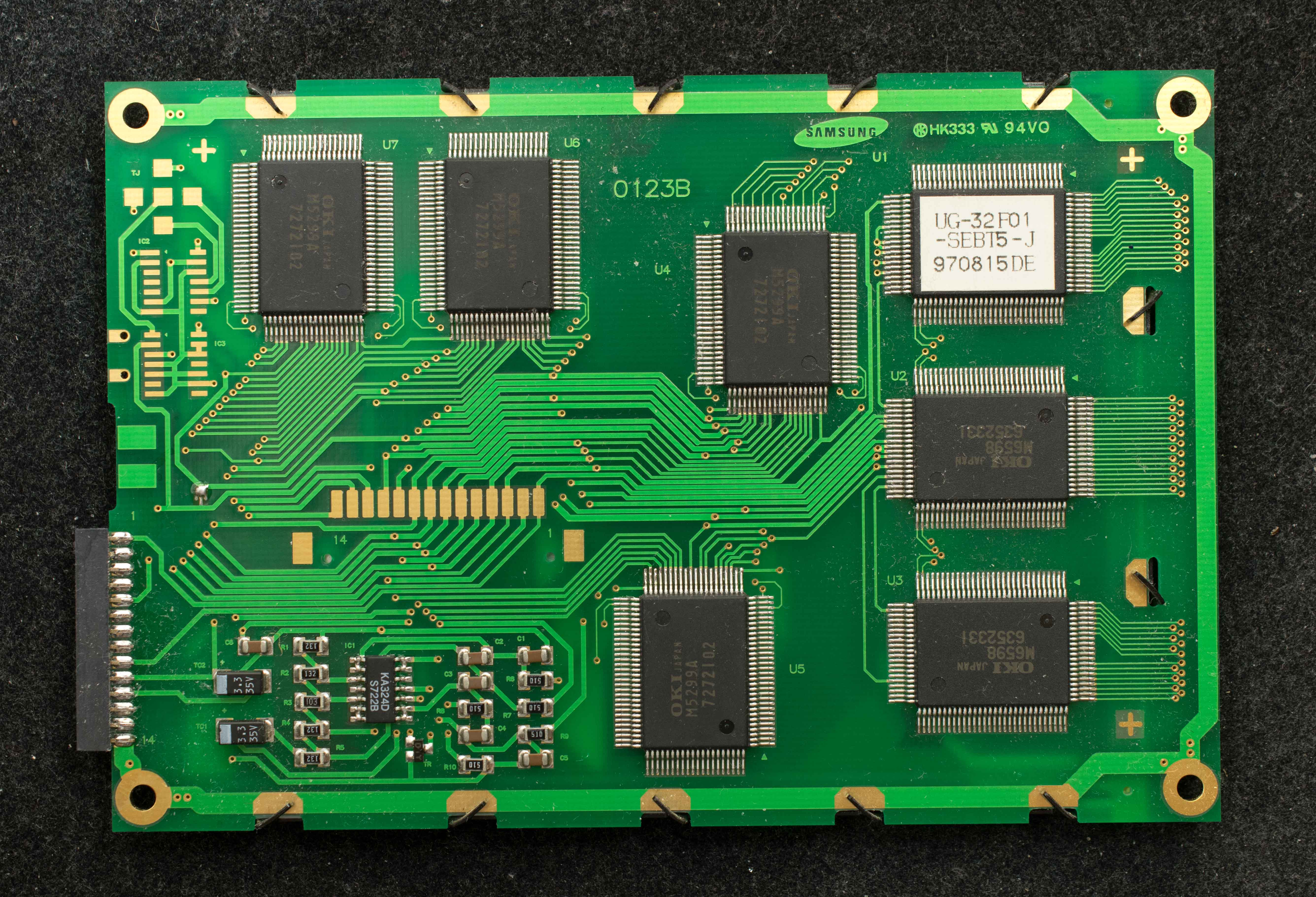

This is picture of the ICs at the back of UG-32F01. They are 4 MSM5299 80-dot segment drivers for 320 dots and 3 MSM6598 80-dot common drivers for 240 rows of 320 dots per row. My limited understanding is collectively they shift data to locations on the screen kinda like raster scan of CRT. It is unclear to me how long the LCD screen retains the data. The datasheet mentions a minimum frame frequency of 70Hz, implying the screen need to be refreshed 70 times a second, minimum? I did find a paper describing UG-32F01 in conjunction with SED1351 graphic controller. That is my best hope of reverse engineering the LCD display, a rather arduous process...
Is that to say you haven't found a datasheet for the panel, only the ICs? (I found datasheets for the ICs, but they didn't have the information you'd need for writing your software, and I have not found a datasheet on the completed LCD module.) I'm pretty sure however that the ICs take care of all the scanning, and I expect that after you've fed it a screen of data, it will maintain it until you write new data to it, and even then, it probably has scrolling functions so for example if you have a screen of text and want to scroll it all up a line and feed it a new line of text at the bottom, you only need to tell it to scroll that far and then give it the new line, not give it all the data again in different positions. That's the way my little 128x64 graphic LCD is. It does not have a controller in the sense of generating characters and so on, so you have to feed it data about which dots to turn on and off; but then it keeps those data indefinitely, until you feed it new data. Your LCD module's ICs might scan the whole LCD 70 times per second, but that does not mean you have to feed it the information 70 times per second. It has its own memory that it scans from.
That's the job of a controller, and this display doesn't have one. It only has the drivers. There's no memory, except for the shift registers that can only hold a single row or column. If you want the display to keep displaying, you have to feed it an entire frame of data every frame. If you don't, it will stop displaying and you risk damaging the LCD.
A bare LCD needs funky waveforms at funky voltages. The drivers provide these, giving the rest of the system a nice digital interface. But that's all they do.

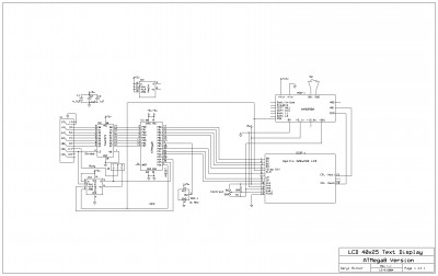

It has the LCD scan controller, as Garth described, but not a higher level controller with built in buffer. I did have to feed pixel data to it similar to a composite video. I actually just modified my ATMega8 composite video display code to refresh the LCD vs. a composite display. It generated the 3 clocks needed and provided the 4 bit data. It included a 8x8 font and the ATMega8 has enough RAM to feed a 40x25 character display. This allows for a serial or parallel connection to a 6522 and and the host only needs to pass updates. The AVR does all the refreshing.
An ATMega1284 has enough RAM to drive 320x240 pixels if you wanted to have graphical capabilities.
Look here. if you want my LCD-specific code, I can provide that.
https://sbc.rictor.org/vid2c.html
Daryl

Your Optrex 320x240 sounds very similar to UG-32F01. It must have a frame pulse to mark the beginning of a frame, line latch pulse to latch a line of 320 dots, and a dot clock that scan in 4-bit of data. There is probably also a display_on and possibly an alternate LCD drive that needs to change polarity every frame. Yes, I love to know the model number of the Optrex and your ATMega code. I actually have designed a Z80-based controller for UG-32F01, but was not able to turn on the display.

Yes; frame, line and bit clocks with 4 bit data. I do not recall having to provide the other signals, but will double-check.
I'll dig up the datasheet for the display and zip up the AVR code later tonight.

Attached Zip has datasheet for Optrex display and the AVR code. it's been a long time and I cannot vouch for the readability of the code. Ask any questions you have and I'll try to refresh on the info and get you an answer.
Also added image of the working schematic.
Daryl

Daryl,
Thank you, this is exactly what I'm looking for. The Apollo module is very close to UG-32F01, the negative bias voltage of -26V is quite a bit more than -16V of UG-32F01; the alternate DC bias required by UG-32F01 is generated internally in Apollo. Your ATmega code should help me find out why I can't get my display to work.
This is my attempt at LCD controller using Z80. Z80 works and I throw a big CPLD at the problem, but still can't get the LCD screen to respond beyond gibberish.
