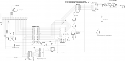

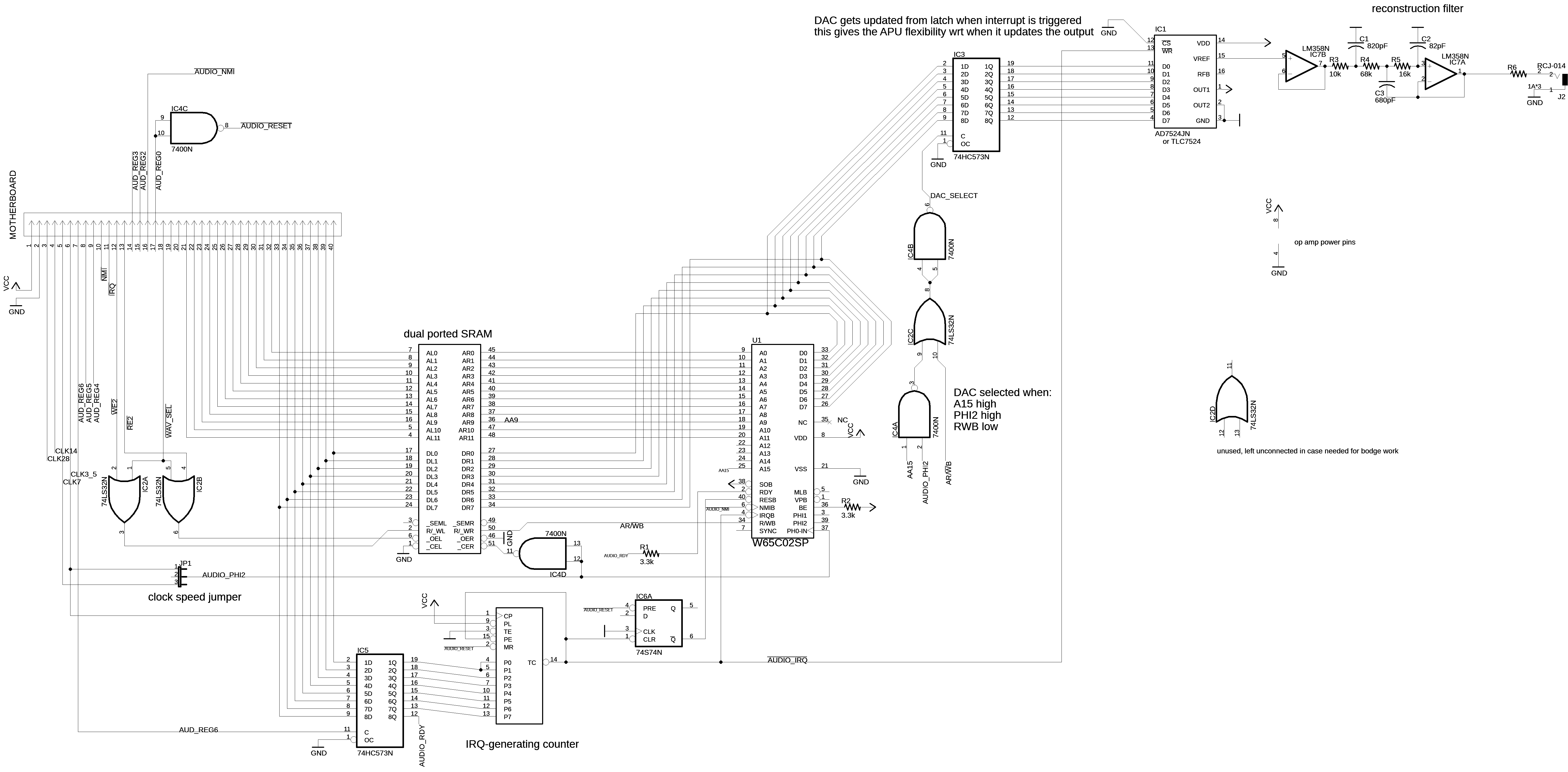

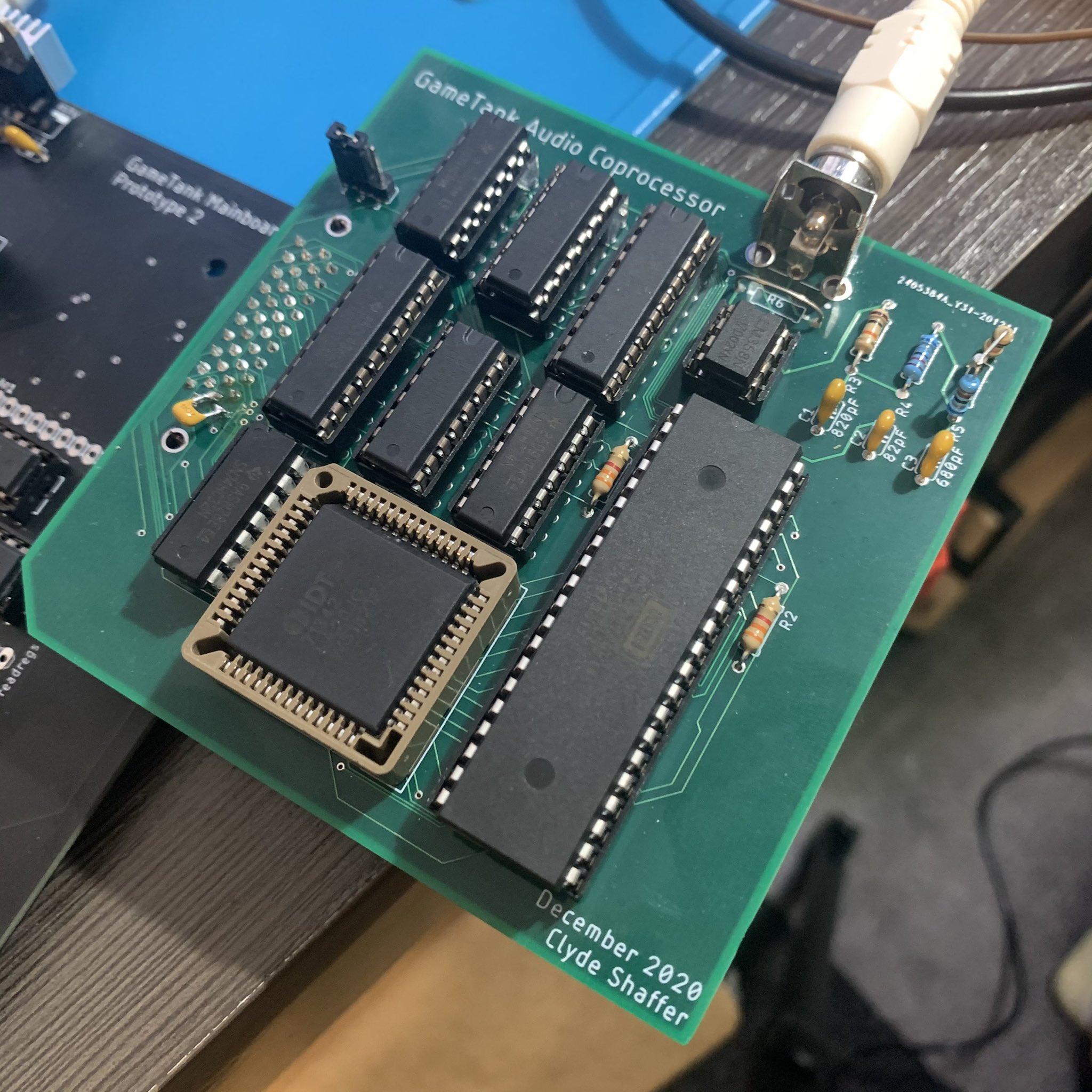

I'd like to share my implementation of a second 6502 processor on a daughterboard for my main project, initialized through dual ported RAM and controlled through memory-mapped RESET, RDY, and NMI.
My own intended purpose for this system is to serve as a sound generator performing direct digital synthesis, which is why it isn't set up for sending interrupts back to the host system.
Partially I chose to use dual-ported RAM over the inverted clock approach because I'm familiar with its usage in my earlier designs, but it's also convenient to be able to run the smaller and simpler system on a faster clock.
The address space is just the dual-port SRAM and the DAC. A programmable counter simultaneously triggers the IRQ handler to compute each audio sample and transfers the previous sample from the buffer latch to the actual DAC.
The host system controls the IRQ rate with 7 bits of an octal latch, while the eighth bit controls the RDY pin.
Setting up and controlling an audio program is relatively straightforward. The coprocessor is halted by setting the RDY bit low. Then the program is copied from ROM into shared RAM, reset is triggered, and the RDY bit is set high.
The IRQ counter also handles holding RST low for enough cycles by triggering a D flip flop. So far it seems that having IRQ go low at the same time as RES going high isn't causing any problems. (Admittedly I hadn't thought about it until writing this description!)
Development workflow is also not very complicated. Audio programs are written in a separate ASM file and .incbin'ed into the main program since they use different address spaces. Zopfli does a pretty good job at compressing the coprocessor binary, to be loaded with zlib6502.
This design could be pretty easily adapted to other kinds of fire-and-forget output interfaces, or with the addition of an IRQ line going back the other way could be used for parallel computation.
It also is quite stable at 14MHz due to its simplicity. I'd designed the host system to run at 3.5MHz because I'm quite lazy, but it seems the timing on this subsystem was a freebie.

Agumander wrote:
I'd like to share my implementation of a second 6502 processor on a daughterboard for my main project...
Implementation note: the SOB input on the 65C02 should be pulled up to Vcc. CMOS inputs should never be floated and in the case of this one, it could randomly affect program logic.
Re: Coprocessor implemented with dual-ported RAM
...the SOB input on the 65C02 should be pulled up to Vcc.
Or did you mean that it should have a pull-up resistor, rather than being connected directly to Vcc? Isn't it an input-only pin?
(I'd agree that having different meanings for bold vs. non-bold arrowheads might not be the clearest notation.)
cjs wrote:
Doesn't the bold arrowhead at the end of the line from SOB indicate that it's connected to Vcc?
All the more reason I should make a custom library symbol for the interface connector.
Dunno. I'm not into non-standard electrical symbology.
In any case, I never tie input directly to Vcc, Using pull-up resistors opens the door to being able to later put the input to use without having to butcher the PCB.
Agumander wrote:
Yes! Sorry for the confusion, the bold arrowhead is indeed Vcc. I followed the advice of the "Mystery Pins" page of the Primer.
Is audio_reg0 an IO port or a select line?
I would make sure the secondary CPU is kept in RESET until released by the host CPU so it doesn't try to run in uninitialized memory.
I have to look up the algorithms again, how do you synchronize the two programs in both CPUs? There is no hardware memory locking, so you have to take care programmatically.
André
P.S. great work!
André
P.S. great work!
IDT71342 is a 4K dual port RAM with 8 semaphores. The semaphore is implemented in hardware to make sure only one side can set the flag much like a software test-and-set instruction. I also have a dual-port based coprocessor, except the coprocessor is Z80 which is held in reset at power up and boot with program in the dual port RAM when commanded by the master processor. https://www.retrobrewcomputers.org/doku ... asmo:dpram
So far I've largely ignored the IDT71342's semaphores. Audio_regX are all select lines. Given that it can only interact with the 4K of SRAM and the DAC output, I didn't deem it too critical to make sure it starts out in RESET on power-on, but it does indeed get kept in RESET when loading programs. Typically in audio coprograms I designate a few zero page addresses as only being written by the main CPU, and use those to send parameters to the coprocessor. Besides that I can manipulate the READY bit or send an NMI if I really need to "ring the doorbell", so to speak.
Most of the time though I avoid disturbing the program flow so as not to introduce sample rate jitter.
