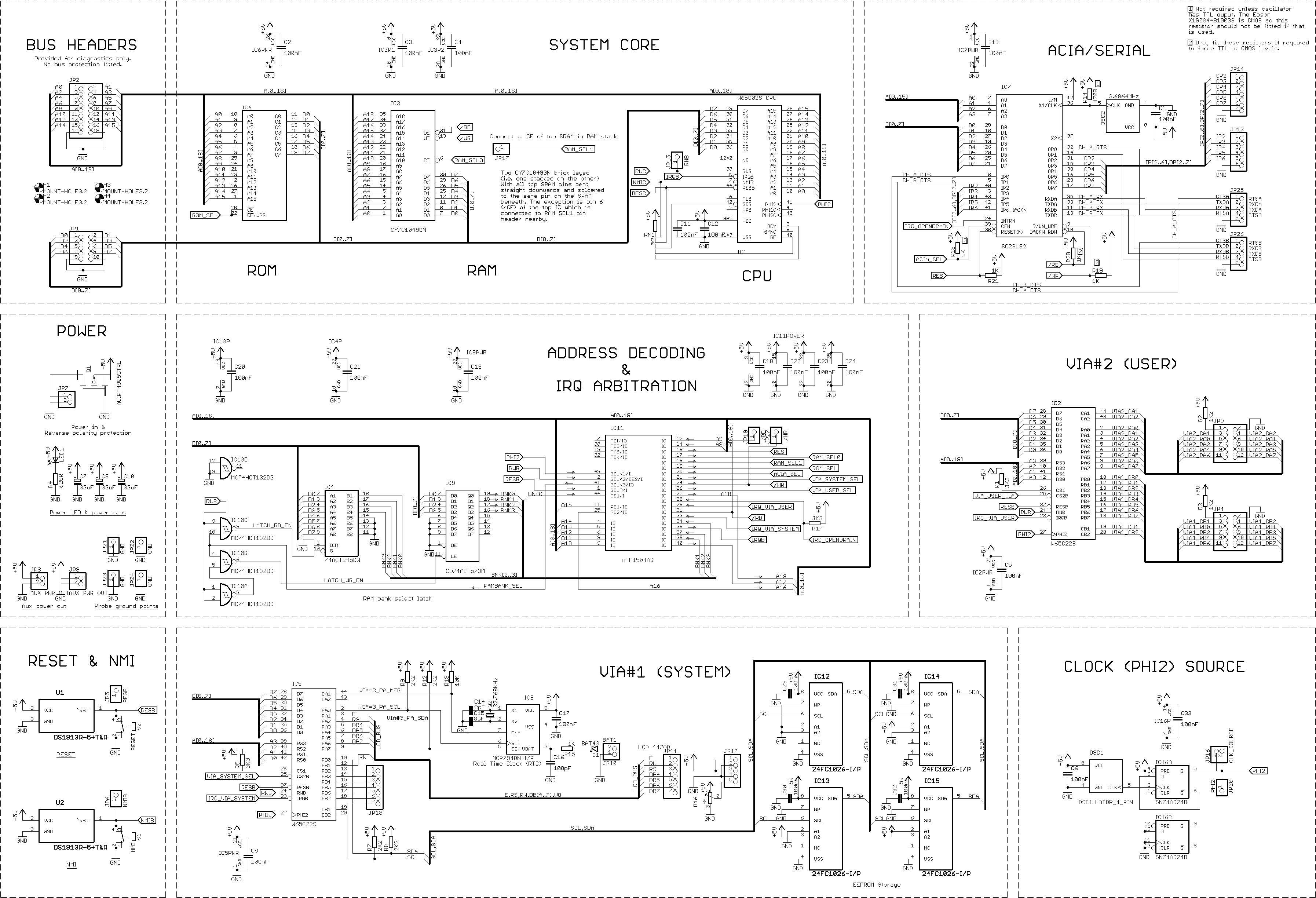

Circuit Diagram:
Please let me know what you think :).

I see an unused section of a 74HCT132. Why not use that to invert the reset signal and thus free up a pin on the CPlD, as well the logic being used?
A good suggestion. I'll make the change and (for now) route the freed pin to a pin header. Cheers!

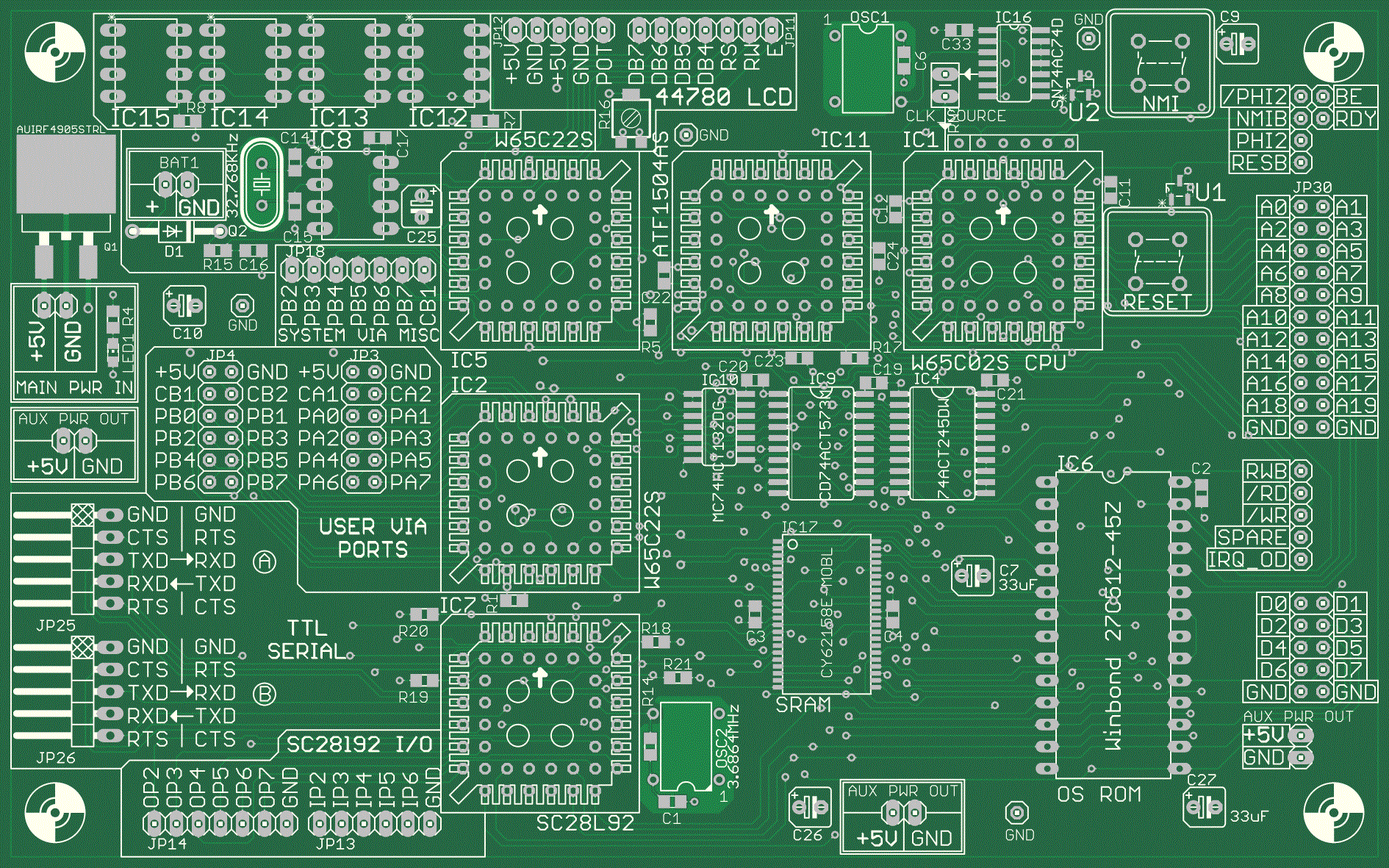

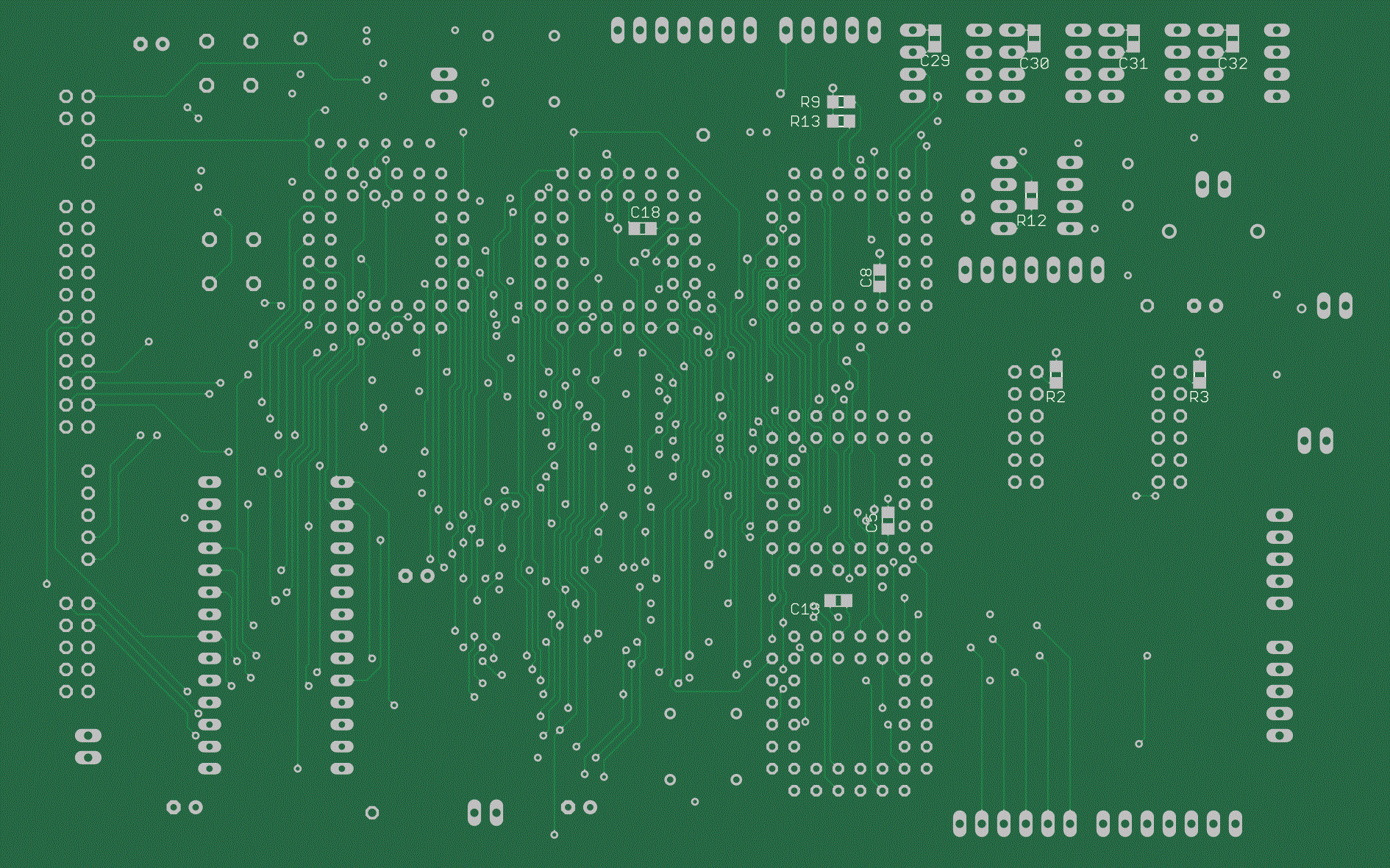

I've got the PCB routed finally. I think I've developed an aversion to routing PLCC ICs :D. Just doing some tidying up, etc. now.
He's a picy of a graphical representaion of the PCB. I'm using EagleCAD (not the Autodesk one) with a PCB limit of 160mm x 100mm so have had to crush everything in a bit:
Top:
Bottom:
One thing which I'd like to implement is video and keyboard. To this end I've routed the following signals (via pin headers) to the right side of the PCB (opposite side of I/O) for potential daughter board(s). Each such daughter board will have pass through headers so more than one can be used:
A0-A19 (65c02 A0-15, A16-19 derived from CPLD used by RAM banking)
D0-D7 (65c02)
NMIB (65c02)
RESB (65c02)
BE (65c02)
RDY (65c02)
PHI2
/PHI2 (inverted version of PHI2)
RWB (65c02)
/RD (active low read, only enabled when PHI2 is high)
/WR (active low write, only enabled when PHI2 is high)
SPARE (spare i/o pin on the decoding/irq CPLD)
IRQ _OD (open drain input to the decoding/irq CPLD)
+5V
GND

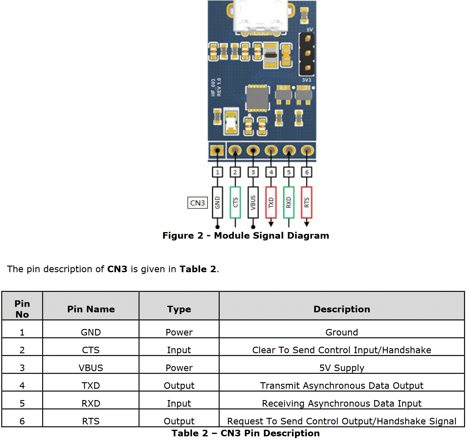

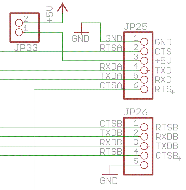

PCB looks good... agreed on routing around PLCC devices. I probably should have mentioned this before, however....
The 5-pin connectors used for your TTL Serial outputs. You might want to use a 6-pin header with a pin-out that matches one of the FTDI USB-to-Serial interfaces. I've used several of these over the years... one that could be useful for your SBC is the LC-234X (datasheet attached). You don't need to use the power pin, but possibly a jumper in case you decide to run the board from USB power.
DS_LC234X.pdf
(570.48 KiB) Downloaded 76 times
Also, have you found some good pass-thru headers/connectors for stacking the I/O board(s)?
banedon
Posts: 742
Joined: 08 Sep 2013
Re: 6502GPD v2.5 design review
Post by banedon »
A good idea. I could probably make a custom cable, but there's no reason not to make things easier at the design stage :).
Here's the redesign. JP26 represents my original pin header and JP25 represents my new one. The pinout from the datasheet you linked can be found beneath:
Header-wise: I have seen a few solutions, but if it really comes down to it I'll use pin header sockets on the underside of the daughterboards and offset pin headers on the top side.

Post by banedon »
And here's the above on the PCB :
