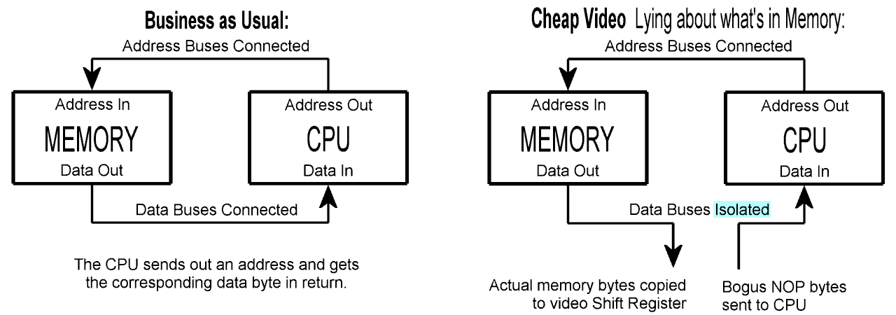

The goal is for the address bus to increment on every clock cycle. NOP consumes 2 cycles but it's only 1 byte. So, a diet of all NOPs would mean the address bus would increment only on alternate clock cycles.

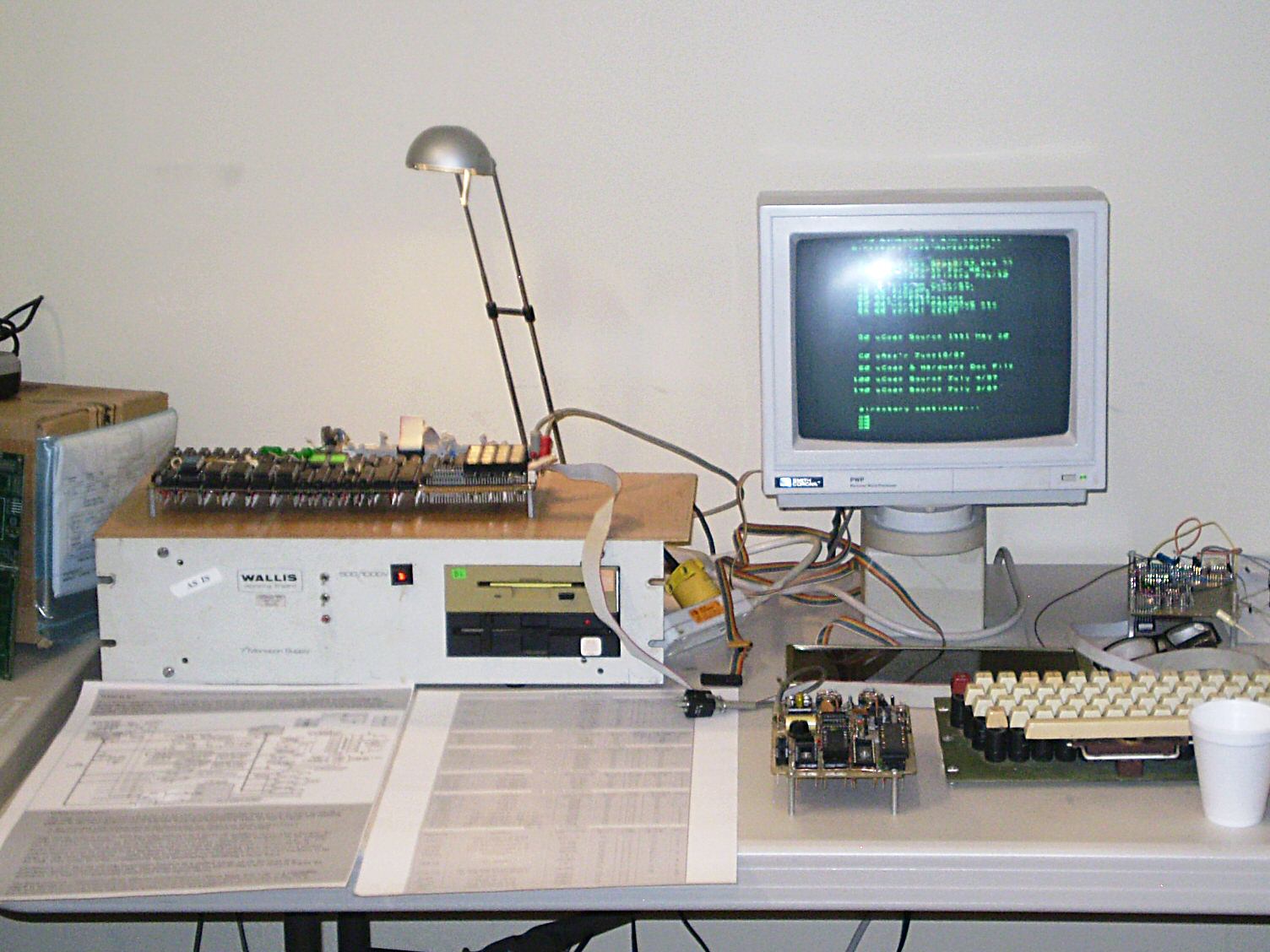

Any photos?
My first Cheap Video machine was my KIM-1, here. Later I attached two 6809's to a single memory array so they each got 50% of the memory cycles, and one of the 6809's was capable of Cheap Video. And the KK Computer is here (below). Close-up photos here. :)

Hm, that sounds like it could be the basis for a workable system. But it wouldn't be Cheap Video, if I'm understanding you properly.
The advantage of Cheap Video is in omitting the Video Controller or DMA controller and instead letting it be the CPU which increments the address bus on every cycle. To get that behavior, the CPU data bus needs to be fetching 2-byte, 2-cycle instructions from somewhere[*] at the rate of one byte every cycle while at the same time and using the same addresses video data is being fetched from RAM at the rate of one byte every cycle. Here's an illustration from my article. If there's anything the article fails to explain adequately I'll be grateful if someone will please ask.
Nowadays we have much faster processors and memory, and it's possible to make a low-end video system that doesn't require one byte of video data to be fetched every cycle. The cycles happen at a much faster rate! But if you want high resolution and/or increased color depth, Cheap Video still bears consideration, and there's still no Video Controller or DMA controller required. :!:
[*]Footnote: traditionally, a tiny ROM (or discrete logic) is the "somewhere" from which the dummy instructions originate. Aliasing causes the image to appear repeatedly in the address space, so a low capacity ROM will suffice, and that'll save money. But nowadays memory is drastically cheaper, and the builder may prefer to have an actual RAM or ROM full of dozens of K's of nothing but $C9 and the occasional $20.
