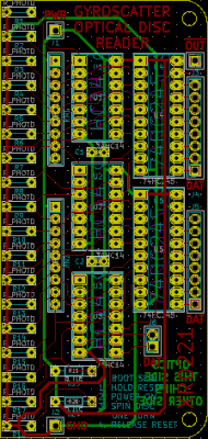

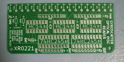

The XR0221 is an untested, prototype circuit for bootstrapping a computer without ROM. I have five in stock and I'll order more if it is popular. No charge for hobbyists.
Newbies may be particularly interested in the growing list of giveaway parts which include my 5V, reversible indicator lights.
