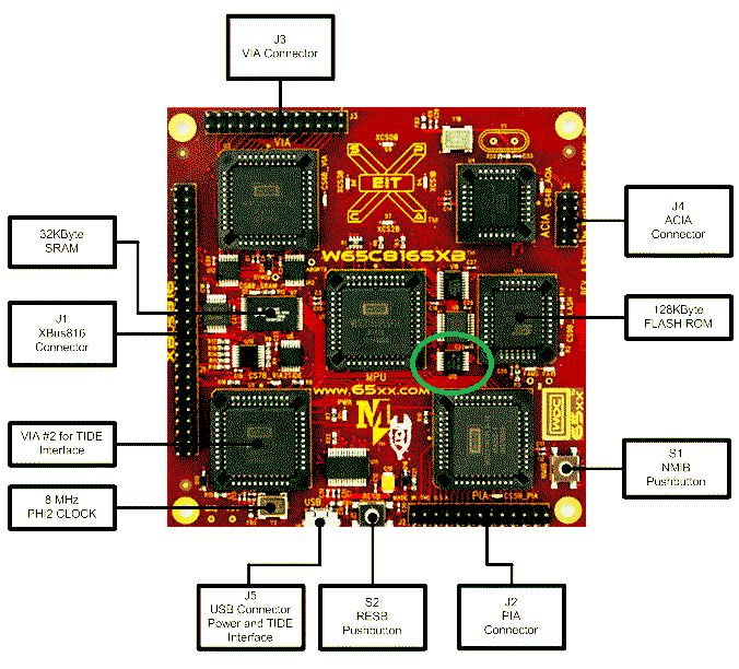

I've recently purchased a W65C816SXB board and have very quickly run into something I wasn't expecting.
When I try to LDA from address $01:0000 or higher the debugger says I've hit a BRK and moves my PC elsewhere, to a block of seemingly random bytes outside the range of my code. The first three lines of my code are this:
	clc
	xce
	lda	>$10000
If I STA instead of LDA the debugger happily moves to the next instruction.
There is nothing connected to the board apart from USB.
I've read elsewhere here that "The 816SXB resets when you access unimplemented memory areas". I've looked over the schematic on the WDC site and can't see anything obvious in it that might cause that to happen. I've also disassembled the internal ROM and can't see anything in that either, so I'm thinking it has to be a hardware issue. I'm sure I've missed something in either the schematic or CPU datasheet (or both), so I'm wondering:

I mentioned this to WDC and they have looked into it. The problem is that the 8 input NOR gate (U15 CD4078B) they use to detect bank 0 is too slow (~150nS).
When memory accesses change bank the signal updates too slowly for the memory chips to be correctly selected so the CPU is effectively fed a random instruction when it tries to read an instruction from bank 0 following a read or write to another bank. I suspect that it often reads a BRK instead of the real instruction.
If you only ever access bank 0 then the state of the gate never changes and rest of the address decoding works within the timing limits.

BitWise
In Memoriam
Posts: 996
Joined: 02 Mar 2004
Location: Berkshire, UK
Re: W65C816SXB behaving strangely on access to memory above
Post by BitWise »
WDCs board uses a tiny TSSOP package -- Its the one in the green ring.
I don't think many people have ever designed an XBUS extension for SXB boards or this problem would have been found years ago. My memory expansion for the 265SXB doesn't have this problem as the chip provides the extra address lines and chip selects directly without any extra glue logic.
