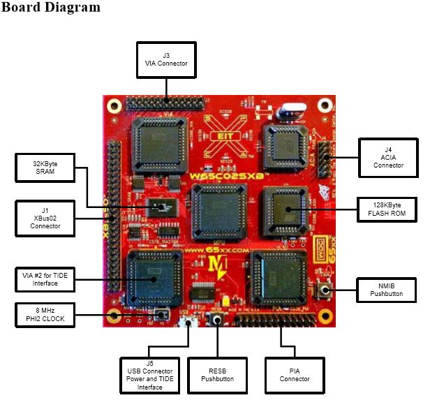

I just bought a W65C02SXB board from WDC. Looked like a modern and well built piece of kit...
Can't say that of the software IMO. Infact I was thinking it was abandon ware as the tools are woeful - at least to my unsuspecting eyes. Also the documentation seems out of kilter with what is available to d/l.
I guess the question is - is their an alternative assembler/monitor that will work in with this board in order to single step through some code? I don't really have a full appreciation of what is involved and I apologise if I have failed to appreciate the shortcomings.

The '02 and '816 SXBs only have minimal firmware that interfaces with WDC's debugger rather than a full monitor like the '134 and '265. I wrote a simple monitor for the '816 but have not yet ported my SXB-Hacker program to the '02 yet.
I have a .Net program that can download S28 files into an SXB and run them but its not been tested on the '02 only the '816 and '165. I use my own assembler to build applications and download them. Someone else on this forum published a python script that can download and run code as well based on reverse engineering the communications protocol.
WDC's tools have issues. I've been working with them to fix some of them. I not being paid so I work on it when I have time. I have managed to build example programs for the '165 (the '02 on an FPGA) with my fixed version of their C compiler but the library is not complete yet.
What kind of tools are you looking for and what operating systems do you want to run them on?

Andrew is surely one of the best-placed to help you. Unfortunately, for all that we're great fans of the 6502 here, WDC leave a lot to be desired. But on the face of it, this board should be quite promising:
(Image from an Instructables tutorial.)

I've written a Java version of my SXB uploading tool and added to to my Dev65 toolkit. This repository ...
https://github.com/andrew-jacobs/w65c02sxb-monitor
... contains everything you need to assemble, download and run a program on a W65C02SXB and contains the ported code of my SB-65C02 monitor as an example.
I've tested it on Windows 10 and Ubuntu Linux 20.04 (running in VirtualBox). It should work on MacOS and Raspberry Pi but I don't have them to hand for testing.
