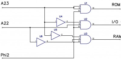

Edit:
Would something like this work for the glue? Outputs going to the chip selects
You would have 2 inverters left over.

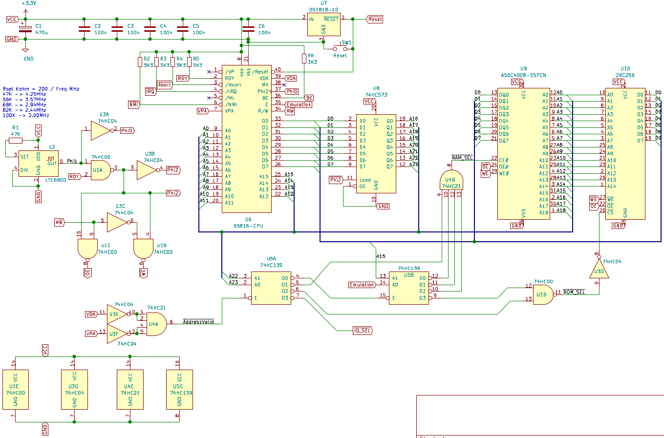

I think I now have a core design (no I/O devices, just a select line for them) which interfaces to an '816 "properly" using 8 ICs:
1: The CPU itself.
2: a 512Kx8 SRAM
3: a 32Kx8 EEPROM
4: a '573 transparent latch
5: a '138 decoder
6: quad NAND
7: quad AND
8: hex inverter (of which one unit spare)
To this, add a reset controller (I'm using a DS1818-10 plus a manual reset button) and an oscillator (here an LTC6900 set to an unambitious 4.25MHz, but a crystal can would also work), and the usual array of resistors and capacitors. The components are chosen to be capable of operating within spec at 3.3V, and to at least tolerate 5V without damage. Clock speeds will primarily be limited by the 200ns addressing latency of the EEPROM, given that wait-states are not implemented (but provided for).
In native mode, RAM fills the first $80 banks, mirrored; in the other banks, the ROM is mirrored in the upper half and the I/O in the lower half of each bank. In emulation mode, to facilitate bootstrap, the ROM replaces the upper half of each bank of RAM and (for reasons of gate shortage) does not appear in the upper banks. The reset handler will be expected to move itself into accessible RAM, enable native mode, then copy the ROM back into its original position which is now RAM.
My design is a bit more than minimal, in that it's designed to allow a novice builder to extend the functionality without immediately having to redesign parts of the core to account for corner cases. Address selects are properly qualified by VDA/VPA (so there are no concerns about stray accesses during dead cycles, and all devices are deselected during WAI), and the bank latch is properly qualified by RDY (so wait-states can be added to improve performance, especially given the slow EEPROM I found to work at 3.3V LVCMOS). It should therefore be easy to add a choice of I/O peripherals - such as a UART.
One advantage of designing for 3.3V is that a UART capable of operating at that voltage would be able to interface directly with a Raspberry Pi without level shifters. I'm sure many would find that convenient. But it does mean that the EEPROM and the oscillator are surface-mount parts requiring more care in soldering. The EEPROM can be reprogrammed in situ since I've connected the /WE line, but it might be prudent to solder it to a PDIP carrier board so that it can be transferred to a normal programmer in case of inevitable bugs and fat-fingering.
Diagrams to come later…

It occurs to me that I could try using a dual 2-to-4 decoder instead of the '138 I currently have. Time to go digging in the datasheets again…
…ah yes. Substitute the '138 for a '139, and the quad 2-AND for a dual 4-AND, and we end up with a much cleaner memory map (albeit with no spare gates left over).
The first half of the '139 selects on A22/23, dividing the address space into generous 4MB chunks, and is gated by (VDA | VPA). The upper three map directly to RAM, ROM and I/O in ascending order. This arrangement allows accessing the whole RAM chip in any mode, via long addressing, and also gives a way to read and update the EEPROM from native mode. Putting I/O in high banks offers the simplest decoding strategy for an '816.
The second half of the '139 is gated by the lowest selector from the first half, and selects on A15 and E. When both are high, the ROM is selected. The other three selectors from this half go to the RAM. Hence the upper half of Bank 0 (and of every bank up to $3F inclusive) is mapped to the ROM in Emulation mode, and to RAM in Native mode, while the lower half of these banks is always RAM.
This does involve a fairly long maximum gate chain in the decoding logic. It starts with inverting VDA and VPA to feed an AND gate (effectively an active-low OR gate), which gates the first half of the '139, which in turn gates the second half of itself, then finally the ROM selects are driven through a NAND and an inverter. And the ROM is already the slowest device in the system. Clearly there are advantages to using a GAL here, though it does require that the builder have access to a reliable GAL programmer.
PostPosted: Fri Sep 18, 2020 7:58 pm
I promised diagrams, so…
