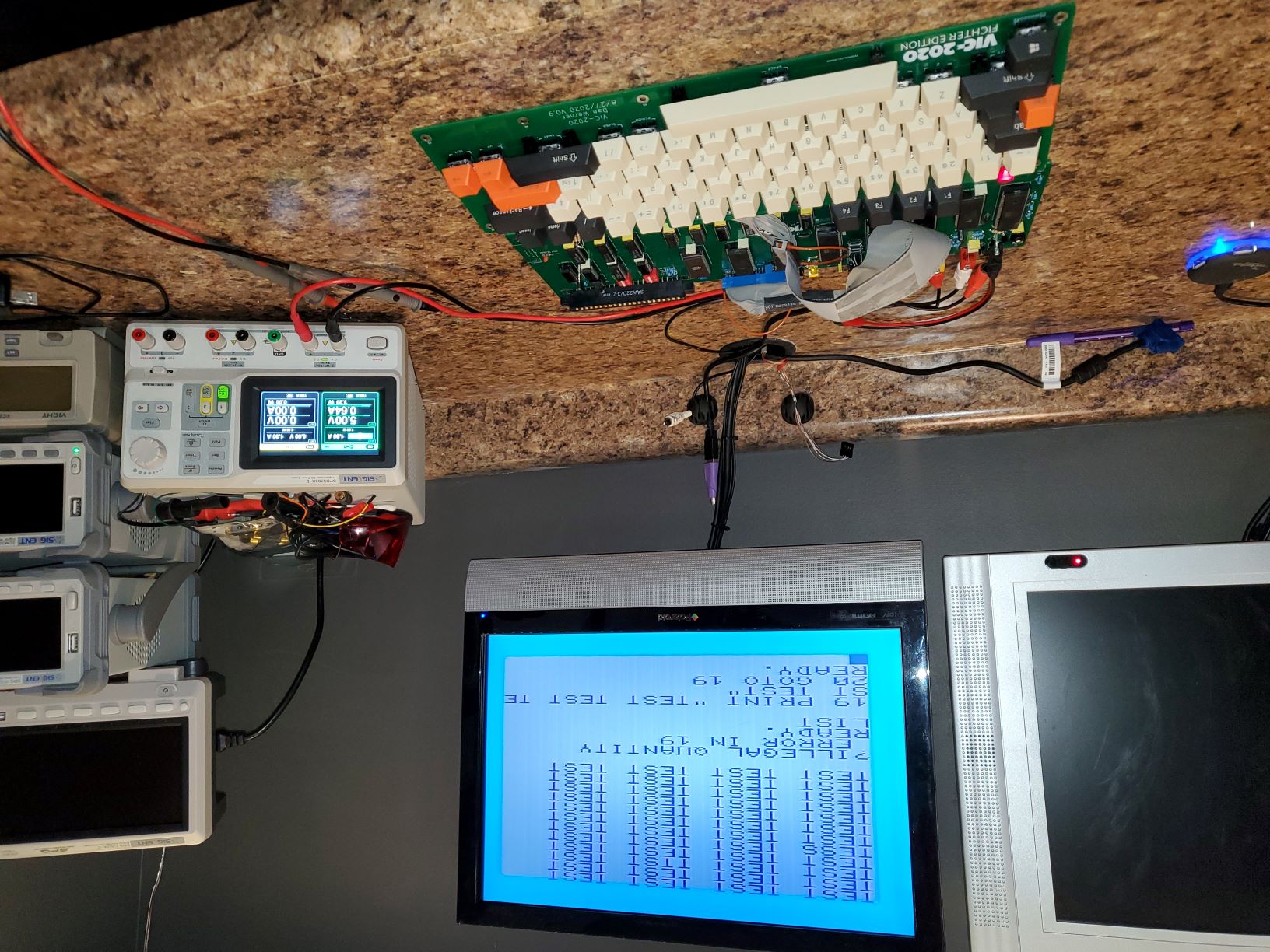

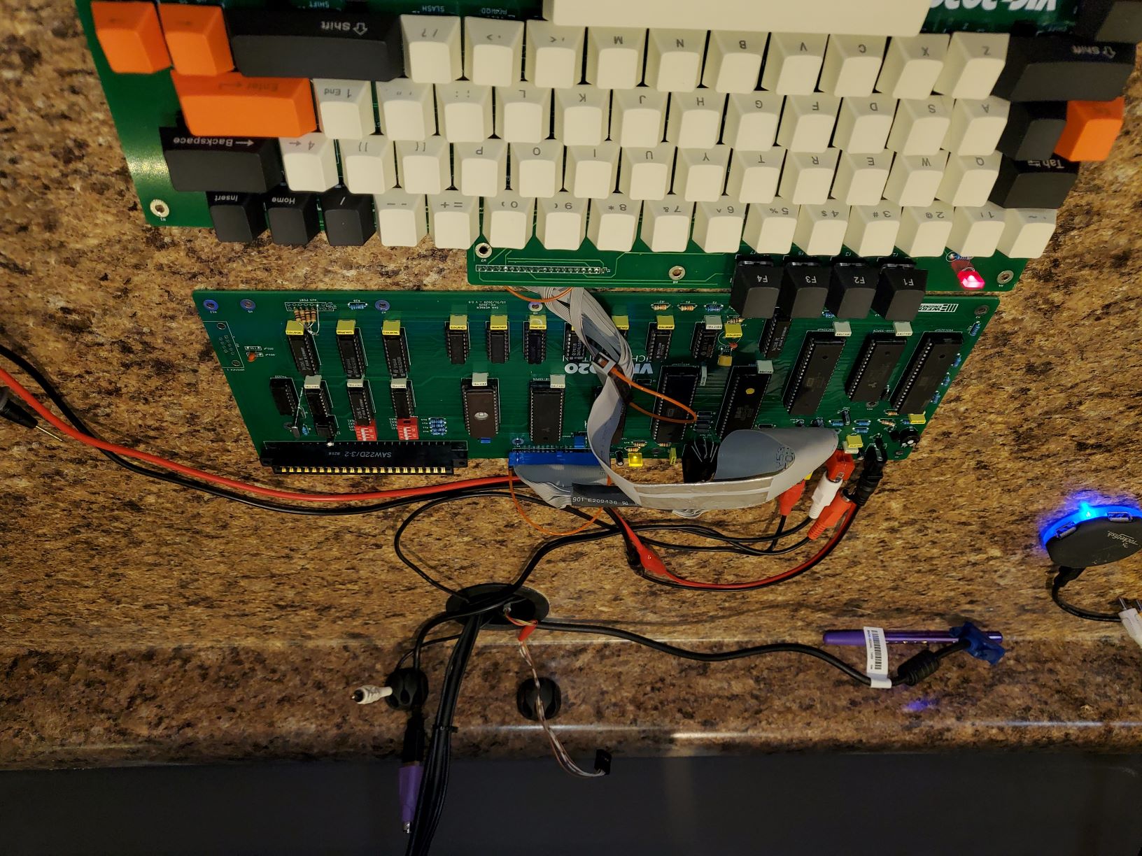

I have made some progress on the VIC-20 clone. All is well, except I have some kind of timing problem. I notice it most when the screen is scrolling -- it appears that when the CPU is in a tight loop it has occasional read problems. See the pic of the screen shot. The Basic program prints "TEST TEST TEST TEST" in a loop and it is possible to see the corruption as it scrolls up the screen. Note the bottom line always is correct, and it corrupts as it scrolls up. I have done several other tests and I am pretty sure (not 100% though) that the problem is on read, not write.
I am working though this but, if anyone has any ideas about what I missed here it would be appreciated!!
See attached pictures and schematic.
vic2020Schematic.pdf [632.81 KiB]
Downloaded 70 times

I finally found the problem (at least it seems to be solved). . .
Looks like CE was getting asserted too soon on U12. To fix it, I changed S02 to be just CPU02 and not an OR of SO0 and CPU02, and I added a gate to introduce some delay after U9D. It has been running for several hours with no issues.
(See new schematic -- attached)
I have ordered new PCBs to confirm that it is totally fixed, and I found a company that prints custom key caps, so I ordered a set of petscii keycaps to finish it off. Assuming that everything passes the tests, I will post all of the gerbers and the keycap templates in case anyone else is interested in building one.
