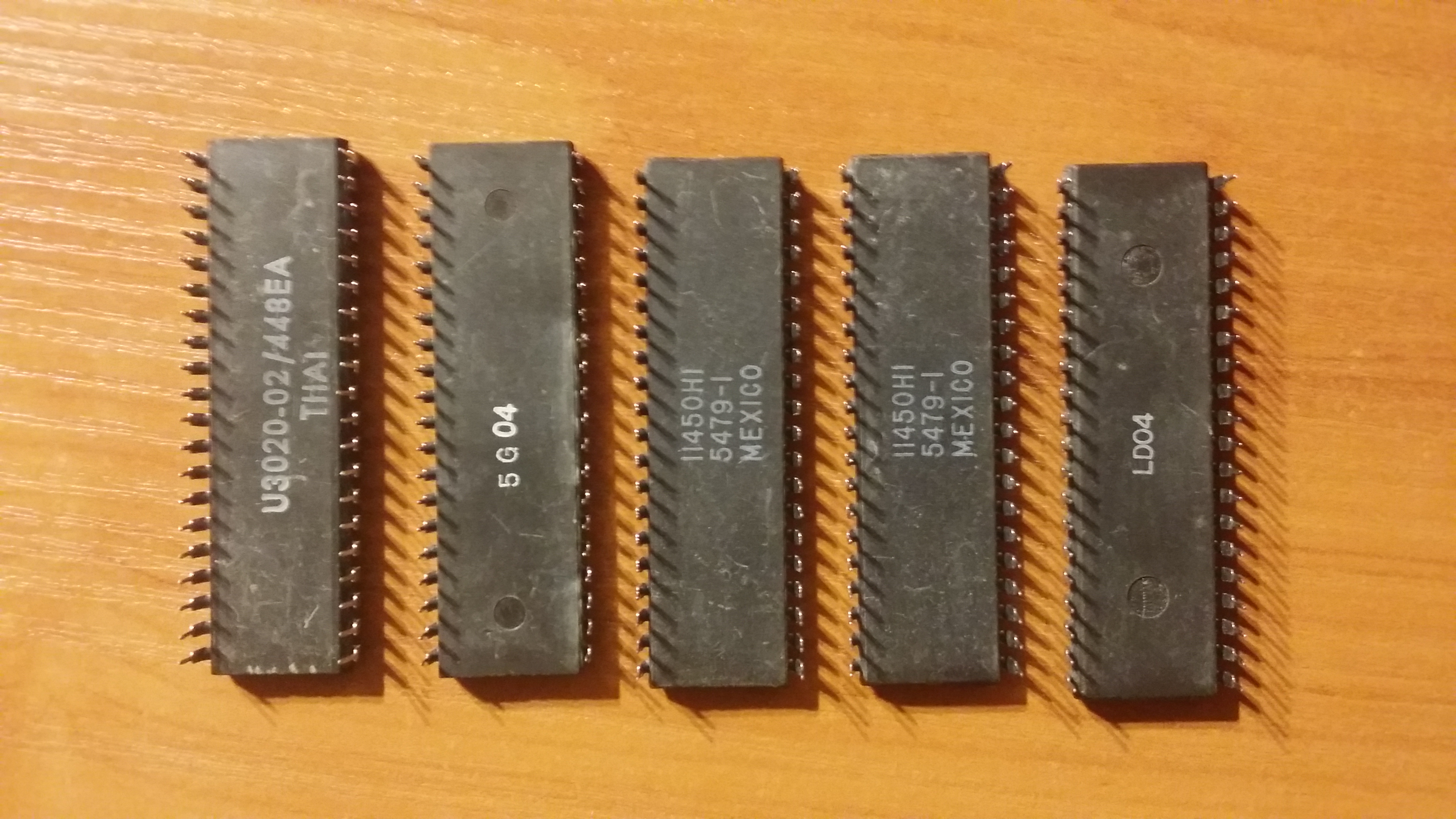

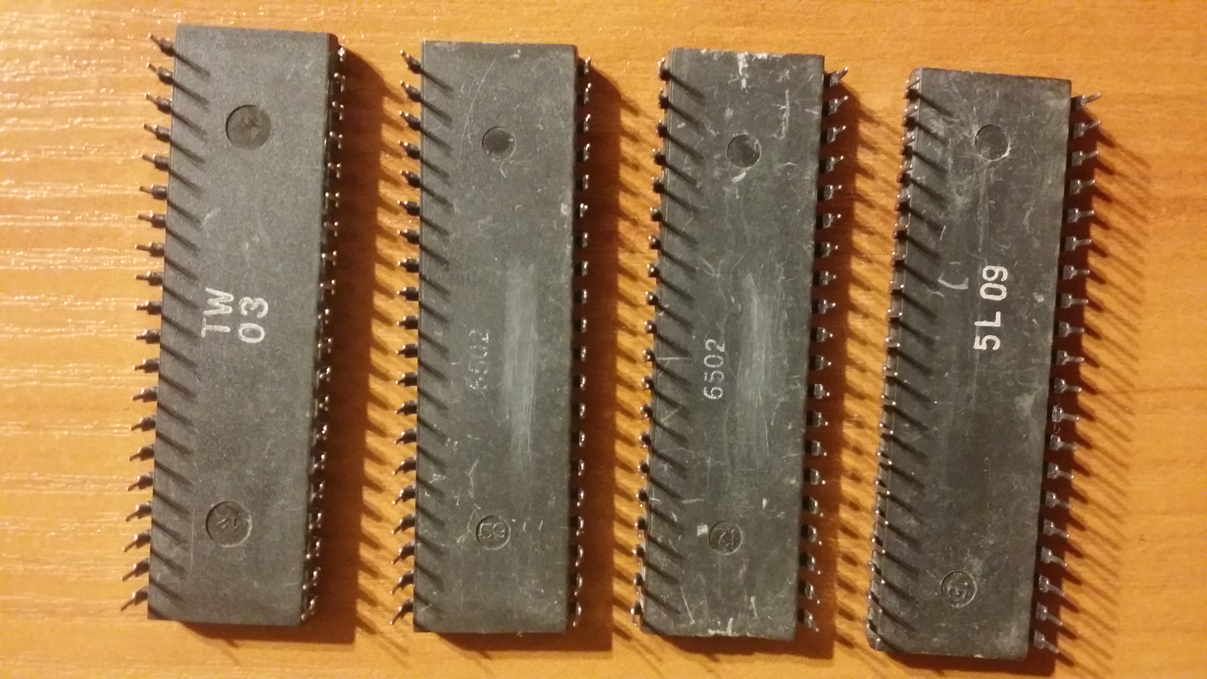

Looking at the underside of the chip will also give you clues as to what they really are. Quite often there will be a manufacture location, or printed text that can be matched to known devices.
Can you telle me something about them? I was unable to Google anything. And yes, I am aware of broken pin in one of them. ;)

The two marked MEXICO could be Rockwell parts. This doesn't necessarily mean they're vanilla 6502s, or even any kind of 6502 at all, but Rockwell parts have a good reputation.
Curious that two others actually have "6502" printed on the bottom, with another row of text crudely scraped off. These two also have consistent package moulding with each other, so that's probably from the original factory.
Another matching pair are the ones marked "5L09" and "5G04", which would be empty-stock movement headcodes on the British railway.
That leaves "LD04", "TW03", and the one with the long string of text as oddballs within this collection. The latter is the most likely to be traceable with some precision, given the right reference.

I've seen the U3020 marking on re-marked chips before. It's apparently signifies a Synertek SYU6502, which is 1mhz NMOS I believe.
I tested the rest of the chips in my WDC65C02 board. They also didn't work.
Did Rockwell produced some other 6502 CPUs, with slightly different pinouts/application schematic. If I remember correctly R65C02 supposed to be a drop-in replacement for standard for NMOS 6502.
BTW the single working chip also has "MEXICO" designation. It is "R6502F MEXICO 1738".

R6502F is not a real Rockwell part number: http://www.cpu-world.com/info/id/Rockwell-identification.html You could run my little software routine, over in the Programming section, to find out whether it's really an NMOS or CMOS part.
I do suspect you've ended up with damaged parts that were, once upon a time, working 6502s. A non-6502 with the right number of pins would probably exhibit a short-circuit through an ESD protection diode structure or a CMOS latch-up path, and thus get very hot very quickly when powered up as one. But there's also an outside possibility you've got an NMOS 6512 or two in there, requiring a Phi1 input and a BE pin pull-up which you aren't providing. Or a 65C102 which has different clock characteristics, so won't interface correctly with a system that assumes a standard 6502 clock arrangement.

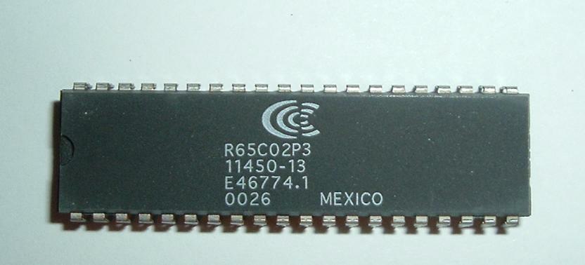

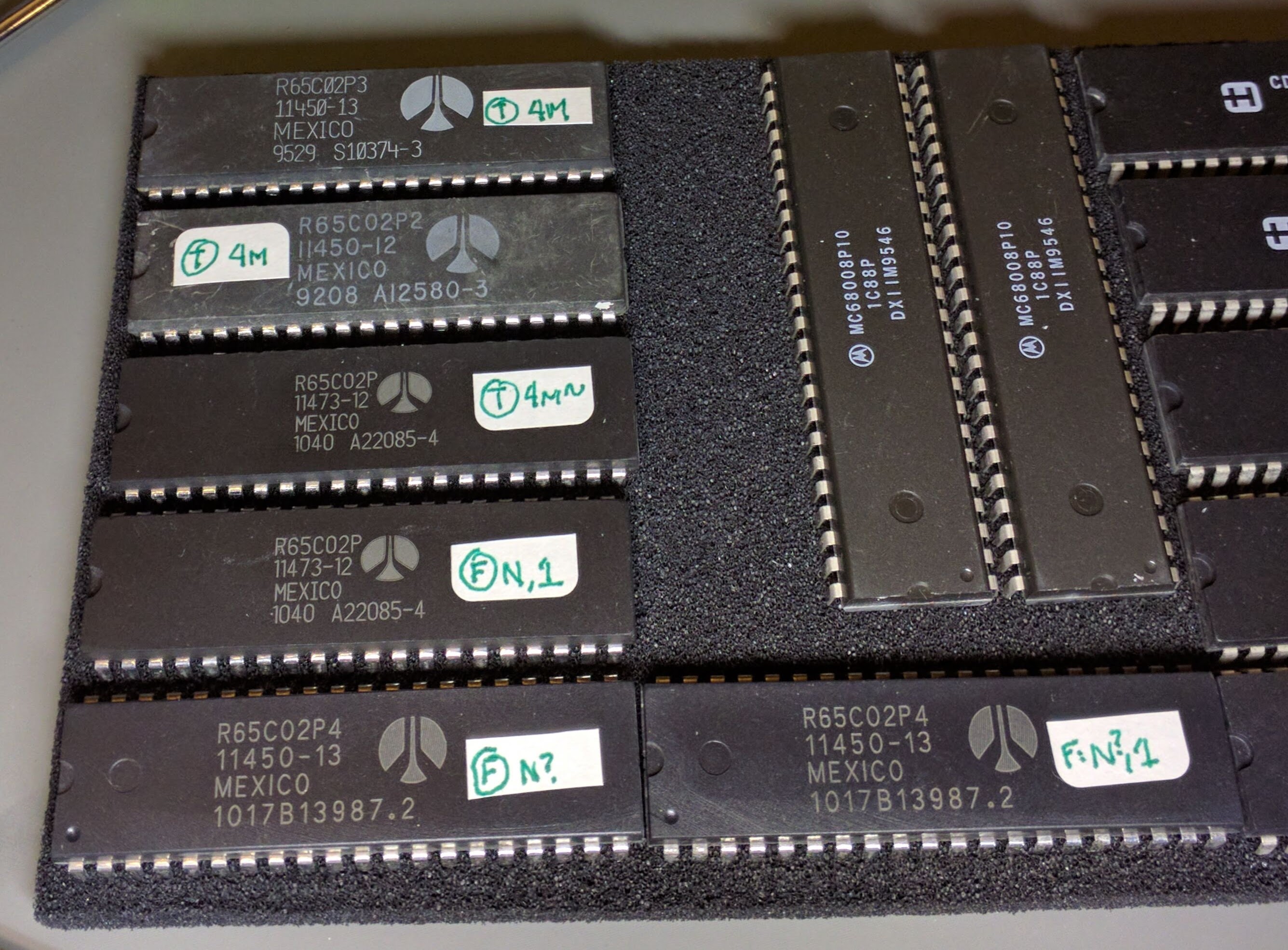

According to BDD:
In 1999, Rockwell Semiconductor was spun off into Conexant and MPUs with the Rockwell mark were no longer produced. Ergo any Rockwell 65C02 with a date code later than 1999 IS A FAKE. Conexant itself was bought out in 2017—65C02 production had ceased well before then. I've not seen a Conexant 65C02 in the flesh.
I had wondered if Conexant had perhaps continued manufacturing parts with the Rockwell markings, but a image search immediately turned up an R65C02P3 with Conexant logo and 0026 date code, so I'm inclined to believe that seeing a Rockwell name/logo with a later date code is indeed a reliable way of identifying a remarked chip.
But remember, remarked does not mean the chip isn't the exact model it says on the label, or possibly even a better one. As you can see from the testing I mentioned above, I have three "R65C02P" or better CPUs (marked "T" in the image below), that all have CMOS-level power draws and run a NOP test at 4 MHz with reasonable waveforms; it looks like two are probably the original marking and the other has been remarked with the exact same markings as the NMOS part immediately below it. I expect they just throw everything into a bin and remark it all, regardless of whether that's helpful or harmful.
I should mention that the "4" and "1" markings on my labels just indicate whether my NOP tests saw large or little waveform degradation as I changed the clock through 1, 2 and 4 MHz; that should be taken only as the "1"s will almost certainly not run reliably at 4 MHz, not that the "4"s will.

Okay, on the MEXICO chips, the code 11450 seems to be an internal Rockwell designator for the 65C02. The corresponding 65C102 code is 11451. An NMOS part would carry R6502 here. So those appear to be genuine, just non-functional.
The suffix may indicate a die revision or a speed bin; H1 without a dash doesn't match any top-printed examples I can find, while pictures of the underside are rarer. Earlier Rockwell parts don't have the internal code printed on top, so yours may be examples from that period.

BillO wrote:
Not to dis BDD, but Conexant sold it's Rockwell IP and the Mexico fabrication plant to NXP in 2008. However, the deal did not go through until August of the year. This is all very confusing. We have no proof that 65C02s were not manufactured under the Rockwell brand, either by Conexant or by NXP, after the Rockwell name and logo went up for grabs. It's all just speculation.
Right. I point out the sale to Conexant and my discovery of a Conexant-marked R65C02P3 not to say that BDD is absolutely correct there, but to say I've found a bit of independent evidence that adds some plausibility to his claim.
And I can also see why vendors might remark parts just to change the manufacturer name; of three major forms of the 6502 (NMOS, R65C02 and W65C02) Rockwell seems the best-known brand name for R65C02s (I'd never even heard of Conexant before these threads in this forum) and it could well be that many beginners have a strong preference to buy "Rockwell" parts over others.
