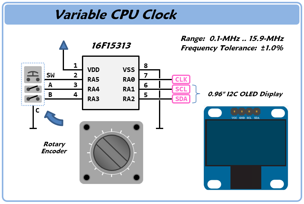

Here's one of many different ways you might implement a relatively simple variable clock source by taking advantage of the 20-bit NCO with 20-bit increment register in some of the more recent PIC microcontrollers.
