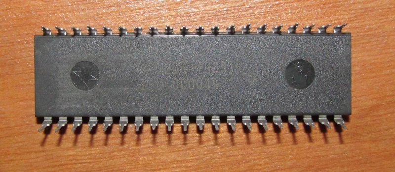

I purchased five of this ICs off eBay. This is what arrived: Manufacturing date 2019. On the top, Mexico, on the bottom, Taiwan and a handful of scratches.
I wouldn't mind much if they worked. I hooked them up on a breadboard, providing power (5V) and tying reset, IRQ, NMI and SO high by 1K resistors. 1 Mhz clock courtesy of my function generator and later by a crystal. Data bus set to EA by 1k resistors. Power consumption is about 30 mA.
This is what I'm observing on all ICs:
-Current raises to 250 mA when reset pin is grounded.
-No clock output on PHI1 and PHI2
-No activity on address or data bus. (I cached some on one specific address pin at one time, but gone after reset).
-Some address lines are high, others low and others sit in between.
I'm pretty sure they are dead. But that the same symptoms appear on all five makes me suspect that my setup is wrong. Any ideas?

They could be a completely different chip, relabelled. If your time is precious, or your money, I'd recommend you reject them and get a refund.
But of course if you are curious, you might wonder what they really are.

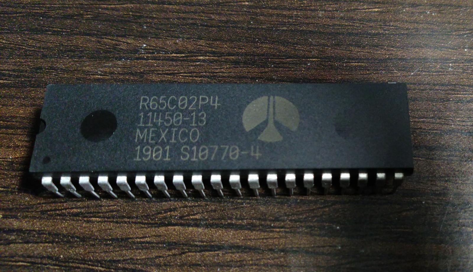

I ordered and received 5 very similar marked chips in late 2018. They arrived with 2019 date codes. All 5 chips seem to be nmos 6502 relabelled as cmos parts.

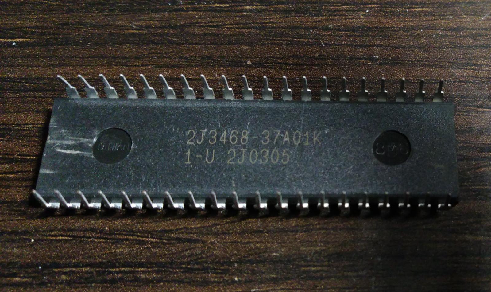

I check some of the 40 pin chips I've acquired over the years, those reverse markings look a lot like those on an Atmel AT89C51 micro controller.
Not a great photo I'm afraid
No a great photo, but hopefully you'll be able to see the similarity of the font, and the format of the text. which on my chip is 0C3206-19651L on the top row and 1-U 0C0045 on the lower

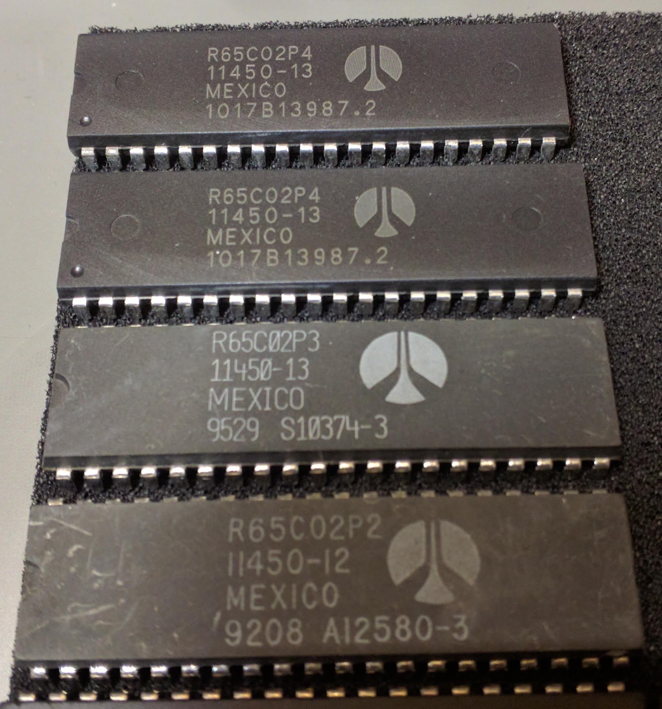

In case it helps, here's a photo of a couple of P4s, a P3 and a P2 I bought last year.
Looks like the fakers are imitating the old '90s printing instead of using the new 21st century font?
None of my Rockwell chips (I have a couple of Ps, as well) have any markings on the bottom.

It looks like the top of the chip has been sanded to remove the original markings, then printed with the Rockwell bits. Needless to say, I think they're just selling junk parts with markings for whatever they think they can sell.
