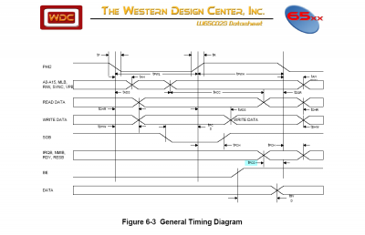

I'm experimenting with some other ways for my Ruby 6502/816 to communicate with the ATmega host and am seeing some weird issues.
The scenario is that the 65C02/816 is running and I pull Rdy low. The CPU naturally stops running, but when I let Rdy go high (drive it high) it sometimes doesn't carry on from where it left off. This appears to be random. I don't currently have the tools to find out where or what it is doing, however if I send the 65C02 an NMI, it correctly executes the NMI code when it's in this tate. I can send it 1000's of NMIs once the main program has stalled (or gone awry) and it processes the NMIs correctly (or as correctly as I can tell from a bunch of LEDs)
Have I missed something crucial about pulling Rdy low? It's not being synchronised (by me) to any particular timing in relation to the clock (I'm not aware it has to be) and I'm not doing anything else other than pull Rdy low - wait a millisecond or 2, then take it high again.
Rdy works the other way just fine - execute a WAI instruction and Rdy goes low, the 65C02 halts and I can kick it back into life by sending it an IRQ.

Pretty sure RDY is a synchronous input - unlike interrupts, you will need to sync it.

PostPosted: Fri Dec 06, 2019 9:02 pm
The important thing (I would think) is never to change RDY too close to the crucial end of phi2. Will conditioning it with SYNC achieve that?
PostPosted: Fri Dec 06, 2019 9:05 pm
Hmm, a WDC datasheet suggests we also do need to condition the interrupt and reset inputs...
See table 6-3 and figure 6-3 near page 40 of

PostPosted: Fri Dec 06, 2019 9:37 pm
I checked an old Rockwell datasheet and it makes no sense to me: there's a hold time in the diagram, it's labelled as a setup time, and there's no other half to the story. (Even if setup time is zero I'd expect it to be labelled.)
PostPosted: Fri Dec 06, 2019 9:42 pm
I see you've just posted again while I was typing this, Ed. But your earlier post seems to be right on the money. :)
That makes sense, and indeed the tPCS spec says you need to allow at least 10 ns before the end of phi2 (assuming 5V operation).
One solution would be a flipflop, clocked by the rising edge of Phi2, to condition the incoming signal before it's applied to RDY.

PostPosted: Fri Dec 06, 2019 10:47 pm
Unlike interrupts, yes -- and that's where the doc seems excessively cautious (in that it applies the tPCS and tPCH restrictions not just to the RDY input but also to the interrupt inputs). Arguably that caution is warranted in a critical setting such as life-support, but for anything less demanding I think it's reasonable for the interrupt inputs to be exempted from the tPCS and tPCH restrictions.
The CPU designers (quite reasonably) anticipated that interrupts may arrive from unsynchronized sources (such as a human typing on a keyboard) and they accordingly included synchronizing flipflops internally on-chip. Because synchronizers are provided the chance of a failure due to ignoring the restrictions is vanishingly small. Gordon's experience (and that of others) supports this assertion.
RDY, on the other hand, is typically driven by a memory decoder, not by some unknown and unsynchronized source outside the microcomputer. Because it'd be unnecessary -- indeed, counterproductive -- no internal synchronizer is provided for RDY. Thus in the RDY context violations of tPCS and tPCH are a far more serious concern.
I think you'll find this solution effective. But it's not rigorous -- there's a great deal more that can be said. Briefly, the technology for a 100% reliable synchronizer doesn't exist. See these documents pertaining to metastability.
When you violate the setup-and-hold times on a flip-flop, the output might erratically go high, stay low, or pop one way and then back again. EDN 3/16/2000
