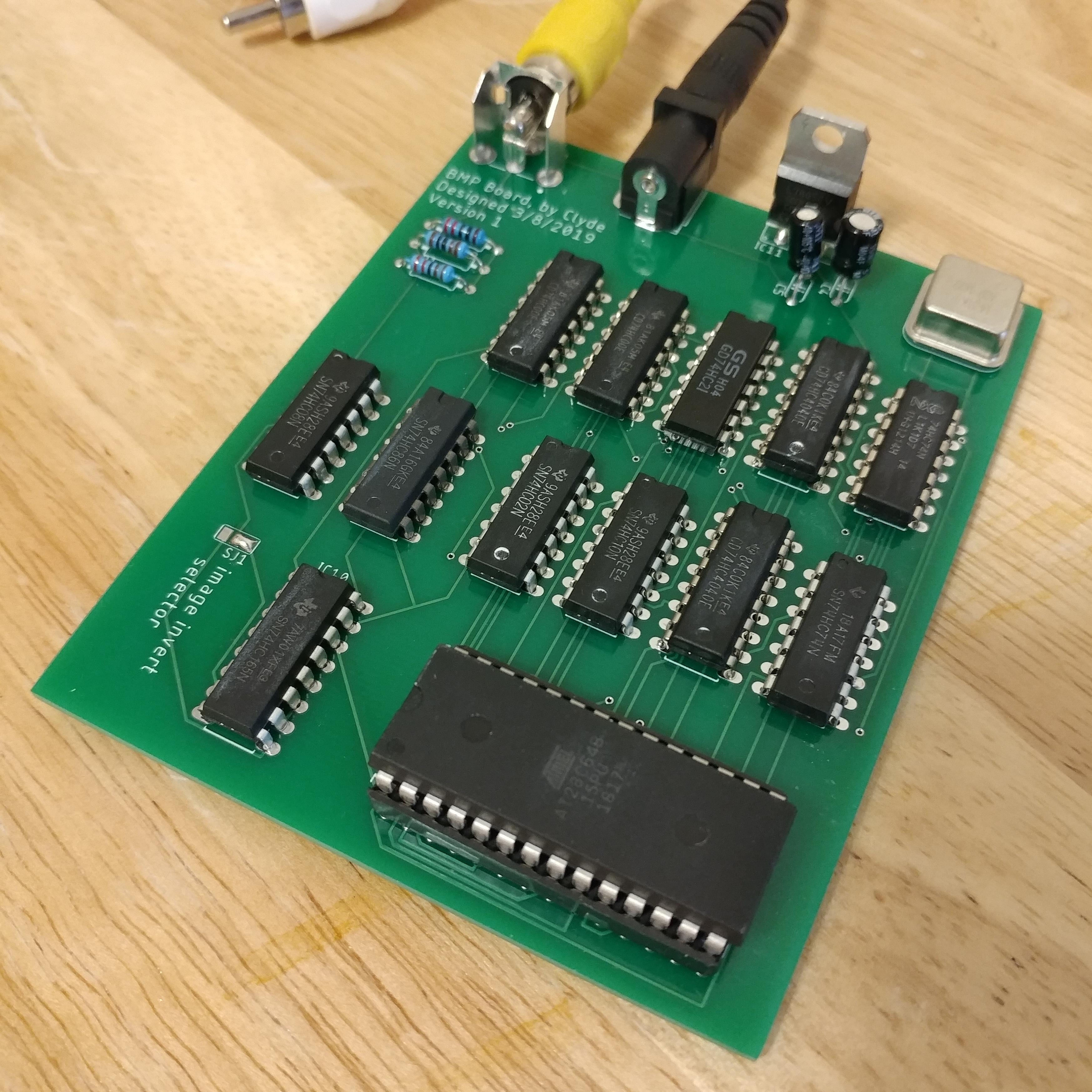

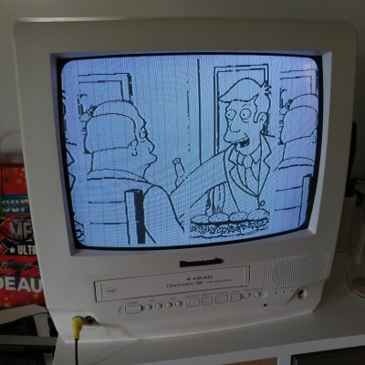

I started by studying the schematics to the original arcade Pong to generate sync signals, then diverged to use the sync counters as addresses and feed the contents of an EEPROM through a shift register to output a black and white image on a TV screen:
The circuit used a 28C64 (64 kbit) EEPROM for image storage as a stand-in for the dual-port RAM I'll eventually use. The image format was 1bpp 256x256 bitmap, which can be exported from Photoshop and de-headered with a simple script.
This was maybe like the third PCB I had ever designed, which is the excuse I now give for the flaws such as missing bypass caps and wacky traces. The circuit design itself also had the flaw that I was starting reading each row of memory at HSync, leaving the first several columns off-screen. I compensated by moving the image to the right, with wrap-around, and wiring the address pins so that the image would repeat horizontally. This roughly centered the image on screen, but showed extra tiling on the sides.

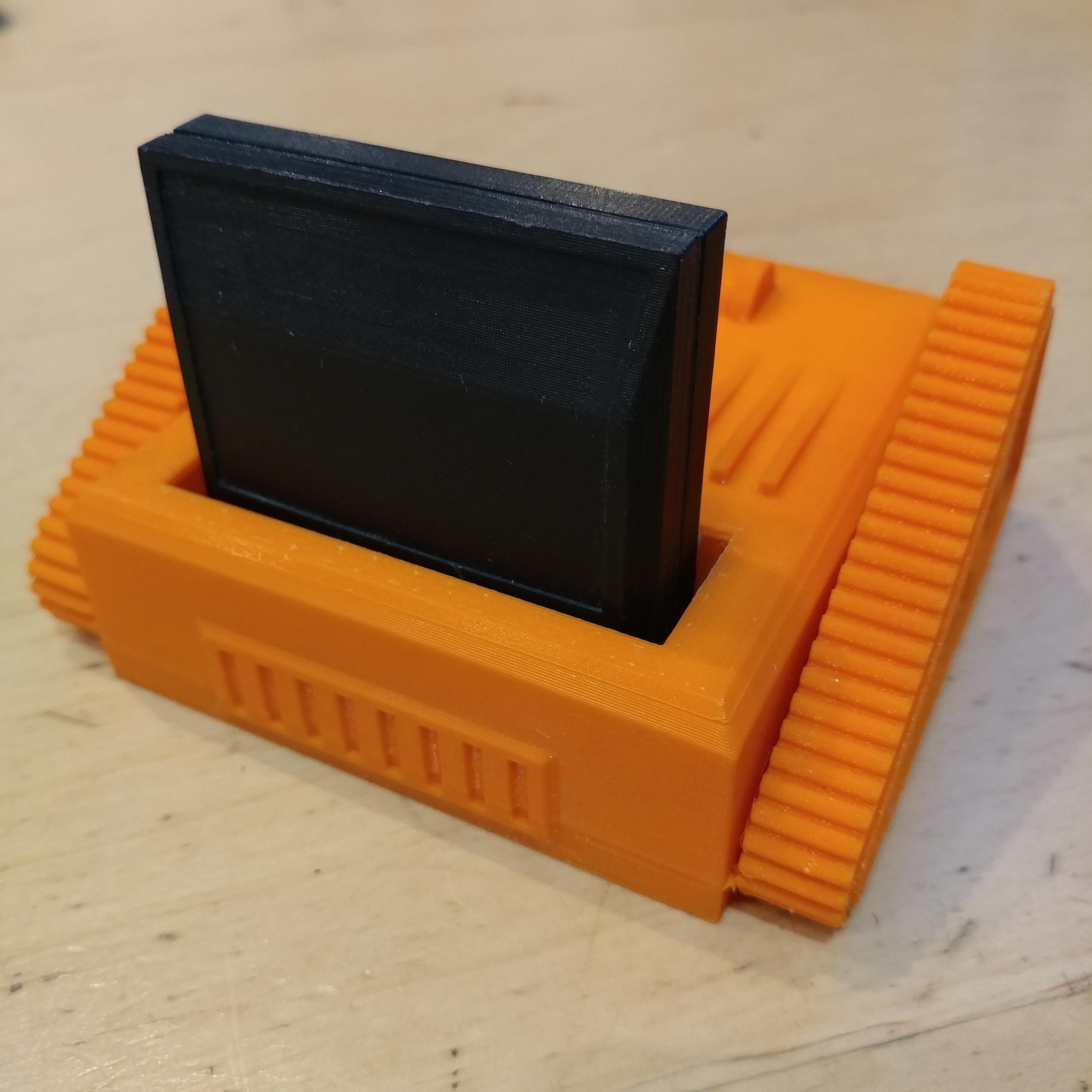

I next designed a version that tested out my ideas for a cartridge pinout. (Though without yet tackling the image positioning)
The circuit is mostly the same, but I forgot the autorouter and remembered the bypass caps.

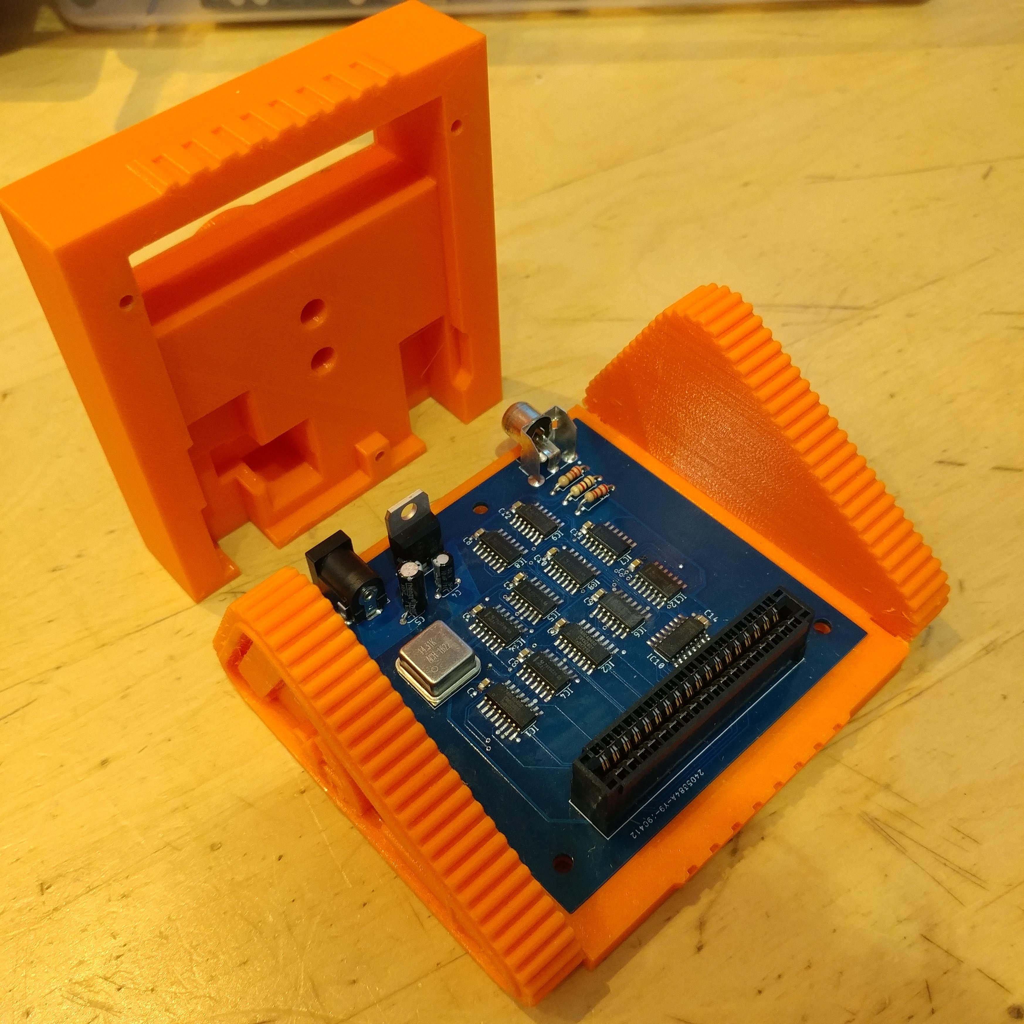

On a whim I had included certain, er, subtle design flourishes on the shell. It was shortly afterward I started calling my project the "GameTank"
Following this prototype I set video aside for a bit to work on address decoding and audio. But those will get separate a separate post.

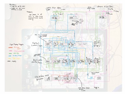

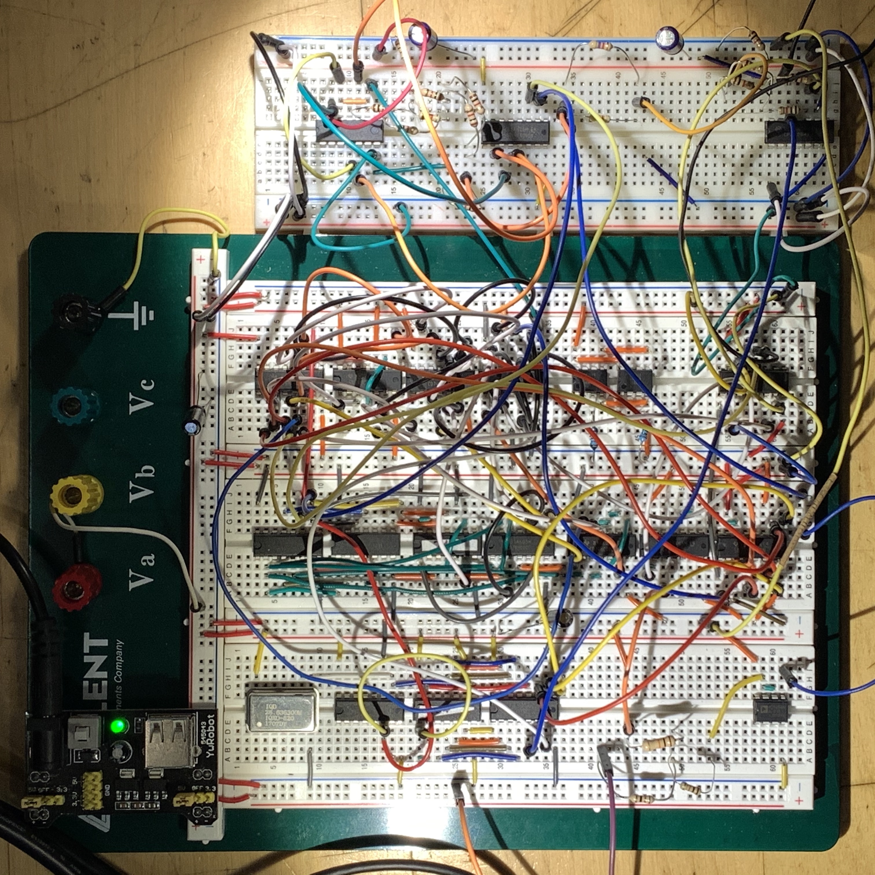

I rebuilt my monochrome video breadboard as a starting point. The new parts included a 28Mhz oscillator to replace the previous 14Mhz, a shift register, and an 8-way selector/multiplexer. The 28Mhz square wave clocked the shift register, and a 3.5Mhz division was used as the data. By changing the select bits on the multiplexer, I was successfully able to choose from eight phases. After some analog trial-and-error with resistors and opamps, I convinced the TV that this was indeed a color video signal.

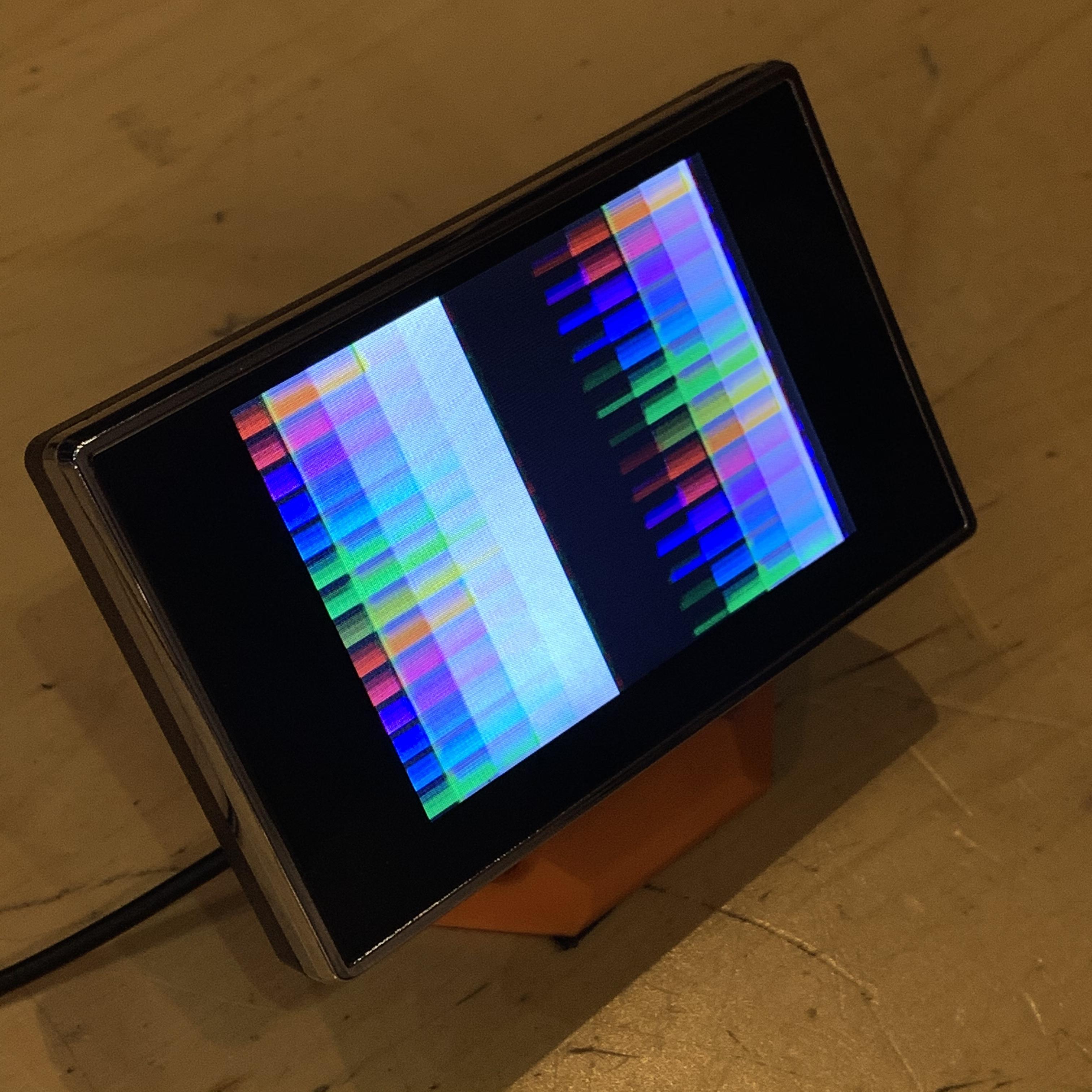

This pattern isn't just for being fancy, either. Between a pair of resistor-ladder DACs and the multiplexer, I had 3 bits for each of Hue and Luminosity; as well as 2 bits for saturation. By hooking these control bits up to the sync counters I could cycle through all possible values, and continue fiddling with resistors until I was satisfied with the range of colors. This small dashboard screen for backup cams was also the most temperamental of all the screens I'd tested on, so it made a good baseline for compatibility.
Finally, my most recent addition has been to connect a ROM and take a swing at the image positioning problem I had before. I connected two more 4040 counters on an additional breadboard, which followed the same clock as the sync counters but used HBlanking and VBlanking as their reset signals. This way their counts would be zero until reaching the "picture" part of the screen. Or at least a lot closer to it.

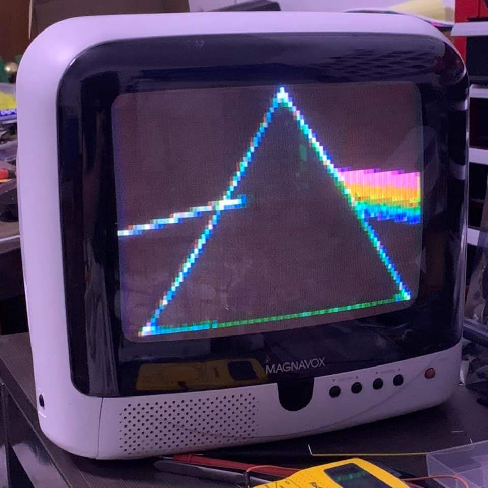

At first I thought I was going to have to write a custom converter to put photos into my hardware's 3:2:3 Hue-Saturation-Luminosity format. However, by generating a color table file I was able to leverage Photoshop once again. When converting an image to Indexed Color, Photoshop looks at each of the original pixels and finds the closest matching color in a provided table. This pixel gets saved to file as a single byte, normally interpreted as the index of the color in the table. Thus I generated a colors file containing the colors my board could display, ordered such that each one's index matched its HSL representation.
Currently the image only puts 80-ish pixels on the screen horizontally and 60-ish vertically. When I get home I next want to try shifting the horizontal address counter up by 8 to the 28Mhz and then back down by 5 with a 74HC161 in div-by-N configuration to get the image to more closely align to the screen.

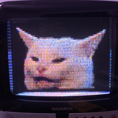

Had some success re-aligning the image horizontally by using a 161 to scale the pixel clock, and another to pulse the reset line of my X address counter just before the start of the visible screen region. For now I’ve got the leftmost image pixels repeated for a few columns at the start of the scan line, and 2-3 columns on the right that repeat the image.
I think I’d rather have all 128x128 addressable pixels be on screen than try to eliminate visible borders. The stretched edge pixels are kind of cool, so I’ll try to fix the right side border to match.
I’ve also got a few more rows lost to the top and bottom of the screen than I’d like... 36 scans above and 20 below. Though since scan lines are a discrete quantity there might not be much I can do about it. Each pixel will occupy two scanlines, so that’s a total of 28 pixels lost in vertical resolution. Given how close to square my pixels ended up so far I think I can live with 128x100.
(Edit: The previous prism image may *look* aligned, but that's because I manually shifted the padding in Photoshop. The cat image attached to this post has better horizontal resolution, by about 30 pixels)

Picture looks 99% the same today, but I did want to post that I did indeed get the right side border to match the left instead of starting to repeat the row of pixels.
From the 4040 counter used to generate the lower 7 address bits, I connected the next highest bit to an unused NAND gate to invert it, and then to the 161 that scales the pixel clock.
For the moment this solves the problem without adding any additional ICs, but it does mean that the right border matches the left *exactly* instead of matching in the sense that it stretches the rightmost image column.
Using an 8-input NAND should stop it a column earlier. Not sure just how badly I want separate control over the side border colors.
The current configuration is arguably 127x100 + a byte on each row that decides border color. If I add the 8NAND I'll essentially have 126x100 + two byes per row for the left/right border colors.

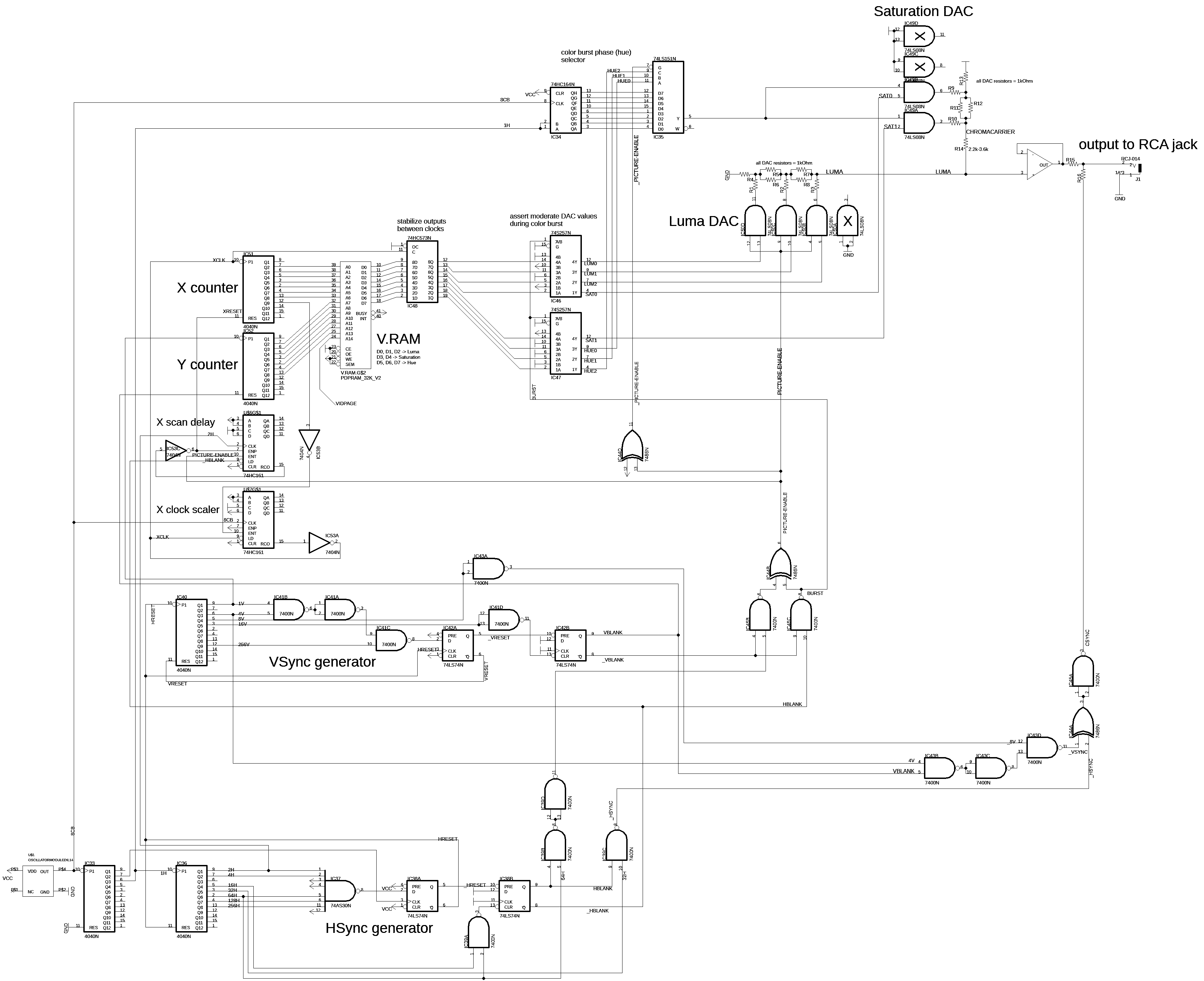

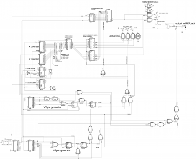

I've finally prepared a schematic for this video board. This sheet, unlike the breadboard, uses a dual-ported RAM.
The other port of the RAM module will be controlled by my DMA project, so once I've hammered out the details with that I'll order a board and hopefully see an improvement in signal stability.
