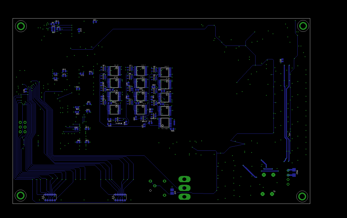

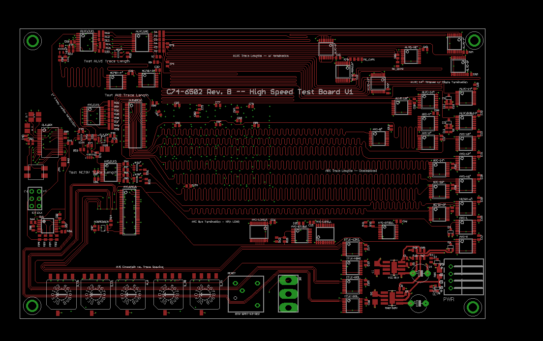

I’m finally getting ready to order the test PCB. The idea is to run through a bunch of high-speed signal integrity tests on an impedance controlled PCB.
The board features some hex rotary switches into a ICS525 configurable clock to generate frequencies on either side of 100MHz in fine increments. CDCLVC1110 clock buffers distribute the signal to ALVC, AVC and NC7SV family driver ICs. The drivers exercise traces in a variety of configurations — point-to-point lines of various lengths, buses with stubs for other drivers, crosstalk aggressor and victims lines at various clearances, etc. A couple of the buses have options for both diode and RC termination.
Eventually, all the traces arrive at 74LVC163 counters which should track together if edges are clean. Stopping the clock after a short run should reveal which specific counters are having problems at various clock-rates. There is also a provision for an external clock signal just to evaluate what impact inter-board connectors might have.

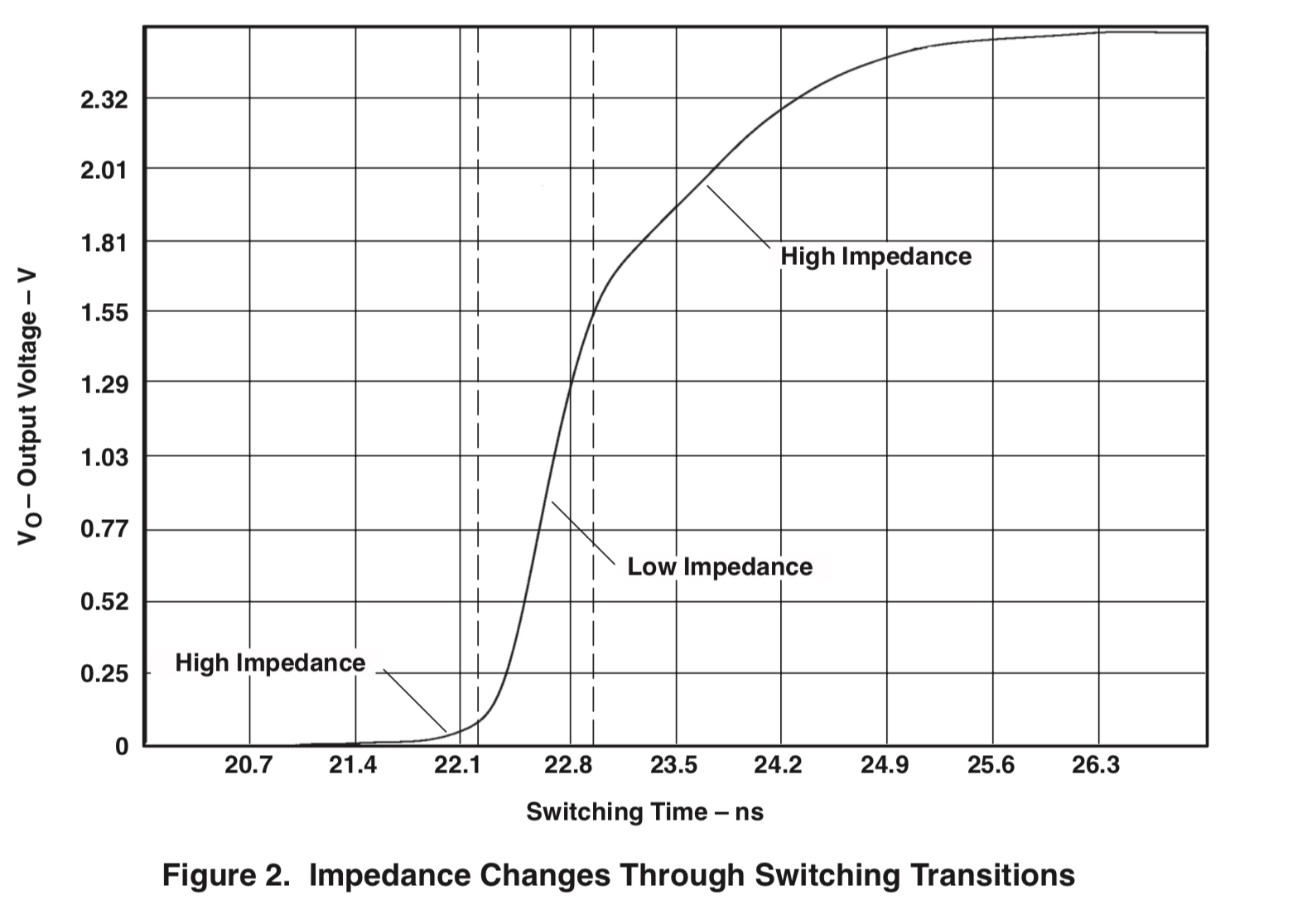

ALVC and NC7SV point-to-point drivers all have footprints for impedance matching source series resistors. AVC drivers, on the other hand, rely on Dynamic Ouptut Control (DOC) outputs instead. The idea is that the output impedance of DOC drivers changes dynamically during transitions to tame reflections.
Quoting from AVC Logic Family App Note (page 15):
The DOC circuitry provides enough drive current to achieve faster slew rates and meet timing requirements, but quickly switches the impedance level to reduce the overshoot and undershoot noise that is often found in high-speed logic. This feature of AVC logic eliminates the need for damping resistors in the output circuit, which are often used in series, and sometimes integrated with logic devices, to limit electrical noise.
it will be interesting to see how that works out.
On the back of the board, there is a FET Switch cary chain set up to oscillate. The generated signal is used to drive a frequency-divide counter, which should tell us more about the propagation delay through the Elmore chain. All these ICs are in close proximity to minimize signal integrity issues. We’ll see.
A scaled printout of the board shows the footprints are good (those 0402 caps are tiny!), but I’ll give it a couple of days review before sending the thing out just in case.

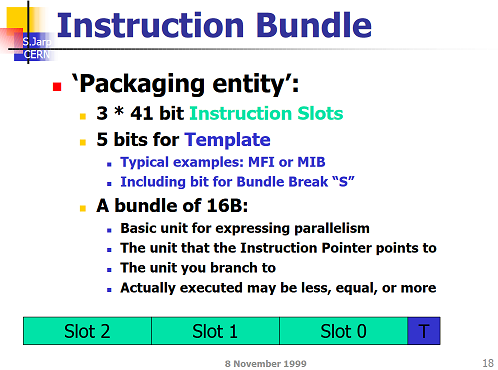

Somewhere above in this thread, I had mentioned the idea to go for a VLIW core (and for a static compilation of 6502 to VLIW machine code)
for squeezing as much speed out of the CPU as possible.
While looking around a bit, I had stumbled over the Intel Itanium microarchitecture by accident.
From the Intel Itanium tutorial, page 18:
From the TREX instruction set:
   |1|I|  Slot 1  |  Slot 2  |  Slot 3  |
   31                                  0
And I _swear_ that I was totally unaware of the Intel Itanium when I did plan/build TREX. :roll:

The concept of VLIW just "moves" some of the problems from the hardware side to the software side, where fixing bugs is supposed to be less fuss.

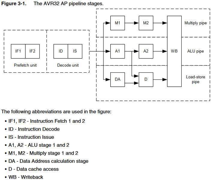

Hmm... the 7 level pipeline of AVR32 AP looks interesting, PDF page 21.
Edit: I still wonder why they had "forked" the pipeline like this:
