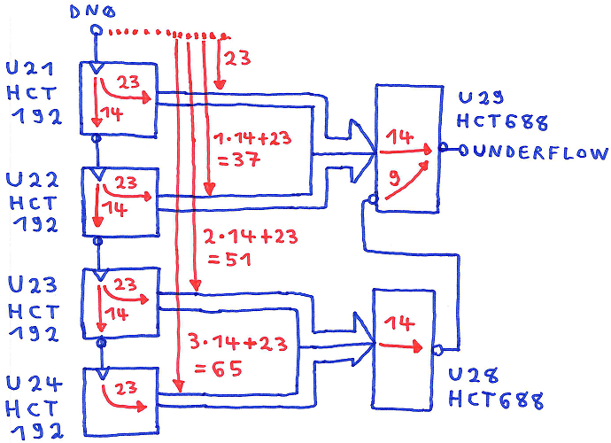

Analysis of the typical propagation delays in the timer + comparator section:
there _will_ be considerable spikes on the UNDERFLOW signal.
Edit: HCT192 in the picture, should have been HCT193, sorry.

I'm trying to get my head around the propagation delay for the 4 counters+the comparators. Something in my mind keeps telling me it should be OK, but I know I can't dismiss your advice.
Here are my thoughts on this.
I am counting down, with U21 being the 4 LSB, and U24 the 4 MSB. 74193 is synchronous, so, within each nibble, the outputs will change in sync.
Let's say we're in the last 16 ticks of the counter. U24, U23, U22 already at 0000, U21 at 1111. Outputs from U24,23,22 and U28 will be stable long before U21 reaches 0000. As it's synchronous, there's no danger of it glitching the UNDERFLOW signal. Delay from PHI2 rising edge to UNDERFLOW would be 23+14=37 ns, with no risk of glitches.
I need the underflow signal to be raised before the falling edge of PHI2, as the read operation taking place at that time, should already see the counters reloaded. The UNDERFLOW signal goes through 2 NAND gates, 1 NOR gate, and the time the 193 needs to be reloaded. That's 7*2+8+20=44ns. 81 in total. At 1MHZ, I have 500ns, so plenty of room. 5Mhz would already be pretty tight though.
Back to the glitches... when can they happen? If U21 goes from 0001 to 0000, all other counters should already be stable at that point. Next tick, U21 goes to 1111 (If there hasn't been an overflow already) and the DN clock propagates to the other counters.
I'm pretty confident this won't be an issue at 1MHZ. I'm also pretty sure almost everything I'm doing would need a serious rework above that... but anyway, so far so good.

The output of U21, U22, U23 and U24 doesn't change at the same moment.
If a 74HCT193 counter has a typical propagation delay from "count down input" to "underflow output" of 14ns,
the output of U22 will change 14ns (37ns-23ns) later than the output of U21,
the output of U23 will change 28ns (51ns-23ns) later than the output of U21,
the output of U24 will change 42ns (65ns-23ns) later than the output of U21.
//the output of U21 changes 23ns after DN0 triggers the "count down input" of U21.
I think the 74HCT688 comparators are fast enough to notice those differences in the timing.
A change of the U21..U24 outputs will cause a change in the UNDERFLOW output... with some delay.
If a 74688 comparator has a typical propagation delay from A,B to Q of 14ns and from /E to Q of 9ns,
we are getting a response at the UNDERFLOW output after DN0 clocks U21:
U21: DN0 to UNDERFLOW = 37ns = 23ns+14ns
U22: DN0 to UNDERFLOW = 51ns = 37ns+14ns
U23: DN0 to UNDERFLOW = 74ns = 51ns+14ns+9ns
U24: DN0 to UNDERFLOW = 88ns = 65ns+14ns+9ns
In other words, when DN0 clocks U21,
37ns later the UNDERFLOW signal can't be trusted for a time window of 88ns-37ns=51ns.
Somebody please correct me if I'm wrong.

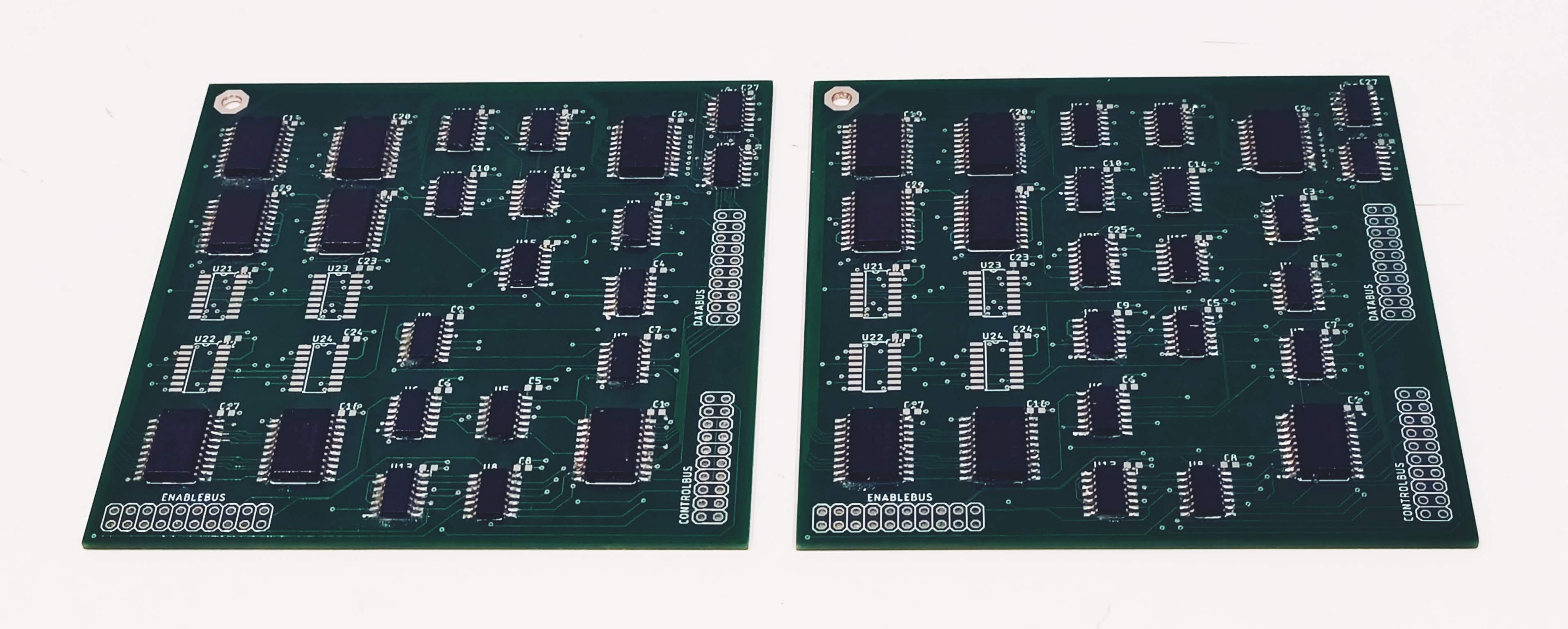

I have the same feeling I had when I completed the first board..
There's no way this will work. There're too many things that could fail. However, I was wrong that time. Let's hope for the same.
I'm just waiting for the '193s. You can see the empty spots on both boards.
