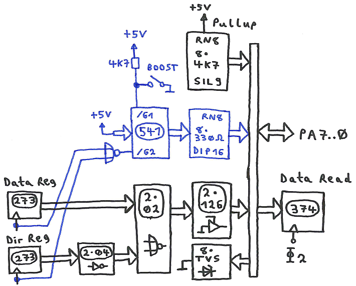

"Open collector" means, the driver only is able to switch the output pin to GND.
For 74LS, it's something like a bipolar NPN transistor as in the picture above.
For 74HC(T)\AC(T), it's a FET instead, but the concept remains the same.
The 74125\74126 buffer has a push/pull output, means there is (at least) another transistor
for sending current from VCC into the output too...
but when connecting the input of the buffer to GND and just tinkering with the output enable,
the buffer just works like a 7405 or such.
(There are chips like 7405 with an open collector output,
but sometimes they are not available as AC(T), and 74125\74126 gives a nicer PCB layout.
That's why I had used 74125 and 74126 in my experiments).
But back on topic:

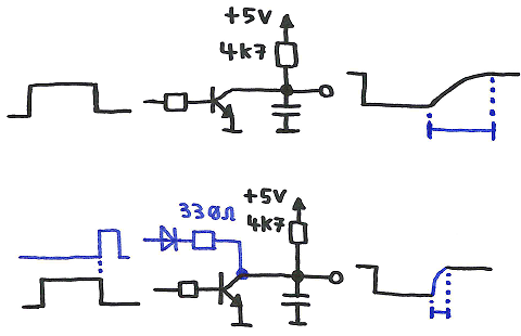

To have a logic high level at an open collector output in case the output isn't switched to GND
by the output transistor, we also need a pullup resistor (4k7 in the picture),
pulling the output to a logic HIGH level.
And that's where the problem starts if you try aiming for speed:
Because of the output resistor, the falling edge of the output signal will be fast,
but the rising edge of the output signal is slowed down by the value of the pullup resistor
and the capacitive load attached to the output pin (as resistor plus capacitor are forming
sort of a "low pass filter").
There is a limit for making the pullup resistor smaller:
Output transistors of a NMOS 6522 or 6526 probably can't pull much current to GND,
so the voltage at the output won't reach logic low level if too much current goes through the pullup resistor.
(Imagine a scenario, in which you have a C64 with a TTL 6526, with a fast loader parallel cable
which goes from that 6526 to an old NMOS 6522 inside the 1541 floppy drive).
An alternative to having a smaller pullup resistor when trying to improve rise time of the output signal
would be to "inject" some current for a short moment, let's say half a PHI2 cycle
(the blue diode and the blue resistor in the picture above).
Haven't tested this idea, of course, so I can't tell how old NMOS chips would like this approach.
But back on the capacitive load in the picture.

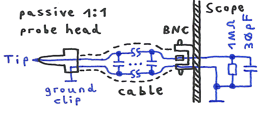

When attaching something like a 1:1 logic probe to the open collector output,
you have the capacitance of the scope plus the capacitance of the cable.
(I'm simplifying things a bit here).
When attaching some circuitry to the open collector output,
you have the capacitance of the PCB traces to GND (and/or between the traces),
plus the capacitance of the IC input pins which are tied to that output.
You don't need to know the boring basics about the innards of scopes and TTL chips, of course.
Now for a block diagram for an 8 Bit open collector output port:
Be warned: That blue marked speedup stuff only is hypothetical and untested.
Remembering my TTL 6522 experiments, there is a latch for reading what's on the port,
and it samples at the rising edge of PHI2...
and I think that the designers intentionally had built it this way for better noise immunity.
About that little box labeled TVS: that's just protection diodes for clobbering down transients.
When trying to drive long lines at higher speeds, adding such diodes might be a good idea.
Too much text, loo little time, if you have some questions please feel free to ask.

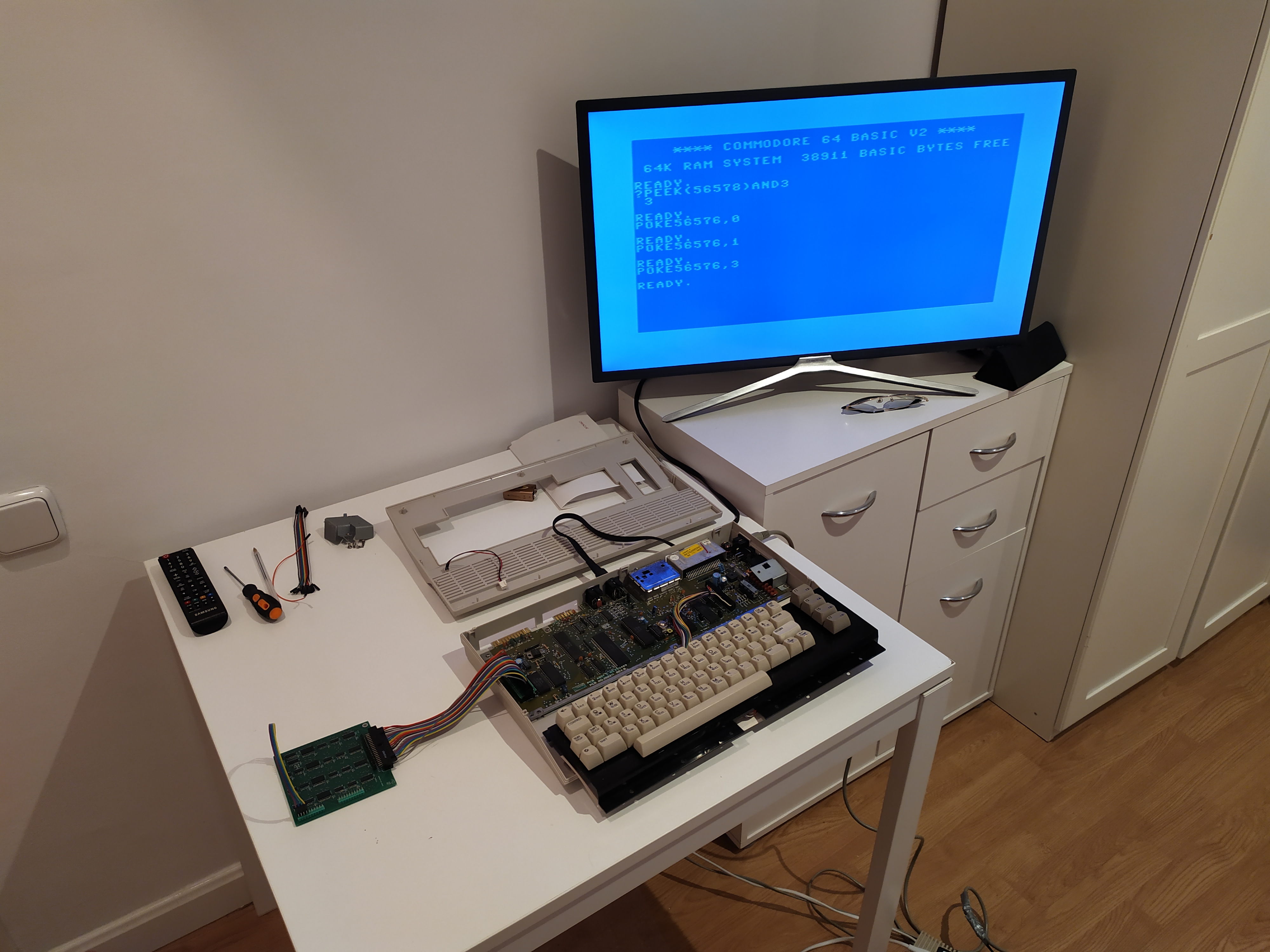

Let me show you what've done until now.

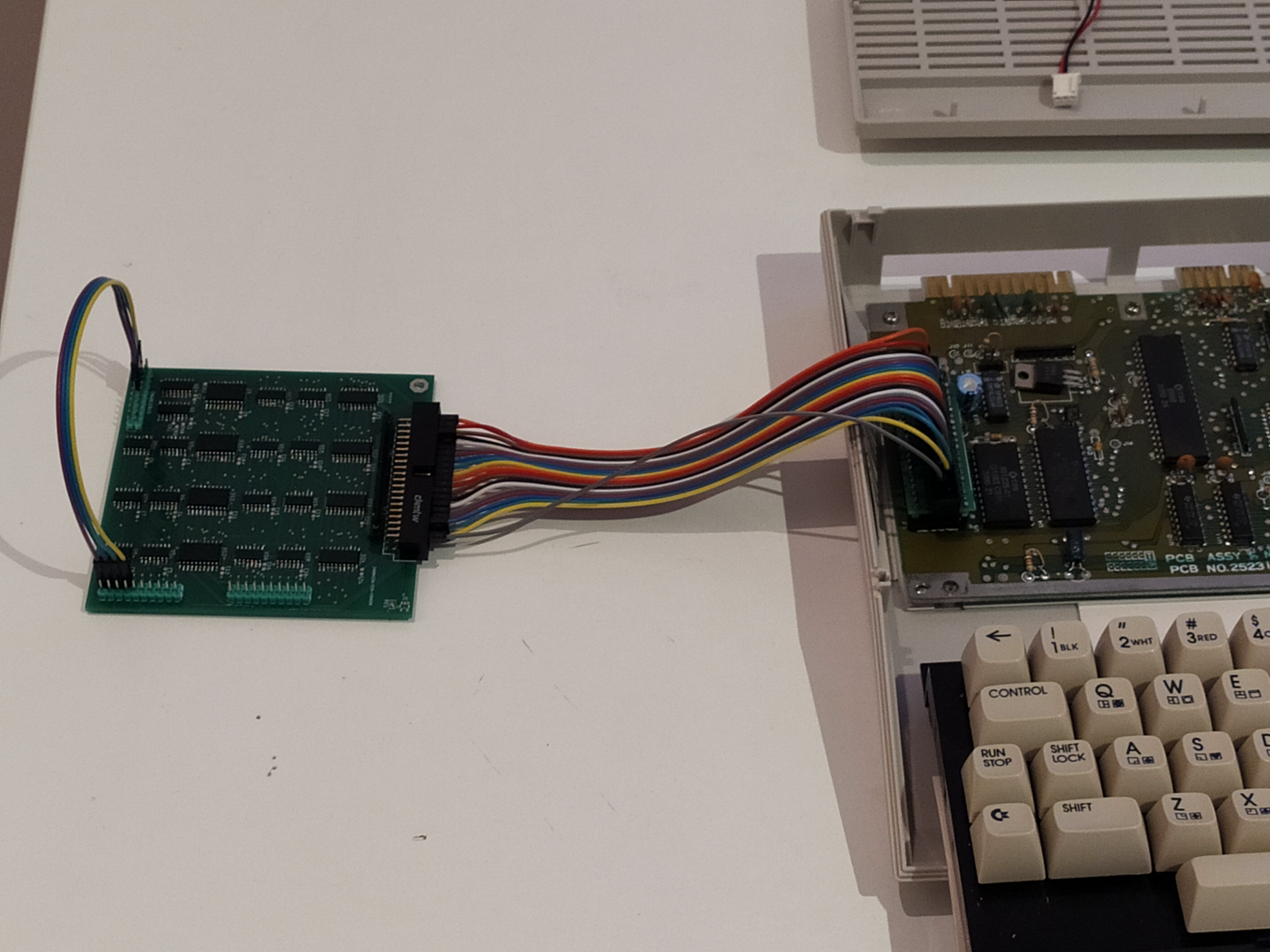

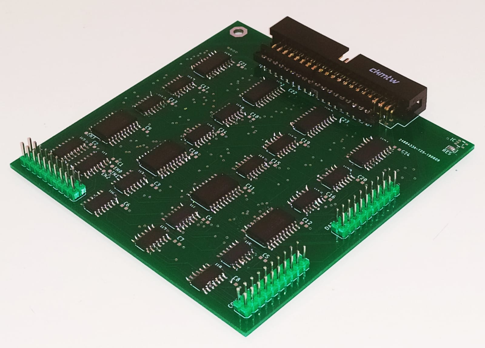

I plan to split the design in 4 separate 10cmx10cm 2-layer boards. Cutting cost is the main factor here, as this are the biggest boards I can get manufactured at the lowest cost. Not ideal, but good enough for 1 Mhz.
Register decoder and selector. Two 138's (enabled by /CS) to select one of the 16 internal registers. Together with /RES and R/W to enable the write or read portion of the register. How did I come to this? Out of the 16 registers, 12 of them are set to all 0's on reset, 4 of them to all 1's. I did find some 8-bit registers with a Reset pin but couldn't find any with a ¿SET? pin. Instead, I gated the data bus together with the reset signal so I have two read internal buses. Whenever reset is high, both buses reflect the contents of the data bus. When reset goes low, one of them reads all 0's, the other read all 1's. My glue logic signals all internal registers to latch the value on the data bus on reset. Atypical? Maybe. But so far... tested and working as expected

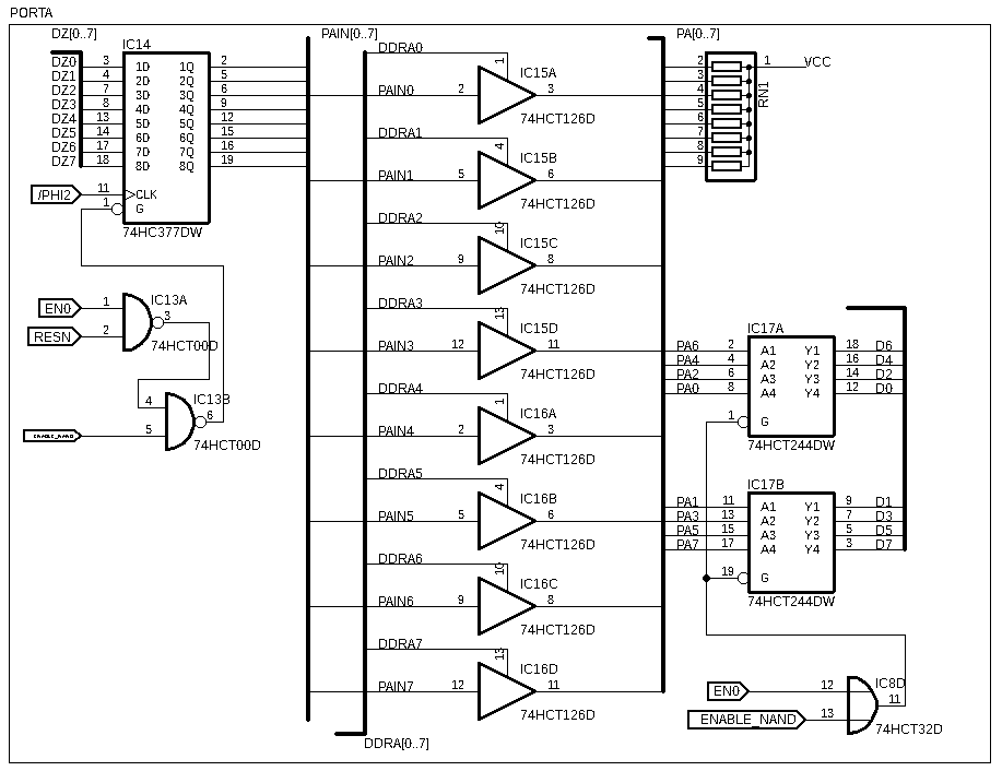

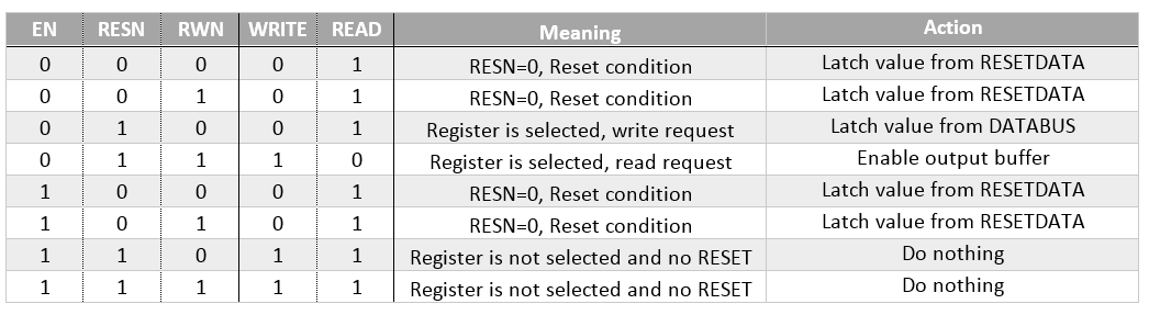

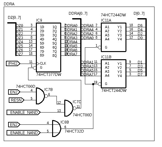

DDRs are pretty simple, 8 bit register, with the value of the register forwarded to the PORTs to select the direction of each pin.
PORTs aren't too complicated either... however, I have some serious doubts with them. According to the original datasheet, both PORTs are "open collector outputs, with both active and passive pullups". The schematic I've posted was my final design so far... however the ideas posted by ttlworks have turned my world upside down! (Well, my PORTs at least)
DDRB is exactly the same as DDRA, while PORTB has some additional bits. As PB6 and PB7 can act as timer outputs, a couple of 2-1 selectors coupled with 2 control bits from the CREGs accomplish this.
So far, all the glue logic, and both DDRs and PORTs fit nicely in Board 0. Next, I'm going to build a prototype of the ports. I have two spare real 6526 so I'll connect them to my prototype to make them talk to each other. Hopefully I'll be able to get some insights on how the outputs are configured.

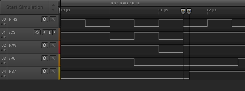

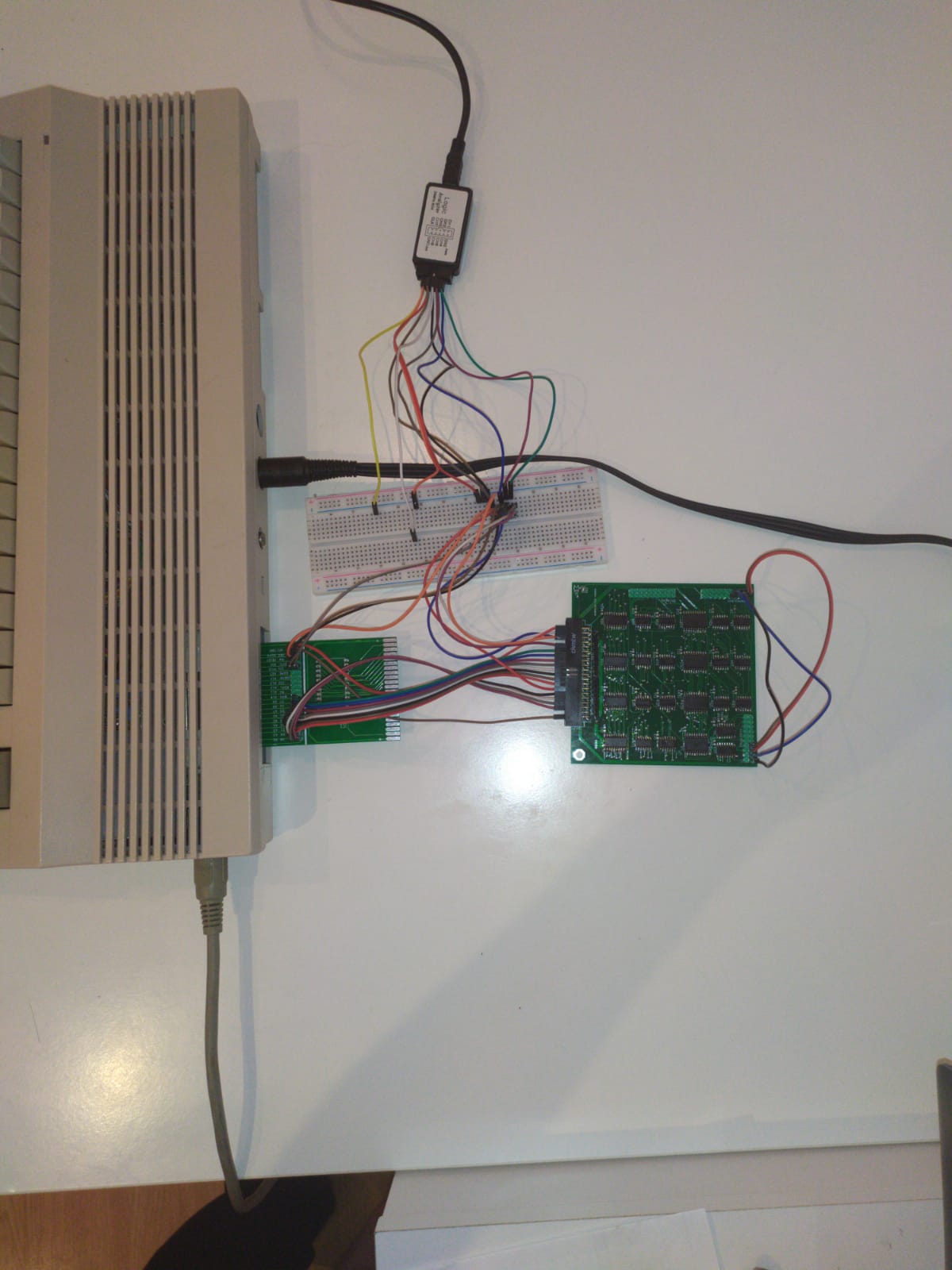

I probably should mention... I have no measurement equipment. No oscilloscope, no logic analyzer... just an extremely cheap multimeter that's falling apart! So right now I'm a bit limited at what I can do. I plan to buy them in the near future though.

And a multimeter with a frequency counter.

Slowly, but steady, I'm making some progress.
I've got a logic analyzer, and an oscilloscope is on its way home. Hopefully, I'll be able to get some insights on a genuine MOS6526. So far, I've taken some measurements with the logic analyzer, and, even though it's not the fastest (can't do more than 8Mhz) it's giving me something.
PORT outputs fall and rises time is always < 0.125us. (Below the maximum resolution of the analyzer). I also have the timings on the /PC output, that signals a read or write to PORTB, used for handshaking.
I already had the circuit for the /PC generator, but I got it wrong. As the 6510 seems to do a read just before a write (I guess this also happens with the 6502, and probably the 65816, that's something I need to investigate) it was making my circuit to generate to separate pulses, instead of a 2 cycle, single pulse. Good thing, the new design is simpler, allowing me to save an inverter and to AND gates.
I'm building now a test bench for the ports. When the oscilloscope arrives, I'll check rise and fall times on the outputs of the ports, as well as confirming the /PC pulse is OK. With all that, I think it should be enough to complete DDR and PORTs. I have a preliminary PCB layout with all the decoding logic, and both DDRs and PORTs fitting in a single 10cmx10cm board (The biggest I can get cheaply!)

Finally got my hands on an oscilloscope and some spare time to give it a try.
I've compared my build against a real MOS6526, and results are... well. Mixed, at least.
Fall time, from logic 1 to logic 0, are pretty much the same in every case. Rise time, when relying only on the pull up resistor, (Port set as input, with nothing connected) are also very close, and the output voltage match.
However, whenever the port is set to output, this is where the biggest diferences are. As I'm actively pulling up the output with the 126 buffer, my design rises much faster and much higher. I get to 5v, while the MOS6526 stays at ~2.9v. (I have a led with a 1K resistor tied to ground in the output).
Despite the differences, I'm within the specs of the datasheet. Will this be good enough to replace a MOS6526? I have two tests in mind.
1) The circuit I built, only uses 1 data bit to save on wiring.... I'm extending it to 5 bits. Why 5? So I can connect a joystick!
2) Replace CIA#2 in a C64. Having no timers, interrupts, or serial, will mean, basically, no Serial Port or User Port access. The test here is, the two lower bits of PORTA act as address bits 14-15 for the VIC-20. If I can bank switch without the computer panicking... that will be a good sign.
I am still confused (even more, I'd say) with this sentence from the data sheet. "Port A and B have passive pull-up devices as well as active pull-ups". I expected the 6526 to be able to pull higher than what I've seen. Until someone does with the 6526 something similar to visual6502, I'll have to rely on the old trial and error method.
EDIT: Small update. I hooked up a 4 bit port (not 5-bit, as this needed 2 aditional ICs) and I was could use a Joystick on this beauty with no problems at all

Re: 74HCT6526 - A MOS6526 implementation with 74xx ICs
Hi all!
Things have been moving quite slowly over the last two months, as I've been quite busy in the real world but, anyway, I've managed to give a little nice push to this project.
I've been able to complete and run enough tests to be pretty confident about everything that goes into what I call, Board 0. This is
- 65xx bus interface
- DDRA and DDRB
- PORTA and PORTB
Once I was satisfied with the design and the PCB layout, I put an order for the pcbs and a bunch of components. Then, even though it took a couple attempts before by soldering skills were, at least, good enough... please let me introduce you to the 74HCT6526-Board0
I must say, the soldering is not the prettiest and it even looks a bit awful at some places (Do you notice all the little "spikes"?) but, once it was connected to my battle C64 via the expansion port...
Success!! I can write to both DDR, and I've been able to send data from one port to another. I also read two joysticks connected to the ports, and everything worked as expected.
There's just two things that are still not perfect.
Output delay to the ports is much much shorter than on a real MOS6526. I've measured between 125ns and 250ns on a real unit, but mine does it well below 125us. If the datasheet that's around the internet is to be trusted, this is still within specs, as there's no lower limit to it.
Also, the /PC negative pulse that follows a read or write to PORTB happens earlier, although the duration is correct, 1 full cycle. Problem here, I haven't been able to get any real specs on this, so it will need to be tested with some peripherals that used this.
Next step is to replace CIA#2 in a real C64 with this board. PORTA alone should be enough to let the computer boot up properly, and even access the serial port. I still need to grab a working disk drive. This will be for sure a very interesting test!
Beyond this, work on Board1 is, I'd say, 40% completed. Board1 houses both control registers (REG 14 and 15) and both timers (REG 4 through 7).
Cheers!
- DDRA and DDRB
- PORTA and PORTB
Cheers!

Just two words...
It works.
I think I'm gonna go celebrate
Also, I'm buying a 1541, like, right now!, I have to really test this baby! Although I'm not yet sure if DDR and PORTs are enough for disk drive access... Maybe the Timers are also needed?
Anyway.... I'm really gonna go celebrate!
It works.
Congratulations.
IIRC the IEC bus routines in the C64 Kernal don't use timers.
Don't party too hard.
Looking forward to see, how the adventure continues.
Boy, nothin’ like plugging into a socket on a real C64.
And that moment when the machine boots — magic!
Congratulations Dani. Great work.
