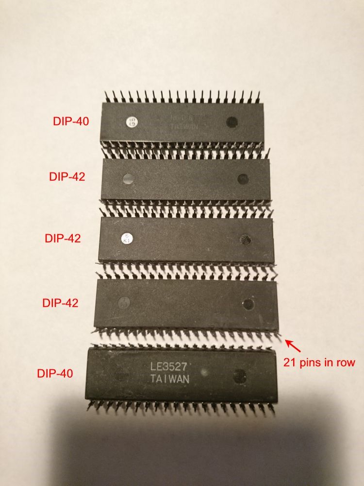

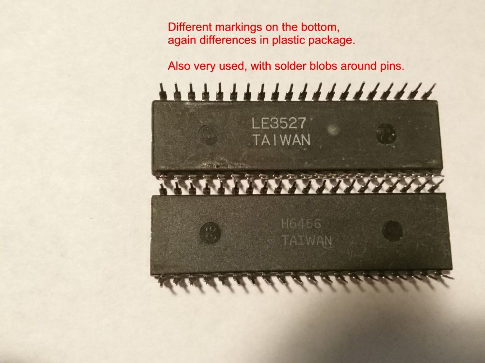

Yeah, we all heard those. I bought chips for stupid good price. Each cost me $2 apiece shipped, on eBay. From China, naturally. Listed as new W65C816S, but very used with blobs of solder. And it only gets better from there.
I bought five of them. Three arrived in a DIP-42 package. I am not aware of any WDC chips in DIP-42 package, and won't know where to even look for such a pinout.
We'll use this resource for further analysis:
https://www.aeri.com/counterfeit-electronic-component-detection/
Let's dig in.

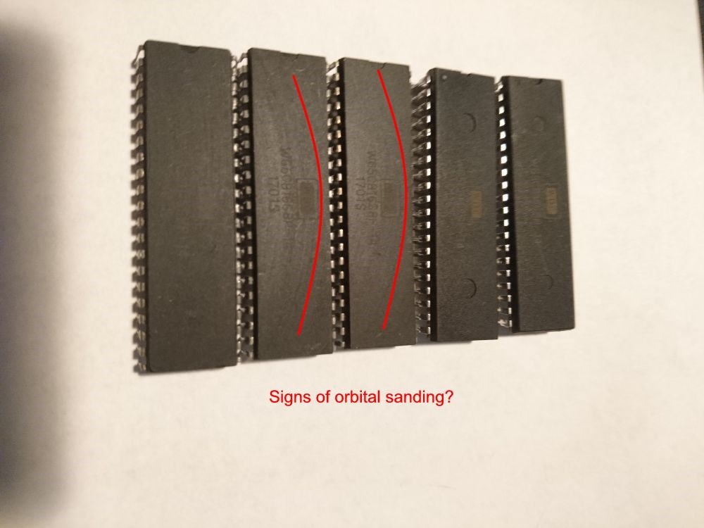

They were also very dusty, I'm guessing sanding dust.
So, is there any chance these are actually good? I mean they almost certainly remarked... Those 42-pin chips some busted EEPROMS on the inside, like completely fake?
I knew there was some risk when I was buying, but I didn't expect to have it this bad. Lesson learned.
I will likely get my money back, but still annoying.
So can you recommend a good WDC distributor where I can get the real thing on the cheap?
Thanks! Feel free to have some fun at my expense.
PS Here's where I bought these suspects:
https://www.ebay.com/itm/1pcs-W65C816S8 ... 1015567406
(I had additional discounts at checkout)

By my reckoning, 42 pins is 5% extra... it might be amusing to try to see which pins are inputs, outputs, power supplies. There might be ways of doing that - I'm thinking resistance, capacitance, diode nature.

The date codes alone tell me these are counterfeits.

DIP-42 is not rare but also not common. A quick Google search turned up an answer that actually makes logical sense, and that DIP-42 is most commonly used for types of ROM (most commonly EPROM), with the 2 extra pins obviously being 2 more address lines for larger addressable capacity (vs more common DIP-40). There are also some obscure MCUs that used that package. In all I'd guess that they are used ROM chips that were pulled from recycled boards, sanded down and remarked as fake WDC chips. Looking up a pinout for DIP-42 EPROM should turn up a common pinout, and it's probably it, but honestly I don't think it's even worth the time to check.
As for a source for the genuine article, it all depends on your location in this world.
Are date codes week number and year? Any code letters?

The first and second digits are the year, the third and fourth are the week of the year. The date code should be preceded with and followed by alpha characters. The part number itself tells you the chip specifics, including the process geometry.
