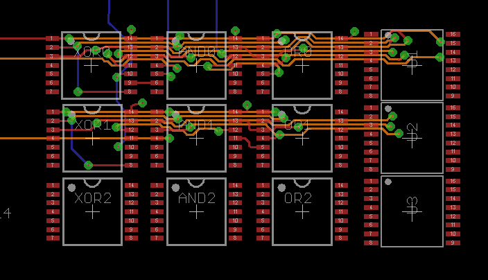

PostPosted: Sat Jan 05, 2019 12:07 pm
Here's the plan for the ALU (shows one bit slice). There's an AI input and a BI input. The AI input can be one of the 4 registers, a 5th register M, or program counter low/high. The BI input always comes from M, but can be optionally cleared or inverted, or both, allowing for add, subtract, increment, or decrement.
An 8:1 mux picks one of the 7 operations: AND/OR/EOR/ROL/AI/ROR/ADD. An eigth input is still free. The AI operation just passes the AI input to the output. Carry goes in from top, and ripples down to next slice.
For BCD operations, the idea is to store the output of the binary addition in A, and at the same time, store the BCD adjustment in M. An extra cycle follows where A+M is calculated and stored in A again.
Each slice uses 4 ICs: the MUX, quad AND, quad OR and quad XOR. There is one XOR, one AND, and two OR gates left over, which I hope to use for Z-flag and decimal carry generation.
 Post subject: Re: Yet another TTL 6502
PostPosted: Sat Jan 05, 2019 12:45 pm
And here's preliminary layout check I did earlier. There's still some room left for traces to connect the other gates. As you can see, I like to work on all phases of the project at the same time, rather than work strictly top-down.
