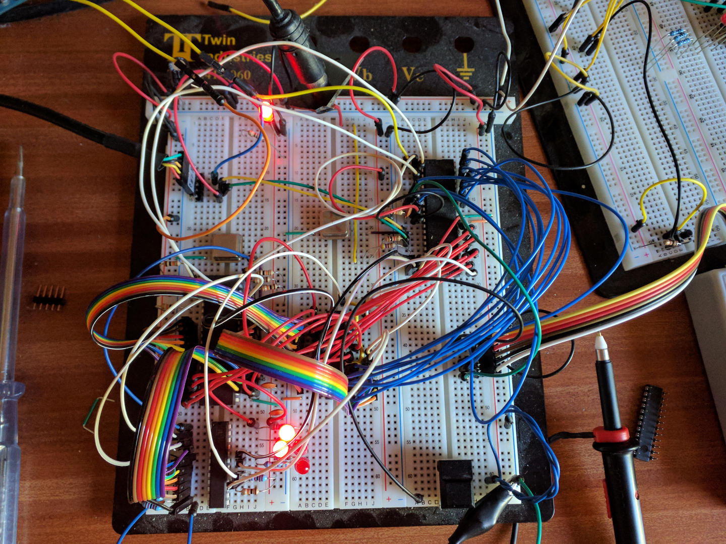

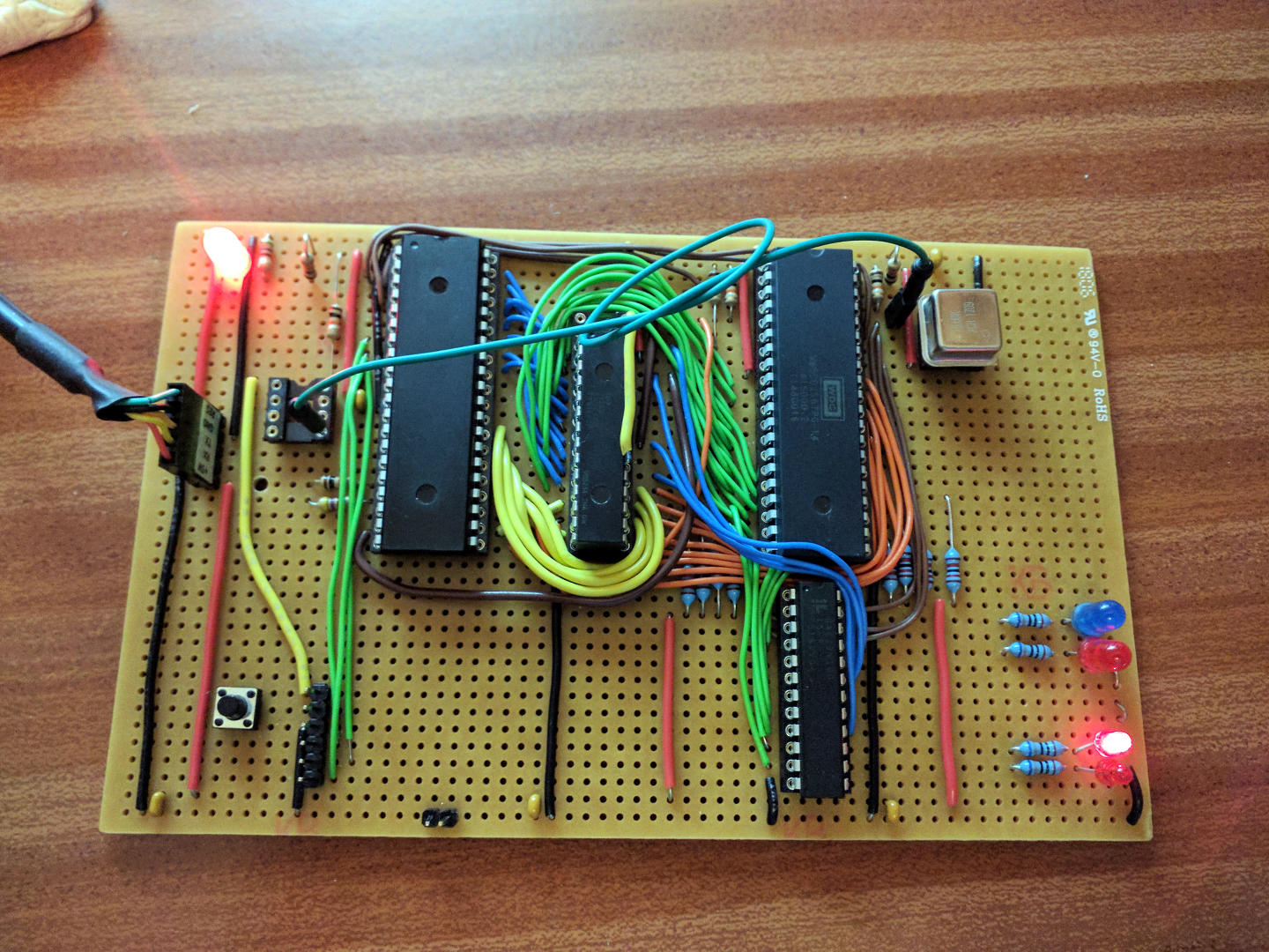

Playing about with some ideas for my '816 SBC and I put together a 65c02 SBC for some fun and have been pleasantly surprised to find that it runs very well at 16Mhz.
I cobbled it together on breadboards as a quick proof of concept, then put it on stripboard.
The Ugly Mess of wires!
To give you an idea of the chips, from left to right: ATmega 1280p, 64KB RAM (2 x 32Kx8 stacked, yellow wire is the chip select from the top-one), and the 65c02 and below that is a Lattice GAL 22v10.
So no ROM - the ATmega pokes code into the top 256 bytes and can control the BE, Rdy, Reset and IRQ lines to the 6502. (It also reads the Rdy line which is the signal that the 6502 wants to send data to the ATmega. ATmega provides video 320x240x1 PAL composite), serial and soon SD card via SPI. I have 2 spare pins on the ATmega which I may use to implement a PS/2 keyboard interface.
The greenish floating wire is carrying the 16Mhz clock from the 6502 to the ATmega only because I only have one 16Mhz crystal osc. (yet another surprise that it works - it's probably bleeding 16Mhz all over the place, but it works!)
I started it at 2Mhz and was nicely surprised when it got to 16Mhz. It's ran an overnight memory test (250,000 passes) without any issues (the RAM is 12ns though)
The GAL decodes A15 for the 2 RAM chip selects and a page of IO at $FE00 (which the only thing connected to is that 5mm red LED) and qualifies read and write to the memory from the cpu + ph2 - the usual stuff.
I had intended to stick a 65c22 on it, but made a bit of an oops with the chip positioning and didn't leave quite enough room to the right, although I have seriously considered straightening the pins and mounting a 65c22 vertically, but I don't really need one for this experiment. I might stick a latch and some LEDs on it though.
So my plan is to play with this for a while, then make an '816 version then PCBs. (and invest in some "proper" 14Mhz crystal oscs! :-)

The ATmega 1284p (must correct my OP) isn't a ROM as such. At power on, it holds the 6502 in reset, with BE and Rdy also held low. Then it uses 2 8-bit ports, one for the data bus and one for A0-7. A8-15 are pulled high by resistors. At that point, the ATmega has 256 bytes of ram to poke about with which is mapped to $FF00-$FFFF on the 6502. So it pokes in some code + vectors, then lifts Rdy, BE then finally reset and the 6502 boots.
At any time the ATmega can pull Rdy low, then BE a few µS later (I think I need to wait for the current instruction to finish before pulling BE low although I've not found any definitive documentation on that yet), then the 6502 is paused and the ATmega can see the RAM (it tristates it's 2 8-bit buses when the 6502 has control). Then the ATmega can un-pause the 6502, etc.
So the 6502 can re-locate the first stage boot down to $0400 (arbitrary choice), then write a command into the shared RAM and WFI. At that point, the ATmega has been polling the Rdy pin (in input mode), pulls BE low, gets the data from the shared region, writes stuff back, releases BE and pulls IRQ low and releases it when it sees Rdy going high - the 6502 wakes up and off it goes. I've more work to do in that department, but I've tested it all in-principle and it works OK.

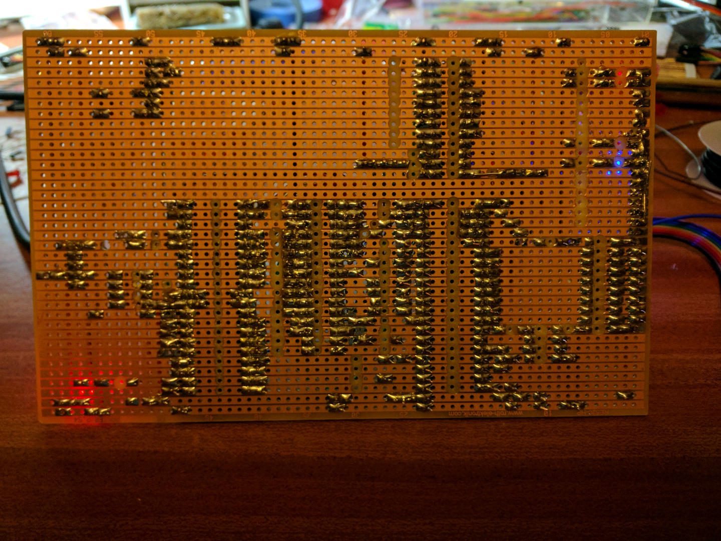

As for the undercarriage - it's not pretty :)

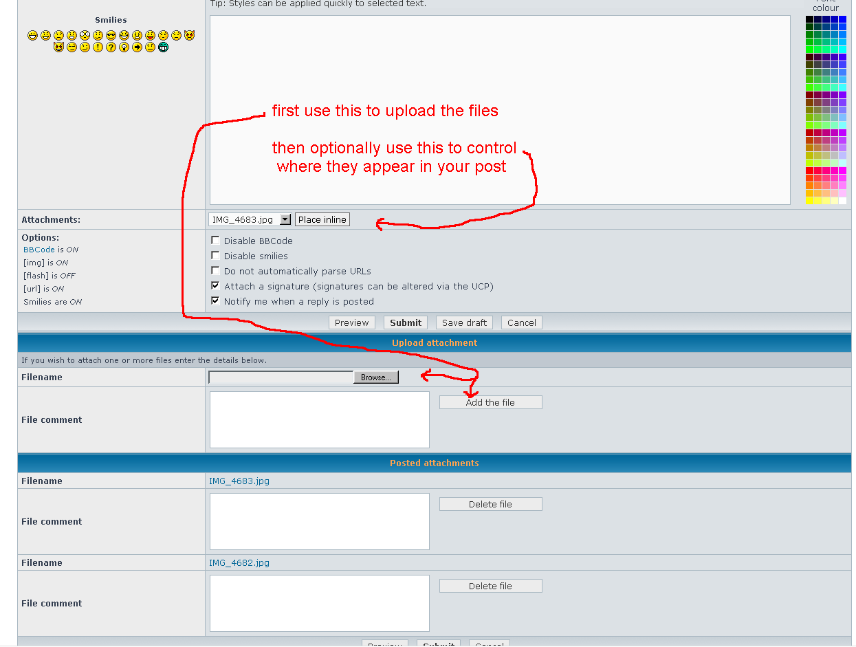

I ought to reduce the image sizes - I thought the forum here would display shrunken ones, but it doesn't seem to (or I've not worked out how)
The forum software will display a thumbnail if you include the image as an attachment to your post. But the images you posted above aren't hosted on 6502.org.
Many forum members seem unaware that image attachments are permitted. Consequently, some folks use third-party sites where the images unfortunately won't have much permanence. In contrast, content on 6502.org regularly gets backed up, and will remain intact for future readers to enjoy.
I'm aware I can upload. I also run my own servers which are also backed up. I host my own images so I can show others without giving a forum link, nor subjecting them to slow bandwidths or stupid adverts. However I've also used other forums which will grab and create thumbnails on the fly.
