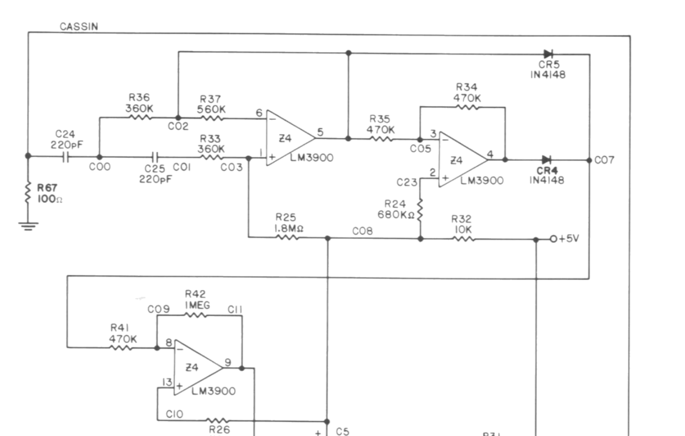

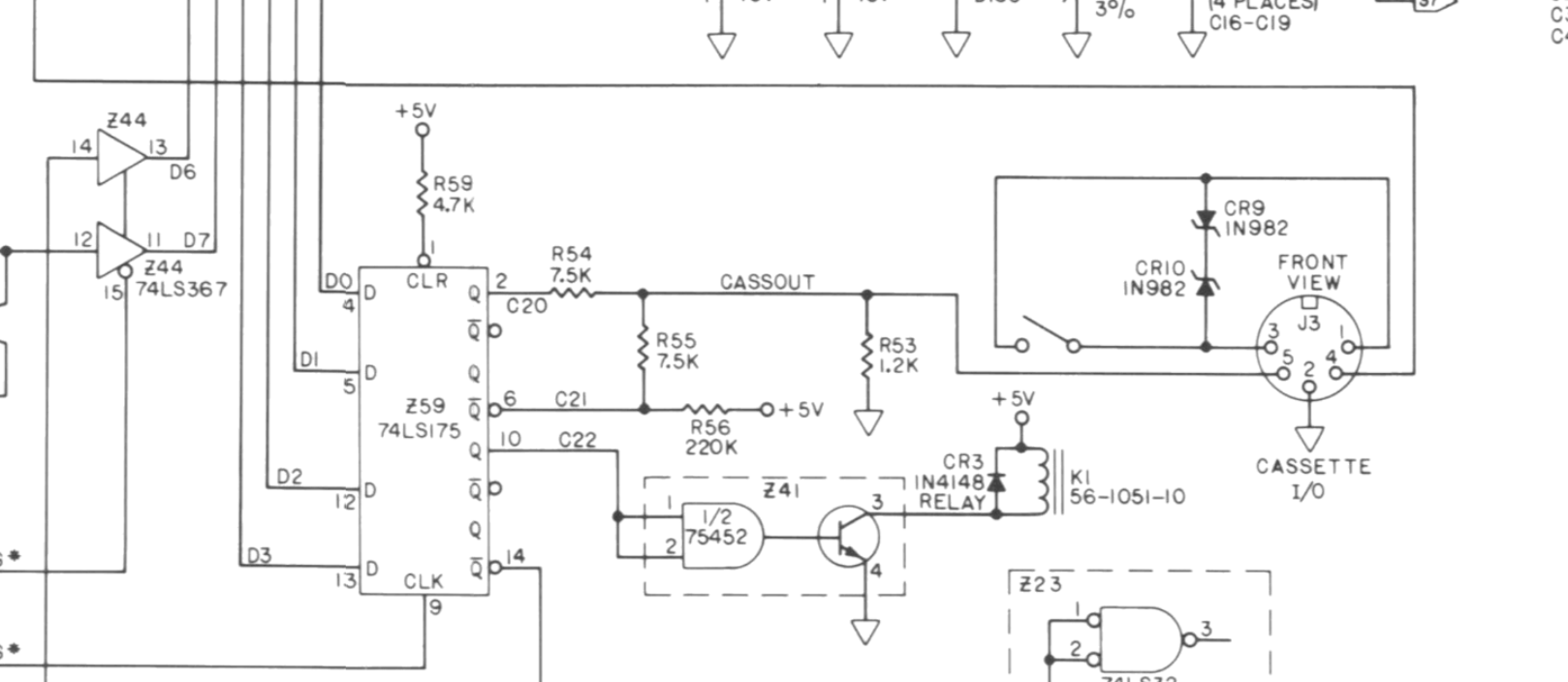

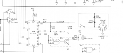

So i researched a bit and found a schematic of the TRS-80 Model I. I see there's a "cassette in" and "cassette out" circuit. Doesn't look like any special ICs were used. I'm trying to extrapolate the principles to understand the context.
Here's the source of my pics http://www.1000bit.it/support/manuali/t ... pdf%29.pdf
