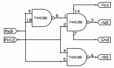

Some interesting design problems can arise with the use of RDY for wait-stating. Consider the following circuit, which is used to generate read and write signals for hardware that have separate /OE (output-enable) and /WE (write-enable) inputs:
File comment: Ø2-Qualified Read/Write Circuit
In studying the above circuit's logic, it can be seen that neither /RD (read data) or /WD (write data) can be driven low ("asserted") unless Ø2 (netlist symbol PHI2) is high, which is when the data bus would have valid content. That's all well and good—until the MPU is stopped with RDY. Although the MPU will maintain the state of RWB (high if reading, low if writing) while halted, the above circuit will "malfunction." Each time Ø2 goes low, /RD or /WD will be de-asserted, and when Ø2 goes high again, asserted. The potential for the addressed device to get confused by the oscillating /RD or /WD signal will be high.

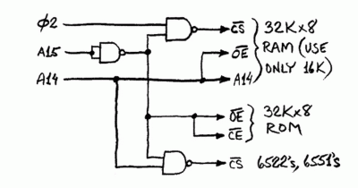

Another case in which trouble can arise is one in which Ø2 is used to qualify chip selects, for example:
File comment: Ø2-Qualfied Decoding Circuit
The above circuit was copied from Garth Wilson's website. Note the chip select (/CS) to the RAM, which is not asserted unless Ø2 is high and A15 is low. If A15 is low while the MPU has been wait-stated with RDY, that chip select will synchronously oscillate with Ø2, causing the RAM to be repeatedly deselected and selected.

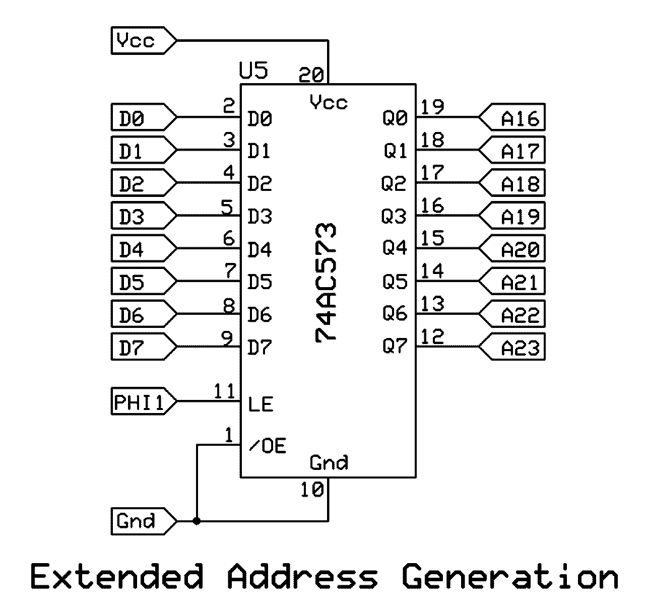

A third case that is specific to the 65C816 is the generation of the A16-A23 address bits, which appear on the data bus during Ø2 low. Here's an example generator circuit:
File comment: 65C816 A16-A23 Address Generation
During Ø2 low (PHI1 high), the eight latches in the 74AC573 octal D-type transparent latch will be opened, causing the Q outputs to follow the D inputs. Since it is during Ø2 low that the 65C816 emits the bank bits, the Qs will reflect the bank address. When Ø2 makes a low-to-high transition, the latches will close and the '573 will maintain the extended address on its Qs. At the same time, the 65C816 will cease driving the bank bits onto D0-D7 and instead will start treating D0-D7 as a data bus.
If after latching the bank address, the MPU is stopped with RDY, an unfortunate situation will arise on the next fall of Ø2. The '573 will open its latches, again causing the Qs to follow the Ds. However, the data bus at that time will reflect data, not bank bits, and when Ø2 goes high again and the latches close, A16-A23 will contain the data bus bit patterns, not the previously-captured bank bits, resulting in a wrong address being given to the system.

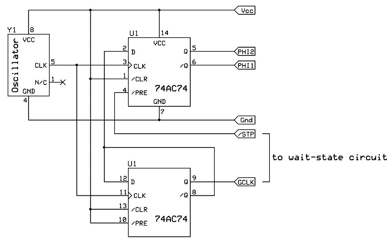

The basic Ø2 generator circuit I use is:
File comment: Basic Ø2 Clock Generator
This is a circuit I have published in the past. Both Ø1 and Ø2 are generated, Ø1 being essential to gating the extended address latch used with the 65C816—Ø1 is also used to gate a data bus transceiver that I am using in POC V2.2 as a level converter.
The 74AC74 flip-flop's /CLR and /PRE inputs are normally pulled up to Vcc, which causes Q to follow D on each low-to-high transition of the CLK input—/Q, of course, will complement Q. Since /Q is fed back to D, each low-to-high clock transition will cause the states of Q and /Q to toggle. Hence the output frequency at Q and /Q will be half that of the clock input.
When /PRE is driven low, Q will go high and /Q will go low, regardless of the states of CLK and D. As such a condition corresponds to when Ø2 is high, it's patent a continuous Ø2-high condition can be synthesized by sinking /PRE by some means. If that can be done at the right time, the MPU will be halted in the Ø2 high state, which constitutes a wait-state, as previously discussed.

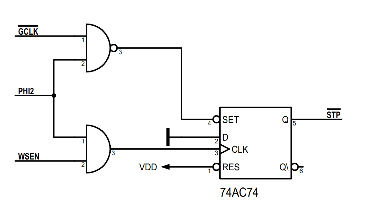

Wait-state timing is often produced with another flip-flop, such as depicted in the following circuit:
File comment: Discrete Logic Wait-State Timing Circuit
As can be seen, /STP ("stop") is driven by the flop's /Q. Normally, WSEN ("wait-state enable") is low, which means the output of the AND gate will be low, driving the flop's D input low as well. On each rise of Ø2, /Q will be driven high, if it is not already in that state. /STP will be held high and the MPU will execute instructions (note that /STP would be connected to RDY via a Schottky diode or a resistor to avoid contention when a WAI instruction is executed).
Driving WSEN high will start a wait-state by causing the AND gate to drive D high. On the next rise of Ø2, /Q will go low, /STP will likewise go low and the MPU will halt. With /STP low, the other input to the AND gate will go low, and the gate's output will go low as well, taking D with it. On the next rise of Ø2, /Q will go high again, ending the wait-state.

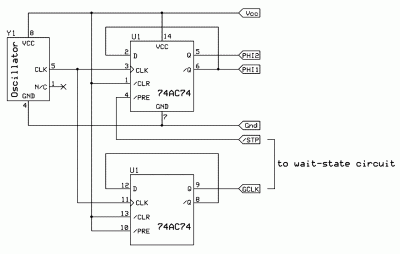

It is possible to harness this circuit to control the Ø2 clock generator driving the MPU, since its output is low when a wait-state is desired. To do so, a modified form of the basic clock circuit illustrated above is required:
File comment: Dual-Section Ø2 Clock Generator
In the above, the second section of the 74AC74 flop is pressed into service to provide a continuous clock signal to the wait-state timing circuit—this signal is designated GCLK ("global clock"). The first flop section's /PRE input is controlled by the wait-state timing circuit instead of being pulled up to Vcc. Due to the manner in which the timing circuit operates, /PRE will be pulled low when GCLK goes high following initiation of a wait-state. Hence Ø2 will halt when GCLK is in the high phase, assuming Ø2 was in phase with GCLK when the wait-state was initiated. When the wait-state terminates, which occurs when GCLK goes high again, /PRE will be driven high and Ø2 will resume.
It's patent that keeping GCLK and Ø2 in phase is crucial to achieving correct operation. The problem with the above circuit is it's conceivable the circuit could power up with Q of one flop high and Q of the other flop low. Should that happen, GCLK and Ø2 will be out of phase and when the wait-state timing circuit negates /PRE on the Ø2 flop, Ø2 will stop while in the low state and abruptly change to high, likely violating the MPU's timing. Contemplating this possibility led to me tinkering with the circuit to force the two clocks to stay in phase:

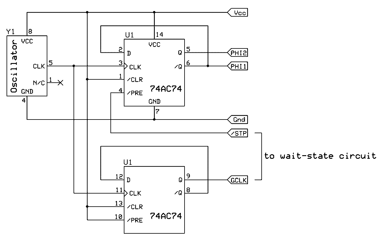

File comment: Modified Dual-Section Ø2 Clock Generator
In the above, the D inputs of both flops are driven by the GCLK flop's /Q. Since Q follows D on each rise of CLK, the two flops stay in phase, even in the case where one flop powers up in a state opposite that of the other flop.
Aside from generating the clock signal needed by the wait-state timing circuit, GCLK can be used to drive the Ø2 inputs of one or more 65C22s. Doing so prevents a wait-state from disrupting operation—for example, "stretching" the clock to a 65C22 would cause the timers to slow down for a brief period of time.

If you wanted to use RDY on a 65816 could you also qualify the '573s latch enable with RDY? or would there be timing issues with that approach?
Does the bank byte being corrupted explain the weird crashes you were experiencing?

Yes, in the case of W65C02 and W65C816 stretching Ø2 is probably the better choice than using RDY.
But I think there is one flaw in your /STP signal generator: WSEN requires to be valid [u]before[/u] the rising edge of GCLK (Ø2 is a typo me thinks). I assume WSEN is typically generated out of the address decoder. But then generating WSEN before Ø2 wents high becomes more and more impossible the faster you go.
Perhaps this might work (untested):
Here Ø2 & WSEN generates a trigger for the FF that causes /STP to become valid. This should cause Ø2 staying "1" while GCLK is regularly clocked to "0". As /GCLK & Ø2 now being "1" the FF is preset to "1" so /STP is released but Ø2 stays unchanged until two further clocks of the main oscillator.
Such an arrangement likely wouldn't work. The problem is that the '573's LE has to be kept continuously low after the bank has been latched. RDY would only be low for the duration of the wait-state, which means using RDY to qualify LE would result in LE going high immediately after the wait-state has expired.
I don't know at this time, but do have my suspicions.

But I think there is one flaw in your /STP signal generator: WSEN requires to be validbefore the rising edge of GCLK (Ø2 is a typo me thinks). I assume WSEN is typically generated out of the address decoder. But then generating WSEN before Ø2 wents high becomes more and more impossible the faster you go.
Both the 65C02 and 65C816 generate the effective address while Ø2 is still low. Assuming the glue logic doesn't have excessive propagation delay, there would be sufficient time to assert WSEN before the rise of the clock. If timing is tight it's a good time to ditch the discrete logic and use a PLD.
It appears it would work, although more gates would be required.
Taking the damned DS of the 65C816 tADS is 30 ns for A0:A15 and 33 ns for A16:A23 (tBAS). Cycle time is 35 ns. This would left 5 or 2 ns to setup WSEN. Of course, these are worst case timings but wasn't it you that would go to 20 MHz or more if possible? :wink:
... although more gates would be required.
100% ACK :)
