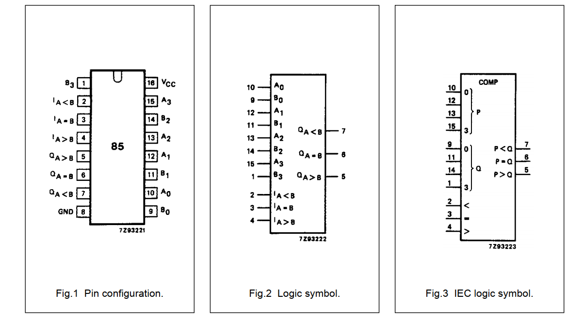

In short, in general treat chip-select lines as address logic, and wire address decoding logic to them; treat output-enables and write-enables as control logic, and wire clock-qualified control signals to them.

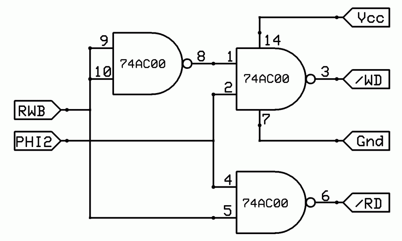

This is exactly what needs to be done. Use the /OE and /WE qualifier given from the schematic of BillO's post (near the top of the page):
BillO wrote:
Connect /WD to RAM /WE.
Connect /RD to both RAM and ROM /OE.
As your memory map requires only 3 select signals /CE_RAM, /CE_ROM, and /CE_IO you may use a 74HCT85.
74HCT85.pdf [69.99 KiB]
Downloaded 157 times
It is a 4 bit magnitude comparator.
If you setup the B inputs to $B while feeding A15..A12 to the A inputs and set inputs A<B, A>B to 0 (false), A=B to 1 (true) then the output signals of the comparator would match your address map - you only have to invert them to be low when valid. A<B would become true if A15..A12 are $0..$A => RAM. A=B is only true if A15..A12 = $B => IO. And if A15..A12 are $C..$F the output A>B is true => ROM.
It is pretty slow. I takes roughly 50 ns to do its job. This is no problem for RAM or ROM. But you have to verify what the requirements of your I/O device is. Many 65xx IOs require chip select to be valid a lengthy period before the rising of PHI2!
If you have slower RAMs and/or ROMs (e.g. 55 ns or 70 ns types) use them instead of the fast ones.

BillO wrote:
You should seriously attempt to incorporate the 'reference design' that has been shown here for /WE and /OE (/RD).
This is the approach I use myself. But it's not the only acceptable way.
failing to qualify /OE with Phi2 could easily lead to glitches on the RAM output.

BillO wrote:
Monochrome version on schematic for BDD.
ps- I took the diagram and compacted it a bit. Dunno if I succeeded in making it more readable, but FWIW here it is!
Saved by the Canadians! :D Now I can read the schematic.
It seems to me that since RAM is in contiguous space, as is I/O and ROM, judicious use of 3-8 or 4-16 decoders might substantially reduce the number of gates delays incurred in generating chip selects. In particular, there are four gate delays to the RAM's CS2 input, which even with 74AC logic would be quite slow. I am suspecting that the total delay to CS2 is skewing the RAM's selection too much relative to the clock. This would be particularly problematic during read cycles, as the 65C02 has fairly strict timing requirements in order to assure a valid read.
As often noted, chip selects should not qualified with Ø2, especially if there is any desire to run the machine at a high clock rate. This seems to be a common 6502 design "feature" in home-built equipment, one which puts needless constraints on performance. Chip selects should solely be the product of the address bus state. The reason why becomes evident when the 65C02's machine cycle is considered (timings assume five volt operation):
  • At tADS, the address bus will become valid. tADS is 30ns maximum after the fall of Ø2. This is when chip selection should be made. The address bus will remain stable until tAH, which is 10ns minimum after the next fall of Ø2. Not stated by WDC is the maximum for tAH, which will be something less than tADS, since the 65C02's internal gates cannot instantaneously change state. Timing calculations on tAH should assume the 10ns minimum.
  • During a read operation (RWB is high), the 'C02 will sample the data bus at tDSR, which is 10ns minimum before the fall of Ø2. Any data bus gyrations that occur prior to tDSR are effectively ignored by the 'C02. Once tDSR has been reached, the data bus must be settled and must remain stable until tDHR, which is 10ns minimum after the fall of Ø2. The device being read by the 'C02 must drive the data bus for at least tDSR + tDHR if the 'C02 is to read valid data. Furthermore, that device must continue to drive the data bus until tDHR has expired.
  • During a write operation (RWB is low), the 'C02 will drive the data bus at tDMS, which will be 25ns maximum after the rise of Ø2. The 'C02 will continue to drive the data bus until tDHW, which is 10ns minimum after the fall of Ø2.
Late (relative to the clock) chip selection may result in the 65C02's timing requirements not being met. Gate delays in the chip selection glue logic in themselves may cause problems, but definitely will exacerbate the situation if selection is qualified with the rise of Ø2 In such a design, selection may not occur until late during Ø2 high, and if during a read cycle, may result in the 'C02 reading garbage because the device being accessed did not drive the data bus during the tDSR + tDHR timing "window."
Using Ø2 to qualify chip selects is, in my opinion, questionable design practice. Where Ø2 should be used is to qualify reading and writing, using the circuit previously presented (repeated below), or a variation thereof. An exception is when 65xx I/O hardware is used, e.g., 65C22 or 65C51, in which case read/write must not be qualified by Ø2 and furthermore, chip selects must be valid before the rise of Ø2.
File comment: Fully Qualified Read/Write Logic

- I will connect /OE to a NAND which has R/W and Phi2 as input
- I will connect /WE to a NAND which has inverted R/W and Phi2 as input. This will introduce an extra gate delay of course (currently direct connect to R/W)
So that will bring my decoding in to line with the core principle of letting address select the RAM, and then Phi2 with R/W select read or write. Except for the ROM - I don't see this where my problem lies though.
