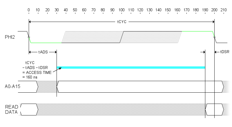

That 70ns RAM should easily handle 5.36 MHz.
The 65C02 generates a vaid address roughly midway through Ø2 low.

I wrote:
tADS remains constant, but the midway point of the Ø2 low period changes according to the choice of clock speed
