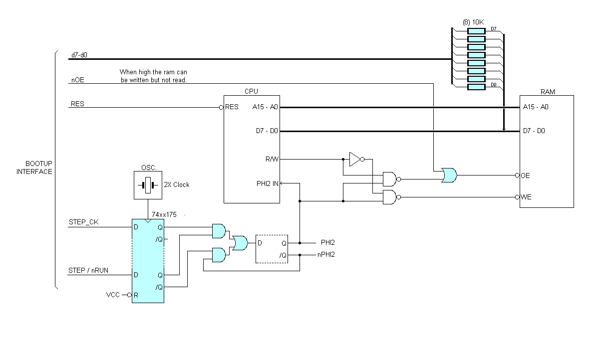

PostPosted: Wed Jan 10, 2018 6:27 am
Here's one possibility for wiring in regard to that code-fake trick (details in the previous post). This is more or less what I used for a test computer I threw together recently. (Working title: "Throw-Together Computer." I've really got to come up with a better name! :oops: )
This drawing is of the skeleton, so to speak, with a lot of detail stripped off. The glue logic in TTC includes a triple SPDT mux/demux, which is fast and compact. But for reference I've added an equivalent drawing without that feature.
In both drawings all the components pertaining to the code-fake aka bootup interface are shown with colored shading. Not a lot to it, really. And it also gives single-cycle capability.
It'd be easy to make a ROM-less 65xx system by attaching this setup to a (fairly) low pin-count microcontroller. But in TTC's case the attached device is a UART-ish CPLD contraption that never transmits, only receives. In other words, a UAR. :wink:
I used 10K resistors to connect the 65xx data bus to the attached device, mainly because that's a foolproof (also quick 'n dirty :twisted: ) way to prevent excessive current from bus contention! During bootup the attached device generally keeps the nOE signal high, which during read cycles means the RAM can't drive the data bus. The CPU is still able to do so, however, as happens anytime there's a write. No extra logic is required for this. Always at the correct time the CPU automagically overrides any opinion expressed by the 10K resistors! But on read cycles the resistors prevail as the default bus master.
The resistors offer an additional benefit in cases where the attached device is not physically nearby. Because of potential ringing problems it's undesirable to directly extend the 65xx bus. But the resistors don't constitute a direct connection (nor even series termination as might be used with a transmission line, which this isn't). Just be sure to locate the resistors at the 65xx end of the extended bus.
One slight drawback is that the resistors necessitate rather slow bus cycles (ballpark one microsecond, depending), but it's easy to go that slowly -- and yet be acceptably fast -- by single-cycling. One final caveat: Only high input-impedance chips (eg, NMOS and CMOS) may connect to the data bus. The resistors wouldn't be capable of driving any TTL or LSTTL loads.
File comment: the same logic but not using a mux/demux

Many thanks for the idea & detailed explanation :). I'll have a think. BTW couldn't you replace the resistors with bidirectional octal buffers? Maybe with the dir pin hooked up to the RWB pin of the 65C02? Was thinking that this would prevent prevent contention and also reduce capacitance on the bus?
PostPosted: Sun Jan 14, 2018 1:16 am
There are various ways the idea could work, but the key point is not having to attach to the 65xx address bus. This eliminates 16 connections which otherwise would have to be controlled by the attached device. (For an '816 it might eliminate as many as 24 connections. :shock: )
For my own project I only need a boot-loader, so it's all about writing to RAM. But, as noted, reading is also possible, and likewise operations on the 65xx's I/O devices.
Yes an octal buffer could replace the resistors, but in most scenarios resistors are actually better. The buffer would add more capacitance than the resistors do, and resistors don't have any control signals (OE, DIR) that need to be administered. Not so with a buffer. Also (re control signals): if the buffer is used bidirectionally then remember you have to mind your P's and Q's re contention with the attached device (as well as contention with the 65xx bus, of course).
The resistors side-step all of that -- at a price in speed (due to the RC delay of driving the capacitance of the 65xx, the RAM and peripherals). If a buffer were used then the RC delay would almost disappear. But then the onus for speed would be on the attached device. Unless it's fairly nimble you wouldn't actually be able to accelerate things much (compared with using resistors).
If there aren't many bytes to move then the overall time may be quick even though the rate is slow. Perhaps there aren't many bytes in the intended application. Or perhaps all you need is enough to fire up the Level Two Loader -- one that's a lot faster and more capable. Even if you do opt for a bootup that's quite slow overall it may be an acceptable tradeoff.
PS: if the resistors were replaced with a bidirectional buffer it unfortunately would not be feasible to drive its DIR pin from RWB of the 65C02. The only time you'd want to DIR to reverse is when data travels from the 65xx system to the attached device -- and that never happens except in the final cycle of the four-cycle ditty for reading RAM. But the ditty is just a LDA absolute, and the CPU treats all four cycles as reads.

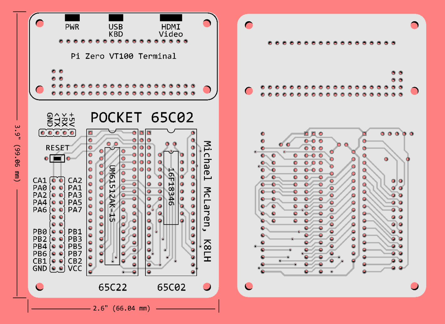

PostPosted: Tue Jan 16, 2018 4:31 pm
Posts: 588
You can also take control of the 65xx's I/O devices, since they read and write in the same way as RAM. :!: You could arrange to copy bytes from RAM to a UART, or vice versa -- IOW, a level-2 bootloader. Initializing the UART isn't a problem because that too can be faked with the cycle-by-cycle technique.
In fact, except for conditional branches the code-fake thing can do pretty well whatever you want! :mrgreen:
Bingo! As you mentioned, it's possible to extend the capabilities of a "blind loader", as I call it, to effectively have full "ROM Emulator" capability in 64K RAM-only system designs. That is, you could implement a "blind monitor" with memory view/edit, memory move, mini-Assembler, mini-Dis-Assembler, x-modem, flash, single-step, and go commands that doesn't require or take up any 65C02 address space.
Imagine, no more burning E/EPROMs as you develop and test your operating system code. Simply enter the "blind monitor" at startup and transfer your code via the 65C02 serial hardware into RAM (or use the mini-Assembler), issue "go" or "step" commands to test it, and use a "flash" command to copy it as a pseudo ROM image from RAM into microcontroller flash memory. Thereafter you would normally go directly into 65C02 operation with your monitor and operating system code in RAM after the "loader" operation, or you can choose to enter the "blind monitor" at startup.
All this capability using as little as 11 pins (8 data, 1 clock, 1 reset, and 1 RAM or Decoder enable) plus one pin on the microcontroller for a reset switch input. Coincidentally, these are pretty much the same eleven pins you identified long ago in this boot-loader post.
While I don't believe this is exactly what Mike (banedon) is looking for, I hope it provides some useful insights. I hope to order a PCB or two (examples below) to test this method more thoroughly in the near future.
Cheerful regards, Mike, K8LH

PostPosted: Sat Jan 27, 2018 1:39 pm
Posts: 588
Should we start a different thread? Do you think anyone else would be interested in this discussion?
Some very intriguing ideas here, Michael, especially the part about commands that don't take up any 65xx address space. It means even a tiny system could have an expansive set of commands available. 8)
I'd love to try this method for a Tiny-BASIC computer using a CMOS 6504 (below), an 8K RAM, and a 65C51 or 63B50P ACIA. If you need a very small PCB you could place the narrow micro-controller and 8K RAM chips under the wide socketed CPU and ACIA chips.
