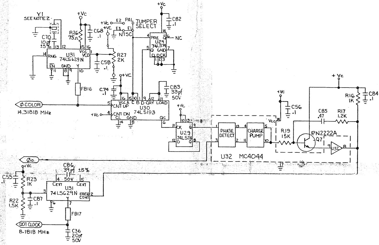

For supporting the C74 project, I felt a need to post something about how clock generation in the C64 works.
First, a picture of the clock generation circuitry taken from a C64 schematic (1982 ?).
Before 1984, a PLL like in the picture was used for generating the dot_clock.
(Looks like this circuitry was replaced by a 8701 clock generator chip in 1984.)

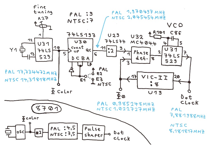

A block diagram of the PLL clock generator:
How it works:
U31 (74LS629) contains two VCOs (voltage controlled oscillators).
One VCO of U31 works as a crystal oscillator, generating the color_clock.
U30 (74LS193) works as an up_counter and divides down the color_clock by 9 (PAL) or 7 (NTSC).
A D_flipflop from U29 (74LS74) divides the U30 output by 2 for getting a neat symmetrical square wave.
The result is the _reference_ for PHI0.
The other VCO from U31 (74LS629) generates the dot_clock, which is divided down by 8 in the VIC-II for generating PHI0.
U32 (MC4044, now out of production) compares the PHI0 _reference_ (generated from the color_clock)
with PHI0 (generated by that VCO and the VIC-II), and is supposed to change the input voltage of that VCO
until PHI0 and the PHI0 _reference_ match.
BTW: the other D_flipflop in U29 (74LS74) is abused to work as an inverter for generating the constant of that U30 (74LS193) divider.
74LS\HC\HCT\AC\ACT74 datasheets don't explicitly state whether the /PRE or the /CLR input of the flipflop has higher priority,
better don't try such tricks at home, kids.
Some background info about what a chrominance subcarrier is and why it has this odd frequency can be found on Wikipedia.
For the C64, I think the calculations look like this:
PAL:
chrominance_subcarrier = 4.43361875MHz
color_clock = chrominance_subcarrier *4
dot_clock = color_clock *2 /4.5
phi0 = dot_clock /8
NTSC:
chrominance_subcarrier = 3.57954545MHz
dot_clock = color_clock *2 /3.5
phi0 = dot_clock /8
Would like to mention, that the crystal might have a 50ppm tolerance or such.
I guess that quite some hobbyists wanted to measure the frequencies in a C64 by using a frequency counter,
and if the last digits of the frequencies are a bit different in the one or other text found in the internet,
please just ignore it and blame those tolerances...

The original prototype had independent clocks for colour and dot/system, but that led to shimmering patterns on the screen. The PLL circuit was thrown in at the last minute before production, to keep the phase relationship between them constant.
The story goes that one of the chips (the 74LS629 I believe) was only manufactured by TI, and TI's home computer was one of the C64's competitors. Tramiel was not happy about this, and demanded that something be done. Since Commodore had a pet silicon foundry, they could just drop the whole function into a custom chip. That's where the 8701 came from.
If you look closely, one half of the 74LS74 is being used in a very strange way. 1CLK and /1CLR are both grounded, so the output on 1Q should always be 0. But it happens that /1PRE overrides /1CLR. If /1PRE is low, then 1Q goes high. If /1PRE is high, then /1CLR takes over and 1Q goes low. It's being used as an inverter. Yes, I did spend hours poring over that schematic when I was a teenager.
This circuit goes inside the shield containing VIC, and they already had half of a 74LS74 in there for dividing the clock. Abusing the other half like this saves adding another chip.
