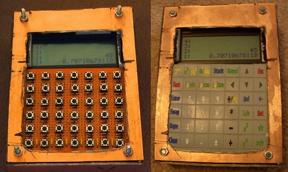

I had really good luck etching with a laser cutter into stamp rubber and putting that over a keypad.
I want to make something smaller though, so I don't think that will work this time. I noticed that the square Omron caps are only 4x4mm. Not sure why 6x6mm square caps are so hard to find...

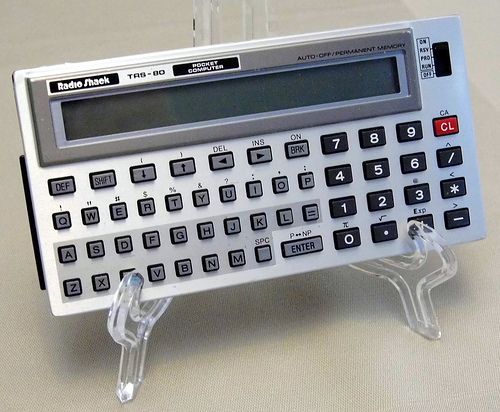

There were various calculator and pocket computers with that size of keys, and although bigger keys are nicer, these didn't look that bad. This is one of the Tandy ones from about 1980 or so:
 Post subject: Re: Button caps
PostPosted: Thu Oct 26, 2017 5:26 am
Posts: 365
Ya, that is really neat. I used to be fascinated by those old handhelds and I added a PB-2000C to my collection at one point but eventually sold it. It was one of the coolest machines I ever owned.
I would love to make something with a keypad like that but I have no clue how a hobbyist would go about it.

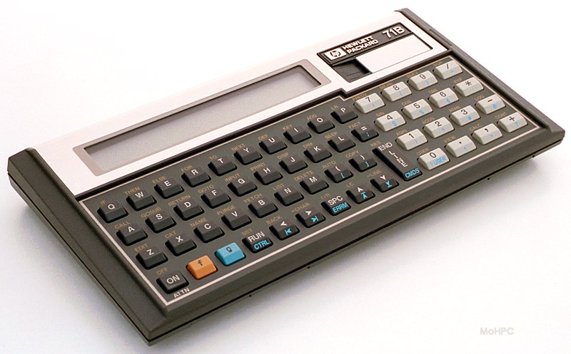

I hope that eventually the price will come down like PC boards have, to where they're quite practical now for hobbyists to get their own made. Just imagine double (or triple)-shot keys, and bezels with rectangular cutouts, and lexan overlays, all with set-up costs that are just pocket change, so you could do this kind of thing very inexpensively:
The keys on that thing have a wonderful feel, BTW! This hand-held computer was way, way ahead of its time when it came out in the 80's. I have two of them.
Yea, you need more than just keycaps to make a good keypad/keyboard. HPs were some of the best.

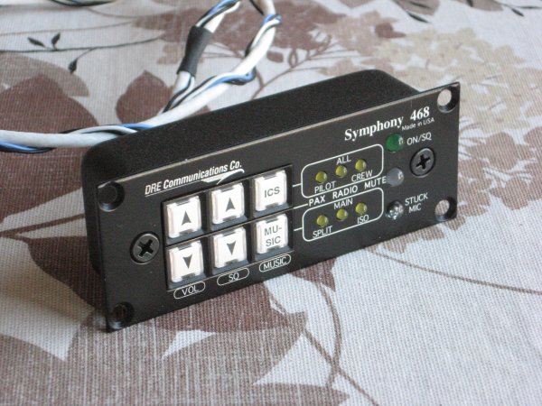

Those look similar to the Grayhill 87 series keys which are somewhat attractive, not the most attractive, but you can put your own labels under the transparent keycap. The data sheet is at http://www.mouser.com/ds/2/626/Keypads_87-334536.pdf . I've used them in a few different things like the in-house 6502-powered automated test equipment in 1990 (where I did not make my labels look particularly neat):
the control head for a later product in 1993,
