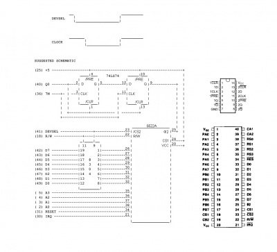

The Apple II slots are missing Phi2, but Apple had published a TIL (no: 494) in the past regarding the 6522 ICs and provided a (simple) schematic to re-create the Phi2 from Phi0 (which is available on the slots).
The TIL can be found here.
This is what I use(d) for my own projects which need Phi2

Thanks, Uncle Warthog and xjmaas for directing us to the Apple document.
Last night I was looking at the schematic that's provided, and decided to fill in some of the missing detail. Instead of just pin numbers I added the signal names on the flipflop and in a few other places. FWIW I'll share that now.
According to the Apple doc, "The 74LS74 circuit delays the positive edge of the clock by one cycle of the 7 MHz clock," but to me it looks as if the delay will be "at least one cycle" or perhaps simply two cycles. But it probably doesn't matter.
Garth's circuit is a reasonable alternative to this one, and his analog delay is more easily tweakable. OTOH there's something to be said for the digital approach, which presumably won't require tweaking.

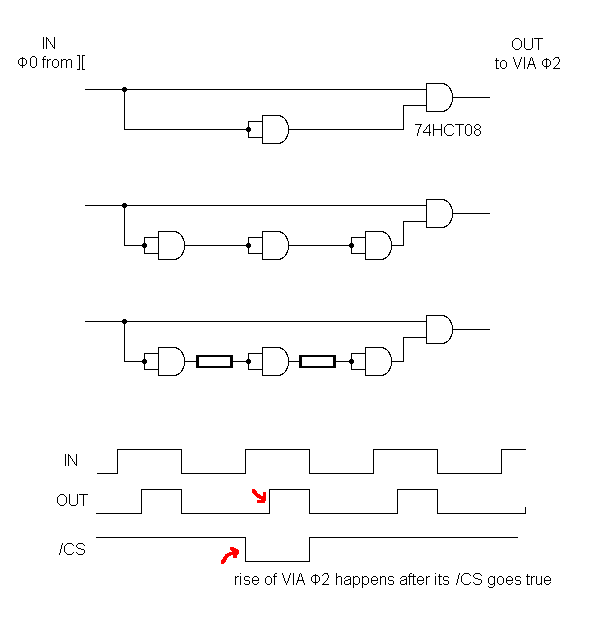

Maybe I'm stating the obvious, but ideally what we want is to delay the rising edge of the signal at the VIA's PHI2 input and NOT delay the falling edge. IOW we'll distort the duty cycle somewhat, making it less than 50:50. The Apple circuit accomplishes this using a clocked flipflop for delay, and Garth's circuit uses a variable analog delay.
Here are some variations of another analog delay, but using propagation delay instead of an RC. Actually the version with resistors uses RC, too, with C being the input capacitance of the gate. If each resistor is 1K then each will add about 10ns, ballpark. But I doubt you'll need any resistors at all.
BTW is it a WDC 65c22 you're using?
