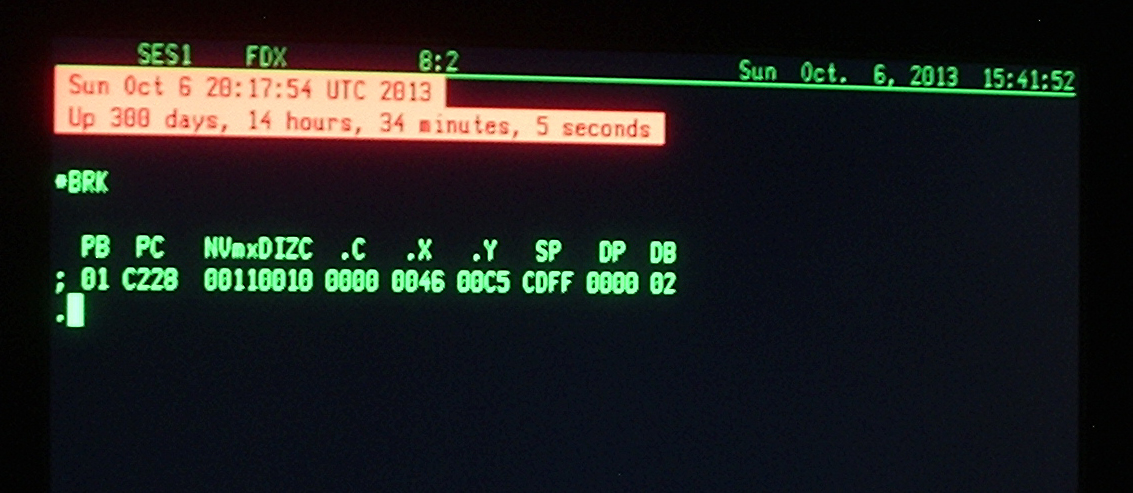

When I built POC V1.1, I used an SOIC-24 version of the MAX238, as well as an SOJ-32 SRAM, both with 50 mil pin centers. I dragged-soldered these parts, which subjected them to considerable heat for about 12-15 seconds per side. Adding insult to injury, I then used desoldering braid to clean up my handiwork, adding more heat to an already hot part. Yet, I have experienced absolutely no problems with the computer, which has exhibited excellent stability. In fact, and as Garth pointed out, POC V1.1 ran 24/7 for over 300 straight days without being rebooted. That's nearly 8000 continuous operating hours.
300+ Days of Uptime
