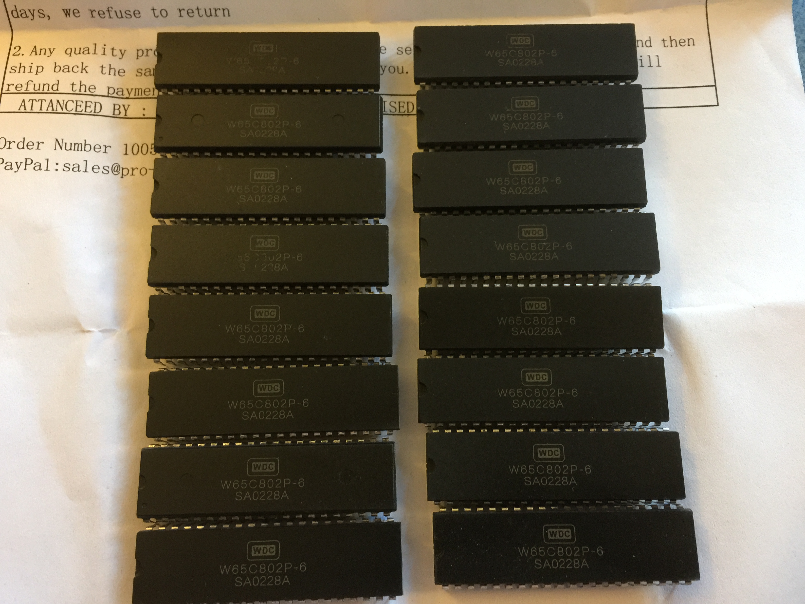

 Post subject: Re: 65802 anyone?
PostPosted: Fri Nov 24, 2017 3:17 pm
Posts: 996
Location: Berkshire, UK
These arrived today. 16 WDC 65C802s. I'll test them out on my three chip board when I've sorted out the new firmware.
