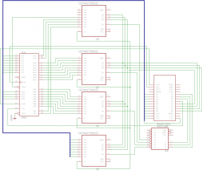

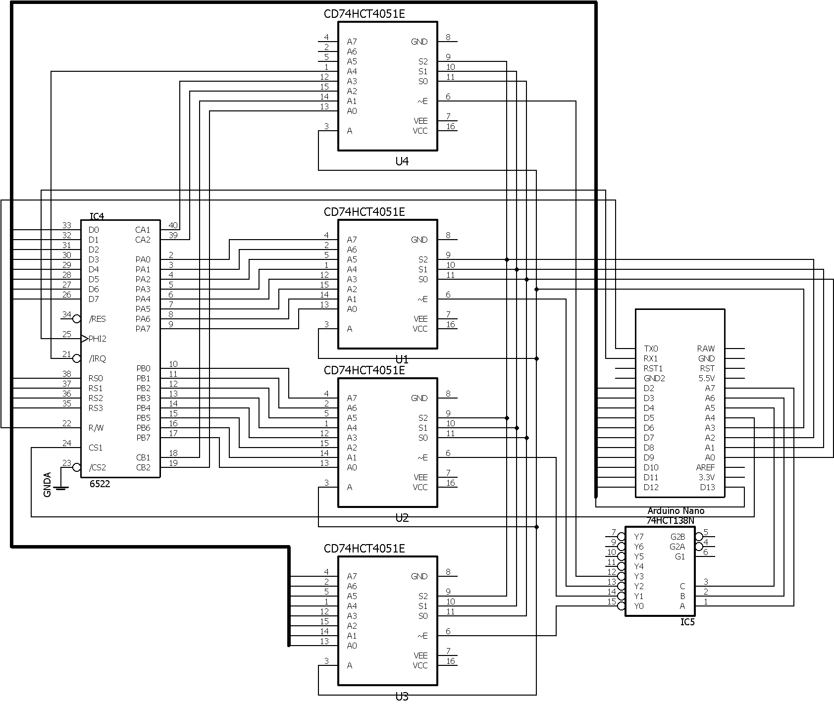

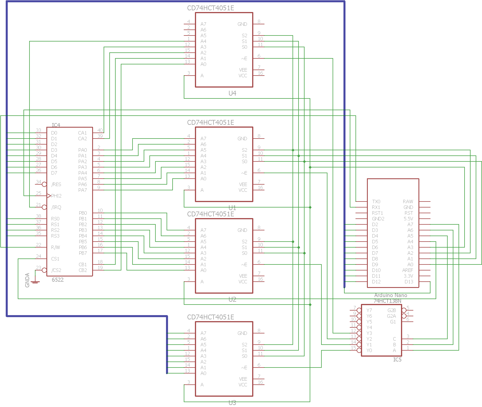

I need to test some 6522 chips and after some discussion I droodled down this schematic:
and in monochrome
The basic idea is that I want to test its functionality, but also record the waveform of the different outputs to see that the chip is "within spec" or what parts of the chip that is actually such.
If you have any feedback on testing of such chips (or experience) I would like your comments/idea on this.

Could you please post that in monochrome?

Also, does your Arduino logic observe the requirement that the 65C22's chip selects and R/W be valid before the rise of Ø2?

In my first build with a '22 though, I got tripped up by the very thing BDD is saying. The chip selects and R/W have to be valid and stable before Φ2 rises. IOW, you can't use Φ2 to gate the chip selects.

I'm not familiar with the Arduino, but it looks like you have the Φ2 input of the '22 connected to an input on the Arduino. Hopefully that pin can be an output too and you're using it that way.
It would be a good idea also to send a signal to CS2\ rather than just grounding it, to make sure it really works.
Thanks for the monochrome diagram. I don't have color-blindness problems like BDD (I think he said the light green is almost invisible against the white background), but that light-gray writing labeling the pins is awfully hard to read. Eagle apparently allows you to change the colors, but I wrote to them and asked them to supply it with defaults that are easier to see.
