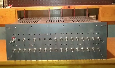

Several years ago I had started a project very much like this. I don't know that I'll ever finish it though; I have no time to devote to it. The only part I did finish is the most trivial: the rack mount case and front panel, hardware only. I wonder you'd be interested in what I have.
