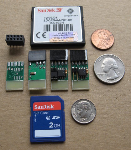

I have my first run of SPI-10 boards made, the revision per the final spec (two posts up) of the flash memory module for W25X40CL, 25VF016, 25VF032, 26VF032, 25VF064, 26VF064, CY15B104Q, or any other SPI flash ICs in narrow or wide SO-8 packages with the same pinout. (The 32's are four megabytes, and the 64's are eight.)
Here in the picture are:
  • upper-left corner: the dual-row socket, stood up on end (neither keying position blocked yet)
  • center-left: bare board, top
  • next to the right of it: a completed assembly, bottom side (showing 1206-size 0.1µF bypass capacitor)
  • further to the right: two completed assemblies, top side, with labeling area still blank, one with and one without the shunt on the 90° 2-pin header for write-protect
  • top center: CF (Compact Flash) card for size comparison
  • bottom center: SD card for size comparison
Granted, 4MB or 8MB is very little storage compared to what comes in CF of SD cards; but it's a lot for a 6502 system where you won't be storing and watching videos or doing photo editing and probably won't even be listening to music on it; but the home-made modules are much easier to work with in terms of writing your own software drivers, and also a lot cheaper than the standard consumer-electronics memory cards. You can make your own file system, or use them with no file system at all (as in my first use of one, for recording audio, in a loop). They are not as small as microSD.
For my own use, I might coat these in epoxy again for protection. Or maybe not.

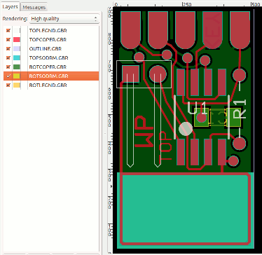

Here's a screenshot from the gerber viewer. It does not show the holes, but does show the copper layers, soldermask, etc..

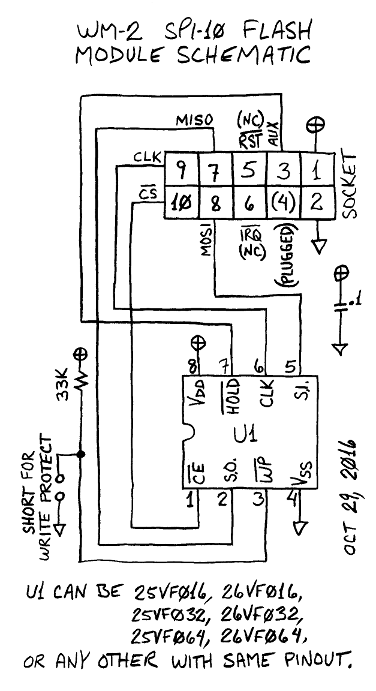

and here's the schematic. The socket is viewed from the back, not looking into the holes. It's like looking into the pins it plugs onto.
I got 264 boards made at a super low price, obviously far more than I have any personal use for. I'll make them available to others. The price of the bare board will be well below that of the IC, probably even including shipping if it's to U.S. addresses. As for selling pre-assembled units: The amount of assembly time required is fine for small quantities for personal use, but if I assemble them for others, I'd probably need to charge more than they will want to pay; so I might just sell the bare boards, with an exception for the few customers who can't see well enough to assemble one, or have other limitations. I still need to figure out the details, which I plan to apply to more future boards as well. Input invited.

If I understand this it is basically a breakout board that adapts a SOIC-8 to your socket spec. It includes a decoupling cap and possibly a 3.3 volt regulator?

Yes, it adapts the flash chip to the socket spec, and can be swapped out in a second or two.
I just added the schematic to my post above. There's no regulator on the module. This one is for 3.3V SPI-10. One of the holes in the socket (when assembled) is plugged to keep it from getting plugged into a 5V SPI-10 port. The spec (above, four posts up) shows either pin 3 or pin 4 of the port cut or removed on the master, for 5V or 3.3V, respectively. One of the goals was to keep the modules really simple, in order to reduce the size, cost, and assembly time so it's practical to build up many different modules for different uses; so rather than burdening every single module with voltage-translation circuitry for the signal lines, the master has separate SPI-10 ports for 3.3V and 5V, and the master has the voltage-translation circuitry if any is needed. If you only expect to use one voltage, there's no need to have ports in both voltages; and if the voltage you want (like 3.3V for the flashes which are not available in 5V and the master works at the same voltage, there's no need for voltage-translation circuitry at all.
