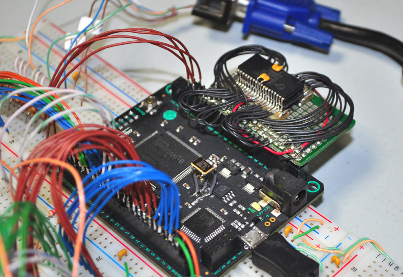

The target is a Spartn-6 FPGA, and the "donor" board was once a Mojo-FPGA Board. I say donor because I hacked it all to hell. The Mojo board is a great FPGA board, by the way!
I needed a meg of SRAM, so I dead-bugged a pair of 512K SRAMs to the board, and then replaced the oscillator with a 20MHz clock.
The FPGA is clocked at 40MHz, and does some real trickery when it comes to sharing the SRAM with 6502, Video, Sound, and GPU.
The 6502 thinks it is just connected to a super fast 64K SRAM, and the FPGA does all the boot load stuffing and IO magic.
I am also working on some SD Card code to load everything on startup, but for now it is all done via SB cable.
The FPGA version actually has more power than the breadboard version, since it is easy to add features in code.

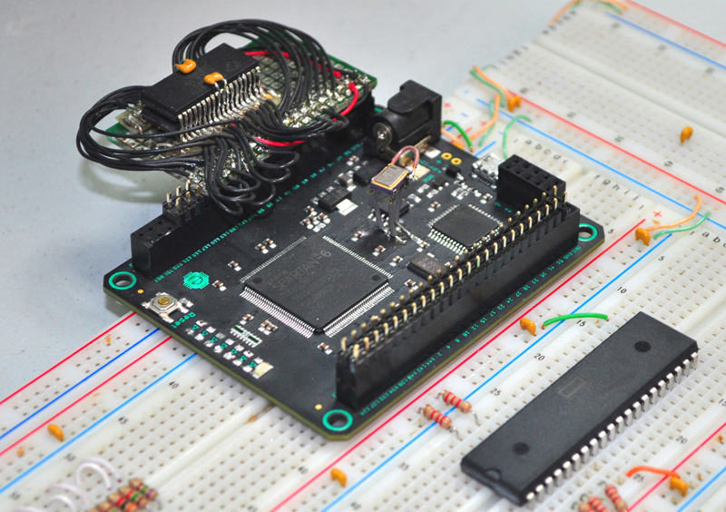

This was once a MOJO Fpga board.

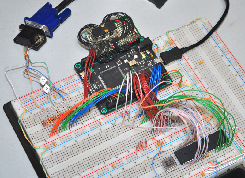

To gain the required 98 IO pins, I desoldered all of the onboard LEDs and made a new IO map.
I also ripped up the oscillator and added a new 20MHz version.
This is doubled internally by the PLL to meet the 40MHz timing for 800x600 VGA.
A pair of 512K 10ns SRAMs added.
Everything is shared by the 1 meg of onboard memory, arbitrated by the FPGA.
Zero page and IO live internally in code, but everything else is in SRAM.
Graphics Data, Sound Data, 6502 Code, and dual Video Buffers all take tuns!
6502 and Video DAC
The 6502 has no idea that it is connected to an FPGA!
I have tested the 6502 up to 8MHz, which is the "legal" top speed for 3.3v operation.

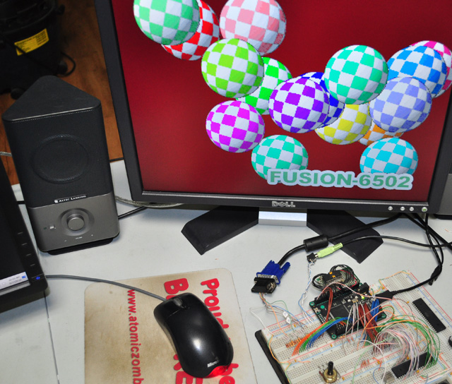

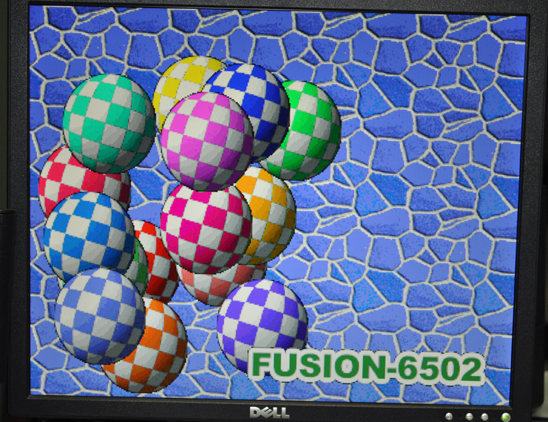

It's those damn checker balls again!!
Yeah, what can I say... I like watching those checker balls fly around the screen!
This time they are multi-colored thanks to the abilty to rotate the color palette on the fly.
I only have to store one 32 color ball sequence, and can rotate the dark panels 16 times.
These ar 80x80 sprites with 256 color depth, and one invisible "alpha" color.
Fusion-6502 can hurl over 30 of these around the screen at 60 frames per second!
For comparison "Boing" on the Amiga only did one ball, and it was only color cycled.

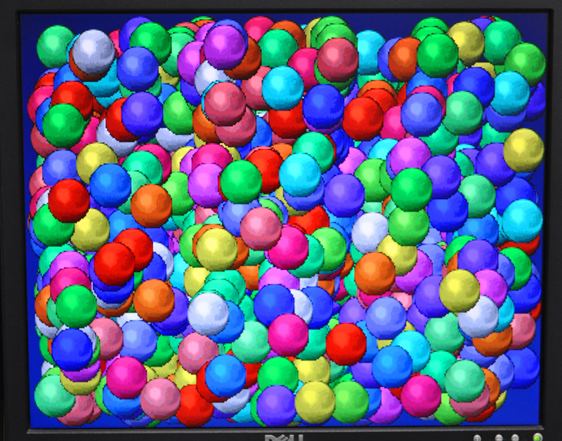

Back in the 80's, after staring at a wavering 12 inch NTSC monitor for 5 hours, I finally made 8 sprites move across the screen on my C64.
They were only 12x21 in size with 4 colors, but it was cool to finally see them come to life.
32 years later, I have made another 6502 powered Sprite Test program.
This time, I managed to move 1000 Sprites of 32x32 size and 256 colors!...
1000 Sprites equates to 1,024,000 8 bit pixels!
Actually, the full number is over 1000, but I can't remember by how much.
I just stopped adding 10 at a time right before the frame rate dropped under 60 FPS.
Here is a video...
https://youtu.be/GrsY4SpFpHs
This test is actually demonstrating the Sprite Palette Color Remapping function inside the FPGA.
What I did was store only a single 32x32 ball sprite using 16 shades of color.
The 6502 then commands the GPU to shift the pallette by 16 steps for each sprite draw.
