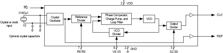

There are many solutions on the market for problems of this nature. The ICS525 is one I've used myself, purchased from Digikey. It contains both a multiplier and divider, which in combination can produce all sorts of odd ratios.
The problem is that there is nothing in the documentation that states whether the clock will actually start in the same phase (although I hope it will).
Can you be more specific about what you're trying to accomplish? Perhaps one of the other ICS series chips would be more appropriate.

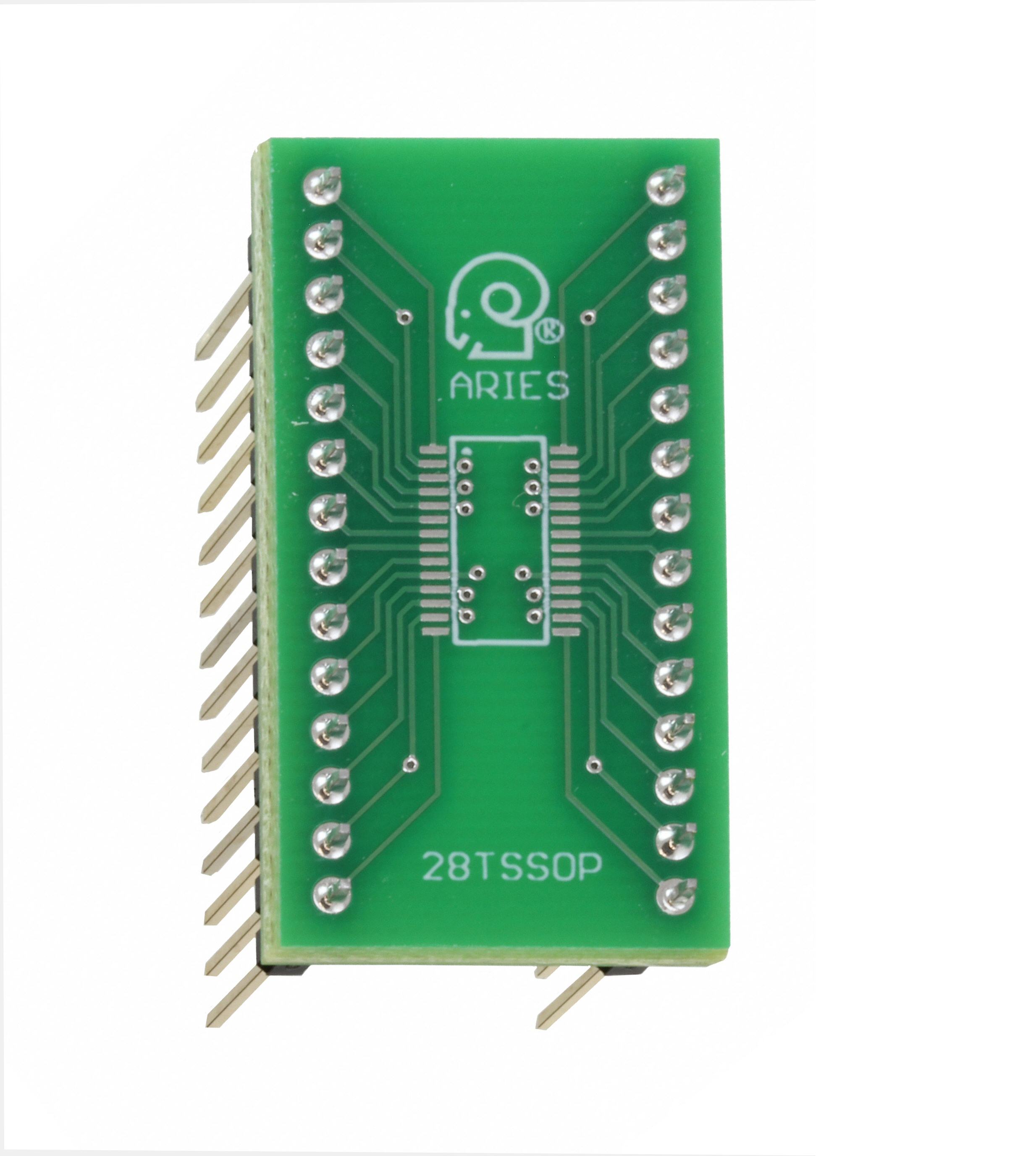

The adapter is a separate product, also from DK.
