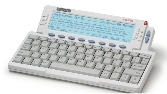

Yeah, bit-banging for basic I/O is not, shall we say, an optimal solution.
Anyway, buying an inexpensive keyboard and taking it apart isn't a bad approach, but it might require some work, as a lot of keyboards just run the matrix lines right into the on-board controller. You could probably still hack it up, though.
Alternatively, if you don't need a specifically PC-style layout, the Landel Mailbug "email appliance" has a rather nice little compact keyboard that has a plain matrix output to whatever is on their mainboard, so that should be dead simple. No idea what the pinout is on it, though. You can get 'em for ~$25 on eBay. Also gets you an 80x6 character LCD display, if you can figure out how to hook it up to a suitable controller.

PostPosted: Wed Jun 29, 2016 3:22 pm
Posts: 1004
What an interesting device.
Has anyone torn one open? (Not to completely derail the thread here.)
PostPosted: Wed Jun 29, 2016 4:03 pm
Indeed! 8)
Yeah, it's not much to look at on the inside, just a single board with a bunch of SMT components and a little fluorescent tube for the backlight hanging off it. I think it's a Coldfire something-or-other at the core. But the LCD's decent, and the key action is quite pleasant for a little compact keyboard.
