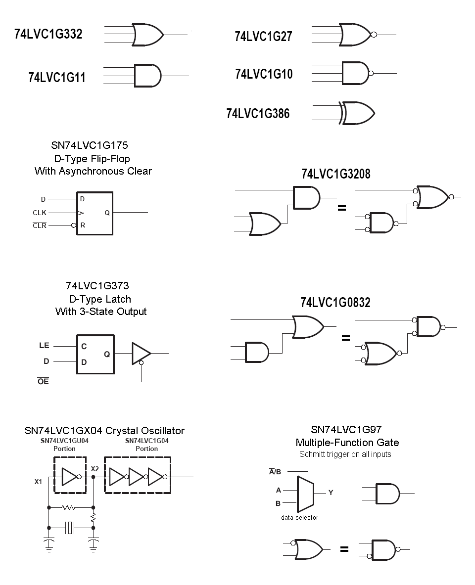

For myself and others who may have an aversion to modern programmable logic due to factors like 5V versions disappearing, the near requirement for Windows, the cost of a programmer, and that the program is not guaranteed to last even half the number of years I've already been using my current workbench computer, Jeff has gotten me thinking along the lines of making a very small "programmable" logic board that's programmable with a soldering iron. PCBs getting super cheap for hobbyists (for example http://www.dirtypcbs.com/, http://www.pcbway.com/, and http://pcbshopper.com/), and 74LVC1G__ tiny SMT logic building blocks are available with delays under 2ns(!) for even gate pairs. It is becoming feasible to make postage-stamp-sized modules that could be "programmed" with solder blobs on tiny split circles on the PCB, and/or by soldering wire-wrap wire jumpers into .015" holes. It's re-programmable too, not having to cut traces to program it. With greater difficulty, the tiny 6-pin SMT gates could be changed out. (Jeff's post that got my imagination going is here.)

When I click on that link I get a status message telling me "You are not authorised to view, download or link from/to this site."
Posts: 8777
Re: Memory decoding options
Here it is, attached and inlined:
They're in 6-pin SOT-23's.
