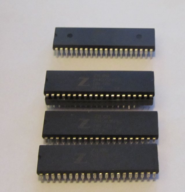

PostPosted: Fri Jan 22, 2016 9:16 am
Posts: 197
Do the chips LOOK like they've been re-marked or altered
http://www.aeri.com/counterfeit-electronic-component-detection/
I was given some suspect Z80s to play with, it's pretty obvious in the photo which one is the Mouser supplied genuine part, and which 3 came from China.
In this instance the suspect chips are NMOS Z80's (probably 4mhz Z80A) rebadged as 20mhz CMOS parts. They work fine, until you try to clock them faster than their original rating
File comment: 3 x re-marked chips and one genuine
