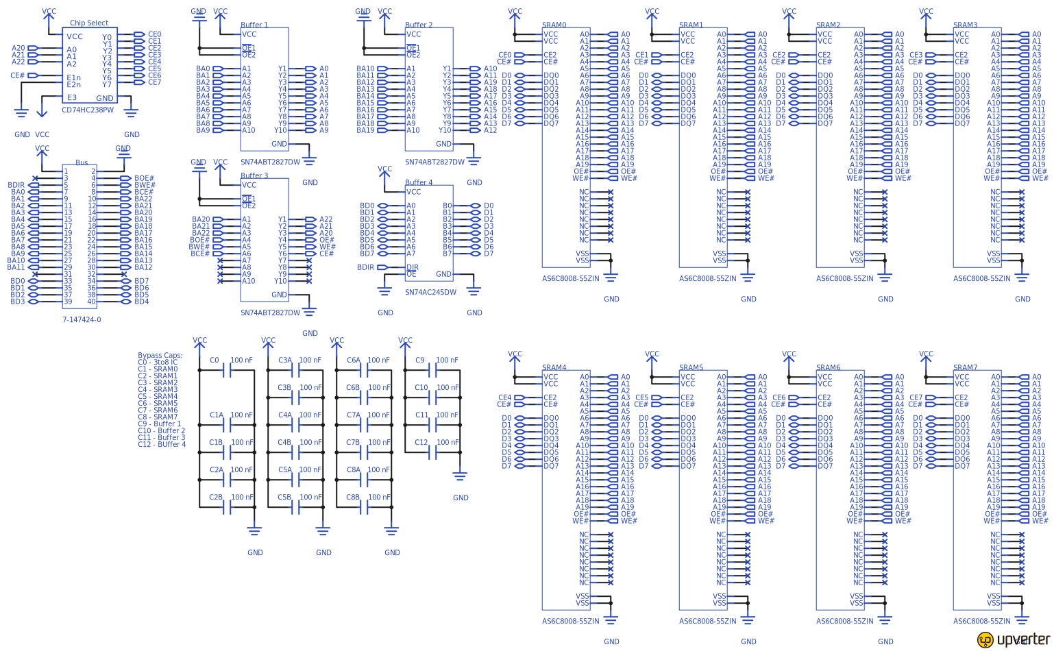

I'm looking to build a reusable memory card for my projects seeing as SRAM costs can add up. I've attached the circuit diagram and this is the link to the Upverter Project.
Are there any suggestions or issues or comments? I'm still very much learning so the more the better. Really the most I've done in the past has been minor AVR based projects. I'm planning on making 2 for use with a W65C816S but I figure I could use one in a W65C02S based project as well, just don't use all the address lines.

The image to which you linked doesn't seem to want to load. Are you aware that you can attach files to your messages?

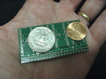

I was not aware of any 5V SRAM ICs that had over 512KB, which is what the 4MB SRAM module I make and sell has eight of. It's 2.300" long x 1.234" wide, not including connector. There are four half-megabyte SRAM ICs on each side. It's 10ns though, not 55ns, so over five times as fast, and still 5V. The data sheet is at http://wilsonminesco.com/WM-1_4Mx8SRAMm ... -12-15.pdf, and there are a couple more pictures on the front page of my website linked in my signature line. Here's a bare board:
Although I have to make a little money on the manual assembly and testing, the fact that I bought boards and ICs in much higher quantity than you will may mean the whole thing turns out to not cost any additional money, and you can have them a lot sooner. I'll keep making them as long as the same (or compatible) parts are available, which I expect will be a long, long time. Most customers only order one at a time, but a couple of customers ordered four at a time, to fill up the 816's 16MB space. I can supply the sockets too, either soldertail or wire-wrap, and the module's pins can be either straight or right-angle. They're on .100" centers, so they're very hobbyist-friendly, as that's the hole spacing on perfboard.

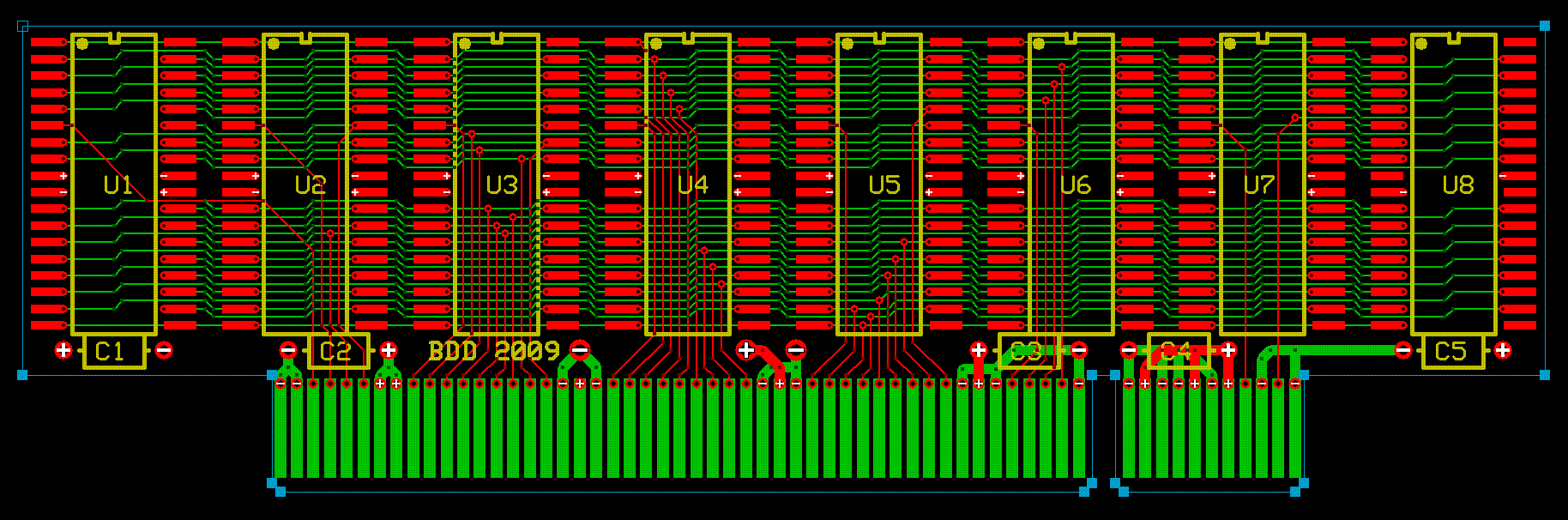

BDD did a bigger one years ago with all 8 ICs on the same side, like this:
Welcome, Justin. The decoder you've chosen ('hc238) may be a speed bottleneck -- it could be upgraded by switching to 'ac238.
The '238 style has active-high outputs. Even faster decoders are available -- and I expect the fastest of all will be in the more popular '138 style, with active-low outputs (such as CY74FCT138CT, rated at 5 ns max). It looks as though your circuit could easily be rearranged to use a '138 style decoder -- just swap the two CS inputs on the RAM's. One side effect is, the signal you call CE# (from buffer 3) would then become active-high, so at least a minor change is involved re the decoder enable inputs. Dunno if that matters.
The pinout you've chosen for the bus connector needs more ground and Vcc connections, partly for redundancy and also because their physical location makes a difference -- they should be interspersed with signal connections so that none of the latter is too far from a Gnd (or Vcc) connection. Garth has attended to this in the connector pinout for his RAM board, and so should you with yours.
In the same vein, perhaps you can find a more modern equivalent to the 74abt2827 bus drivers. I expect there's an equivalent chip that places its Gnd and Vcc pins at the center of the package, rather than the old way (diagonally at the corners). I wouldn't lose any sleep over this detail, but if you're eager to do the best job possible then see what's out there.
For researching and selecting IC's I have found Digikey's "Product Search" to be extremely effective. :!: It has led me to chips I didn't know existed, and which perfectly fit the application. Recommended! -- well worth becoming familiar with.

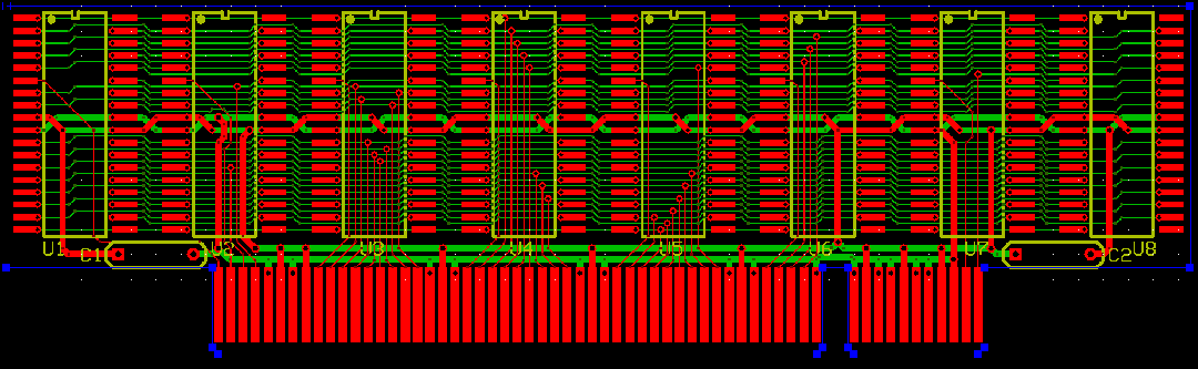

BDD did a bigger one years ago with all 8 ICs on the same side...
I also did a four layer version that was slightly more compact. Both designs plug into a standard PCI slot connector.
File comment: 4MB SIMM, Four-Layer
