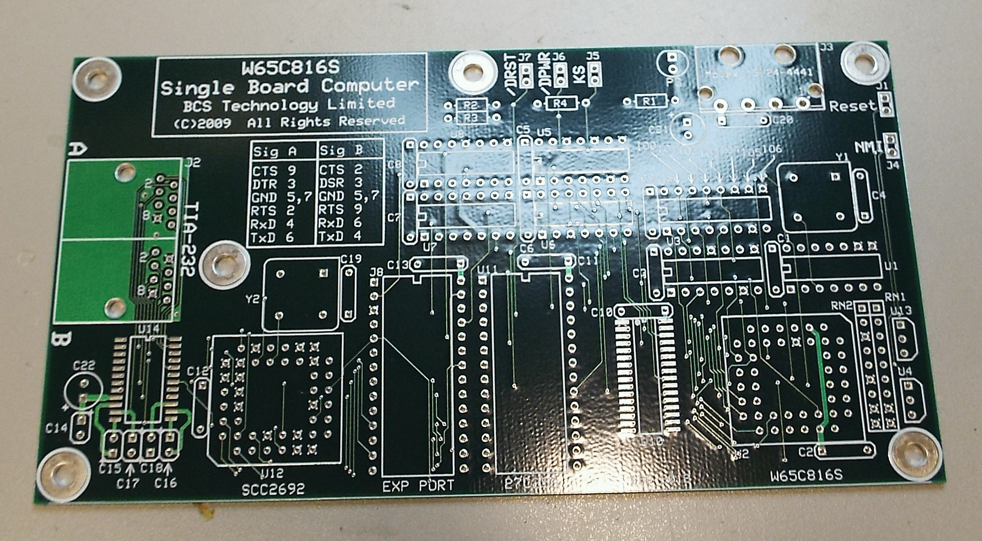

For the purpose of getting familiar with hobby reflowing, I'm going to build a copy of POC V1.1, which makes a good test base for this purpose. POC V1.1 is a functional design, which means if the finished assembly doesn't work or is unstable it'll likely be due to my reflow methods—the design itself won't be in question.
Here are the items that will be the victims of my first attempt at reflow:
File comment: POC V1.1 Printed Circuit Board

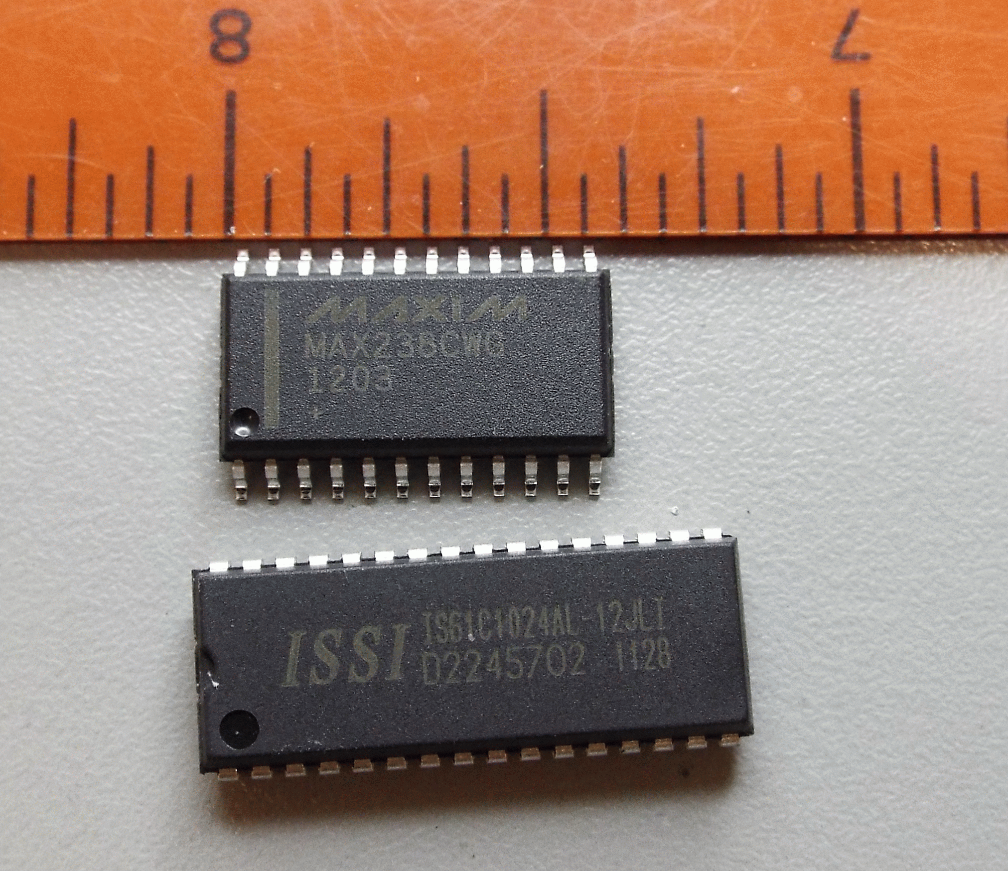

The devices are a MAX-238 in an SOIC-24 package and an ISSI 128KB SRAM in an SOJ32 package. The scale in the second photo is in inches.

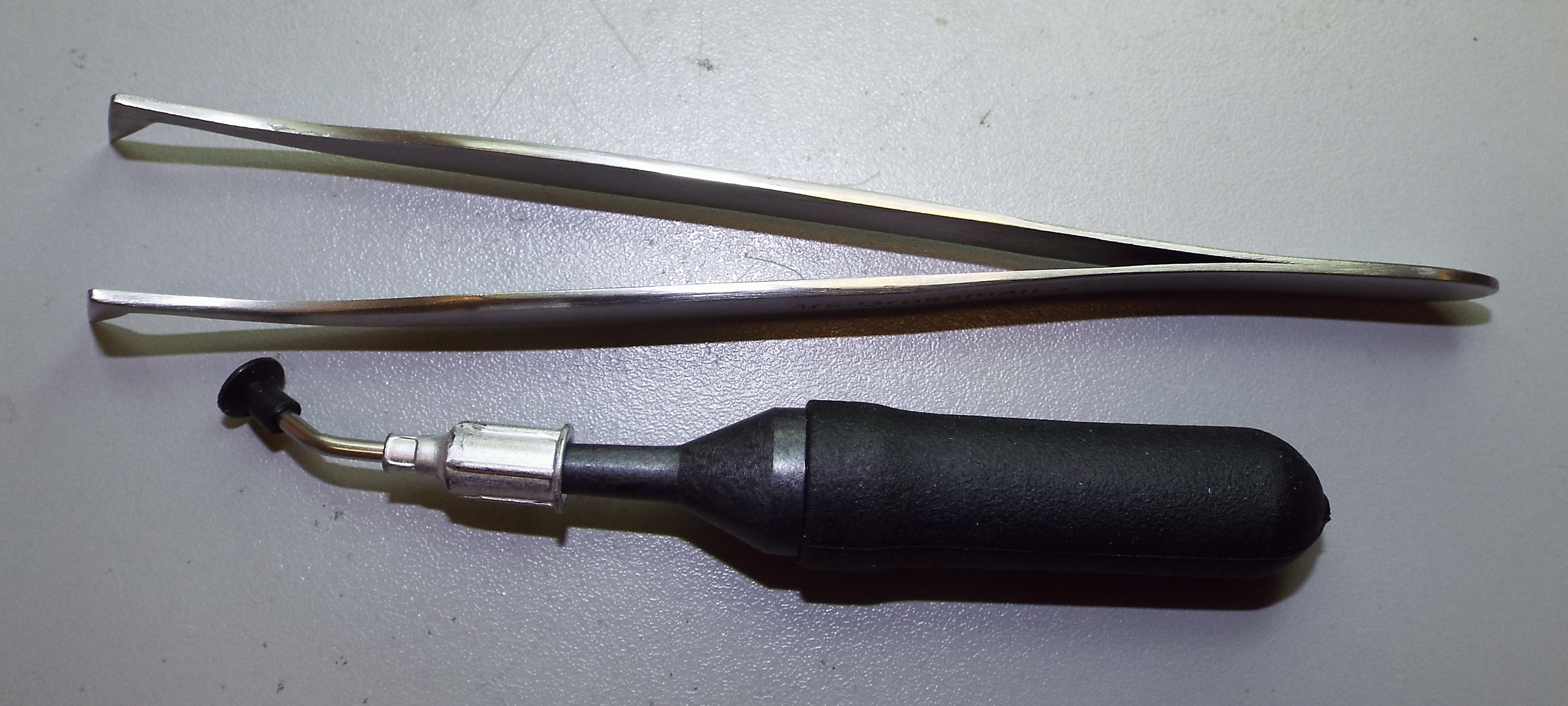

  • Chip Handlers
    Surface-mount devices are dinky compared to through-hole equivalents, which creates some challenges in handling them. Following the application of solder paste to your PCB, you need to accurately place your parts on the pads. For that task, tweezers and/or a suction pick are useful.
    File comment: Suction Pick & Tweezers
    The suction pick, called a "Handi-Vac," is available from Edmund Optics. It comes with several attachments, which are basically little suction cups. After placing the suction cup on the device package, you squeeze and release the bulb to pick the part. Once the part is in place you again squeeze the bulb to release it. I found that wetting the suction cup immediately before picking a part improved the grip, giving me more time to handle the part before loss of suction.

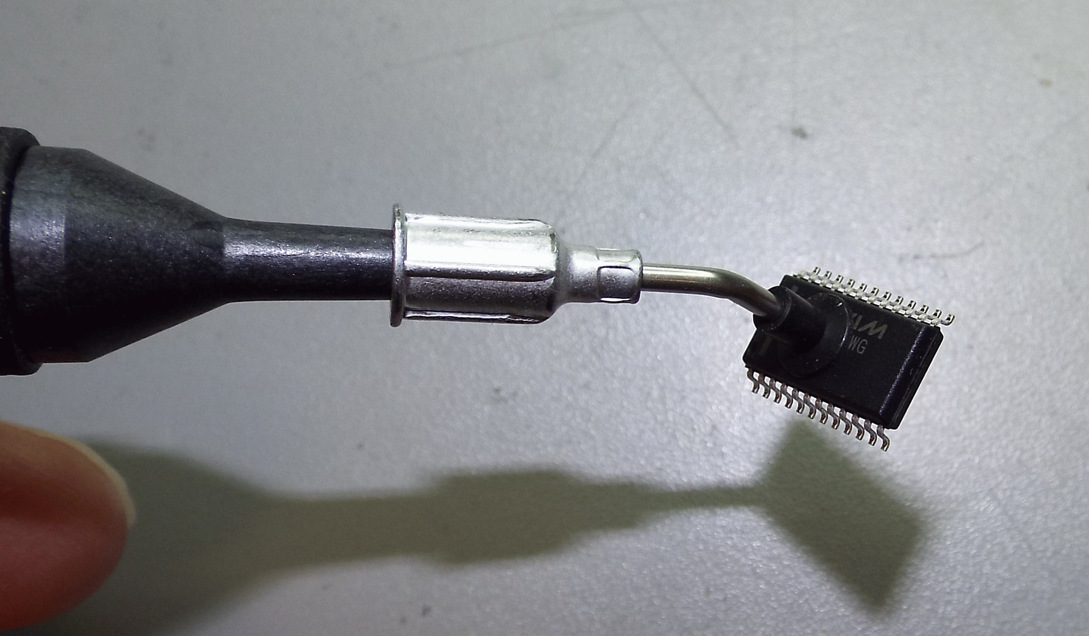

    File comment: Using Suction Pick
    In the above, I have picked the MAX-238. The grip was maintained for about 30 seconds, sufficient time to place the part if you aren't too clumsy. :D
    In lieu of a suction pick, a pair of eyebrow tweezers may be used for handling parts. They, of course, won't work well with larger packages. I found that handling an SOJ32 device with tweezers was awkward.

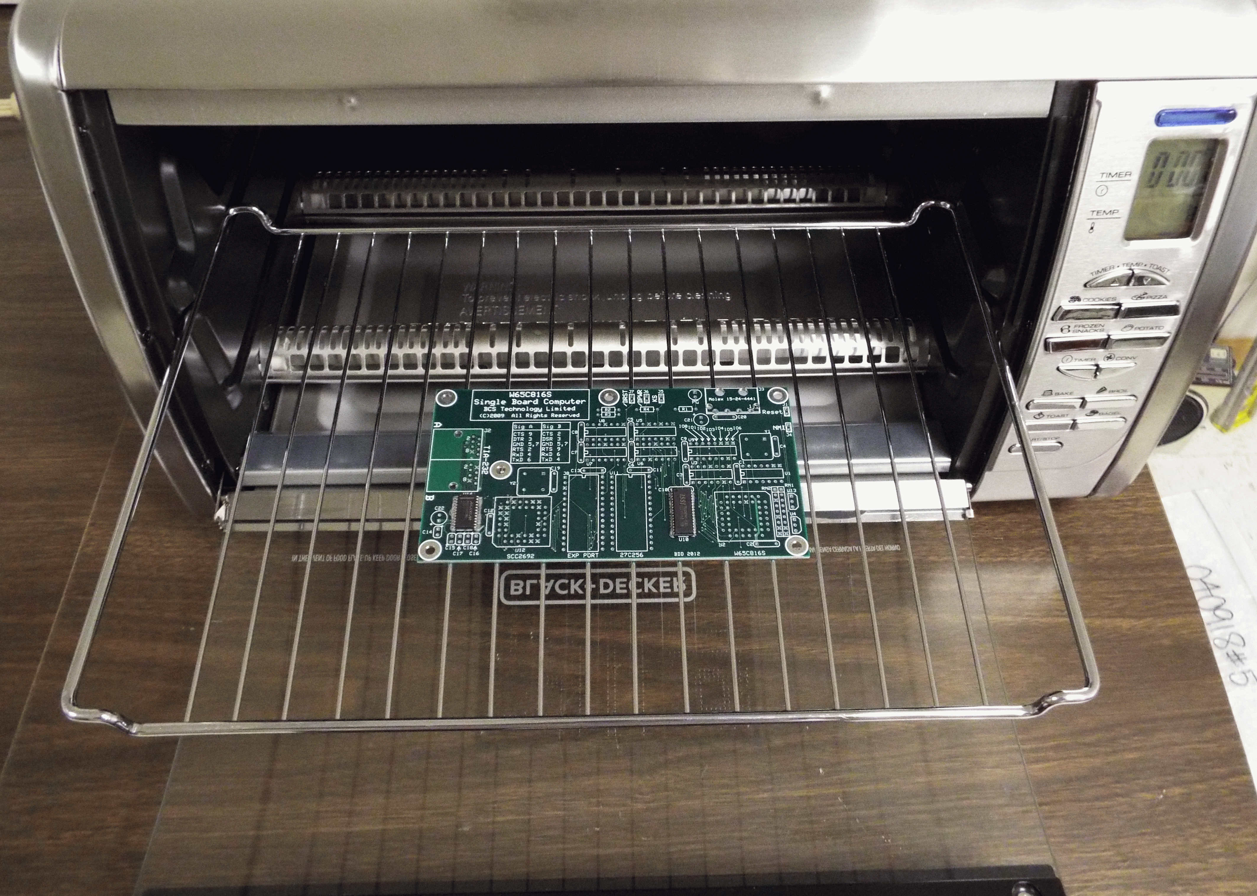

  • Source of Heat
    There are several means by which you can heat your PCB assembly for reflowing. Some hobbyists have had success with using an electric frying skillet. Others have used hot air guns and infrared lamps. I decided to use an actual oven, mostly due to the control that it offers. Whatever you do use, keep in mind that peak reflow temperature is around 450° F (232° C), which means your source of heat must be capable of attaining that temperature and maintaining it for at least 30-45 seconds. As will be seen when I get to the procedure for reflowing, the ability to accurately control temperature will be important.

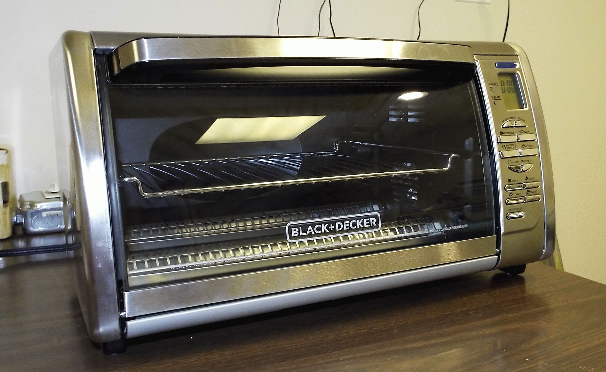

    File comment: Counter-Top Convection Oven
    The above is a Black & Decker digital counter-top convection oven, model CT06335S. I spent some time researching suitable ovens before selecting this particular one, which replaces an old Proctor-Silex unit I had that suffered a heating element failure and proved to be too expensive to repair.
    Useful features of this unit are its infrared heating system, with elements located in both the unit's base and top, its convective capabilities, which produces a more even heating of the interior and contents, and a real-time temperature display, which is handy for monitoring the process. Although I have no plans to reflow one, an ATX motherboard will fit in this oven. I'm not advocating that you get this particular unit—any oven with similar features will be a good candidate for the job.
    A word of caution: an electric counter-top oven typically draws quite a bit of juice. This Black & Decker unit consumes 1500 watts when heating and not unexpectedly, radiates quite a bit of heat into the room. A 1500 watt oven generates about 5000 BTUs, which I found was enough to elevate the temperature in my shop several degrees after about 10 minutes of continuous operation.
Odors may develop during the reflow process, which will probably smell like roses to you, but probably something a little less pleasant to the other members of your family. :) Please keep all that in mind when you choose a location to set up your reflow facility.

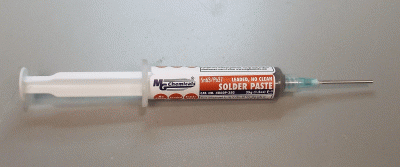

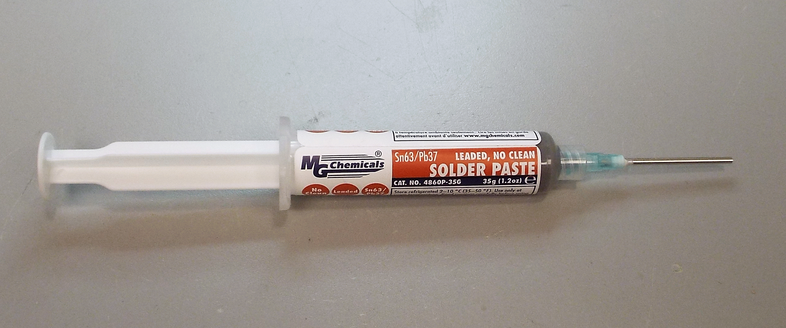

File comment: Syringe w/Solder Paste
Above is the syringe of solder paste ready for use. As can be seen, this paste is an MG Chemicals product, which is shipped with an applicator nozzle and plunger. It is a leaded paste, comprising of 63 percent tin and 37 percent lead, in a water base. Solder paste should be store in refrigeration, but is somewhat difficult to work with at such temperatures. MG Chemicals recommends that the solder paste be kept at room temperature a minimum of three hours before use. That wasn't quite enough time to get it to a workable state, so I let it sit for about four hours before application.
Note that as this is a leaded paste it is wise to avoid epidermal contact with it, as lead can be absorbed though the skin and cause subsequent health problems. I kept some isopropanol and paper towels handy for cleanup if needed. Some fumes will result when the paste is heated to reflow temperature, which demands that you adequately ventilate the room in which you are working.

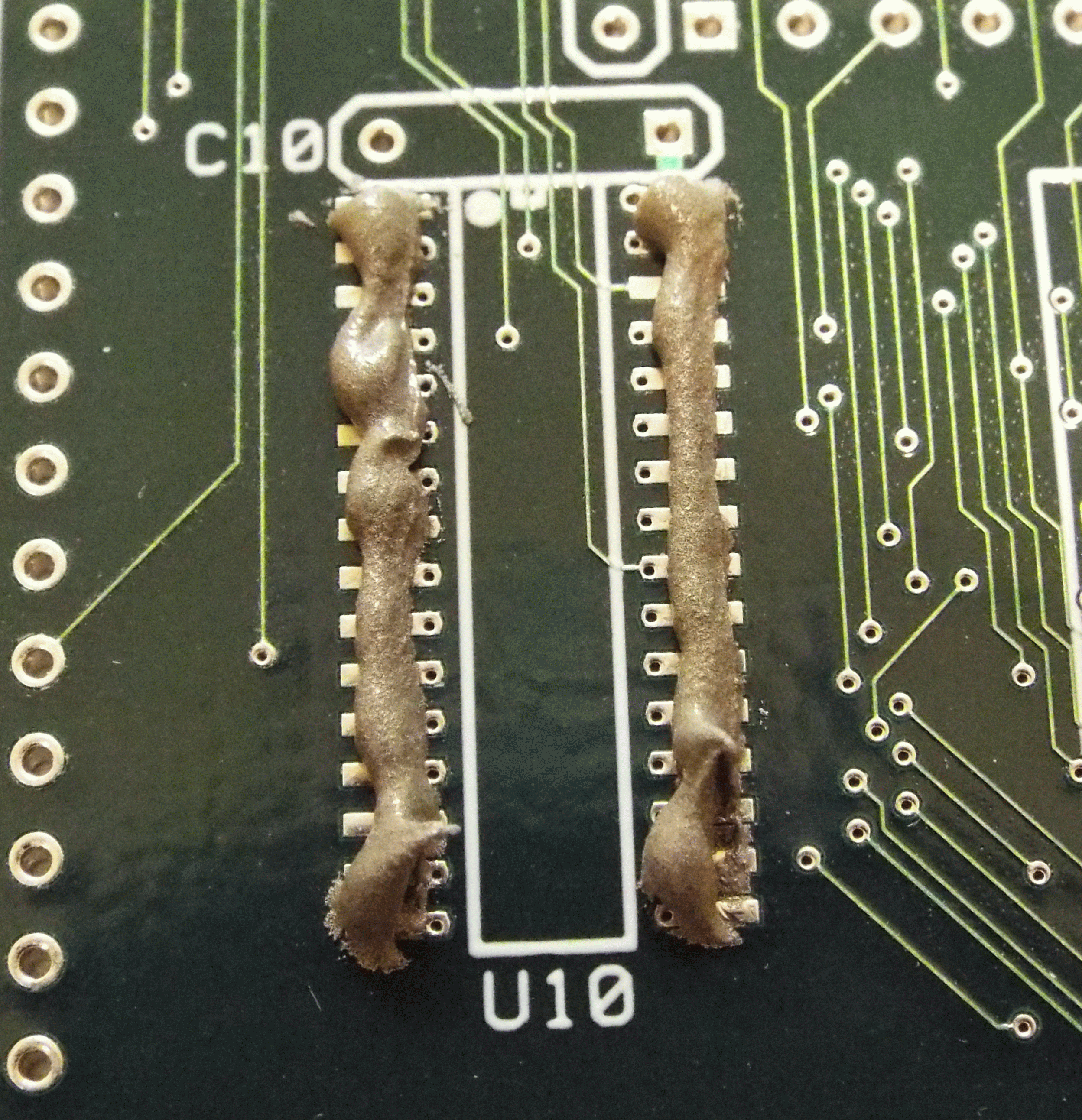

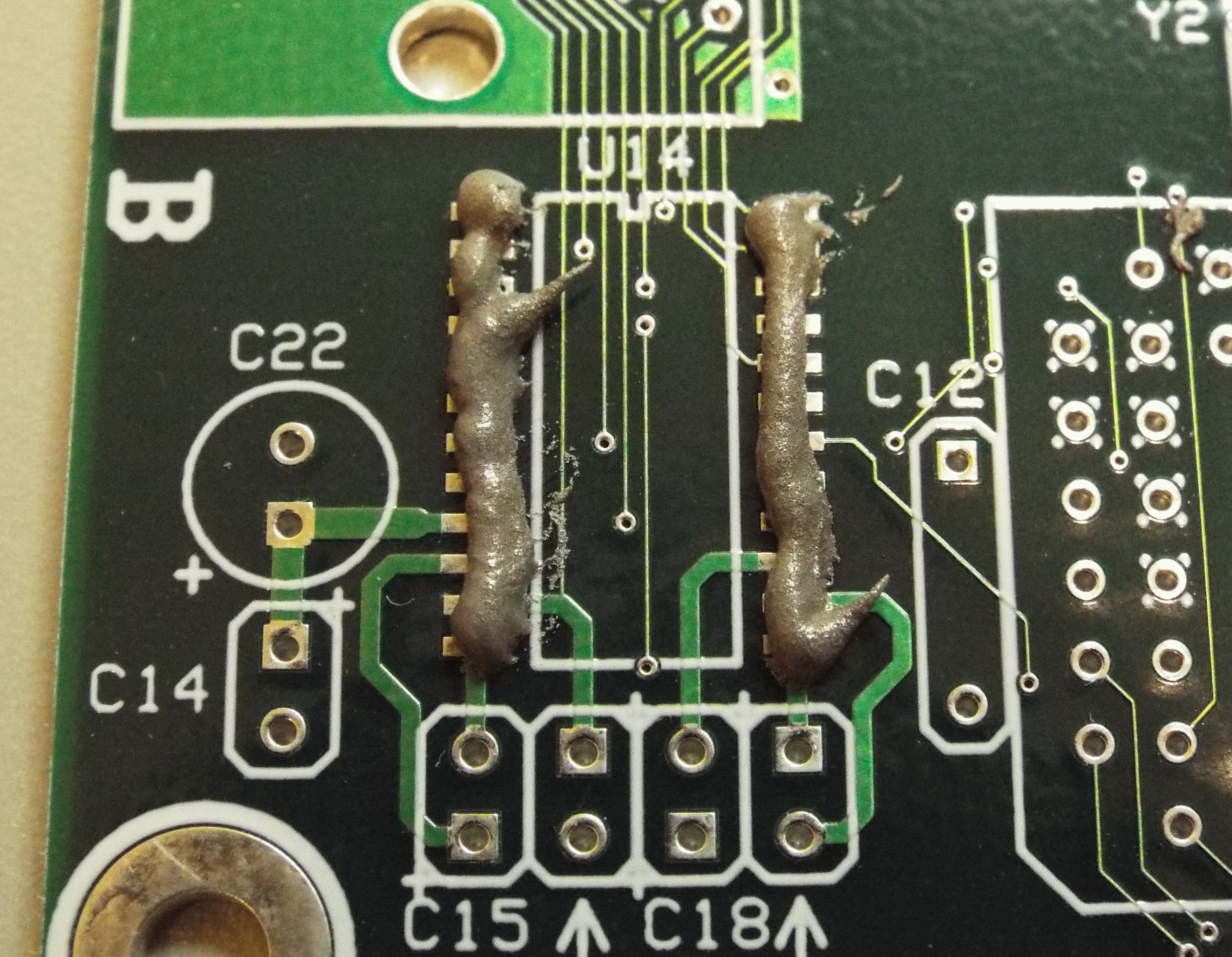

File comment: Solder Paste on SOIC-24 Pads
Above is solder paste applied to the pads where the MAX-238 SOIC-24 package is to be soldered. It turned out to be more than necessary. I'll come back to the application process later on.

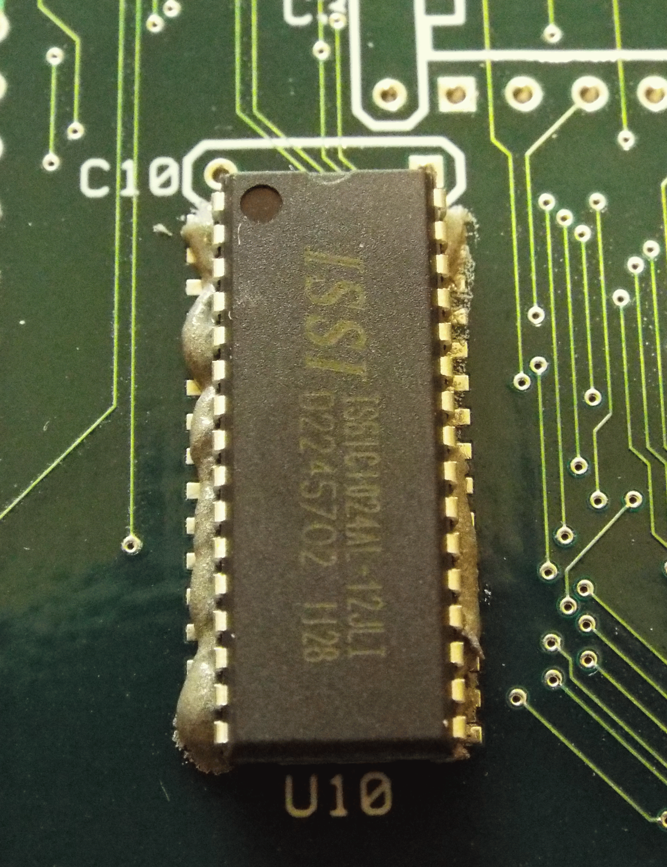

File comment: Solder Paste on SOJ-32 Pads
Above is solder paste applied to the pads where the SRAM SOJ-32 package is to be soldered. It also turned out to be more than necessary.

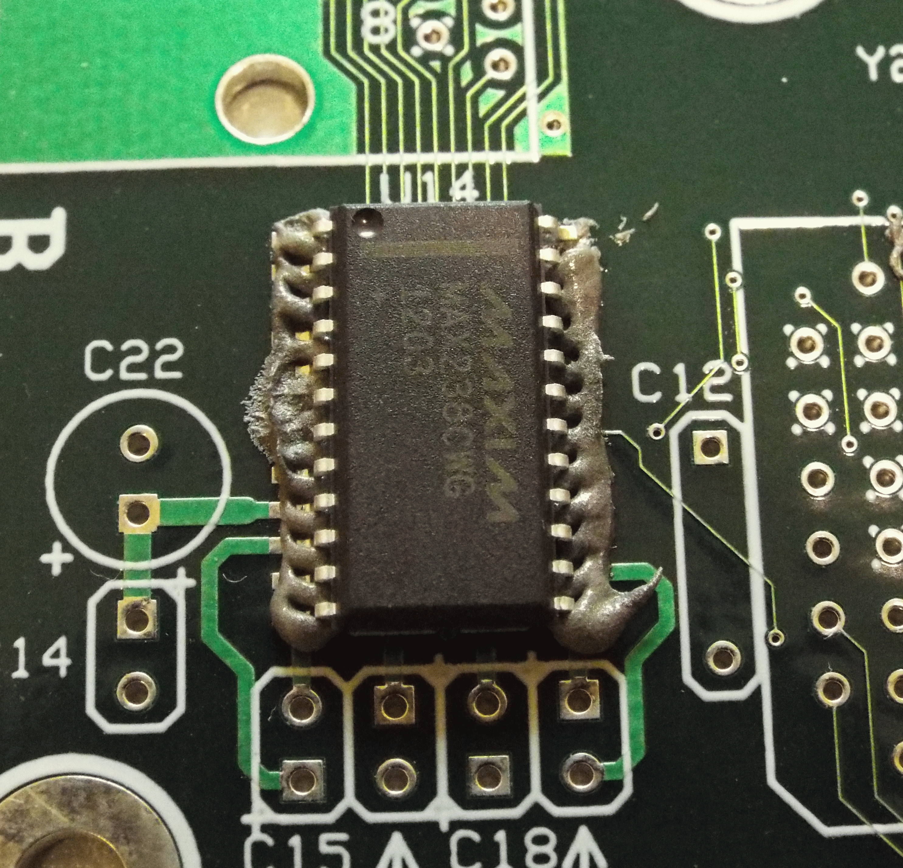

File comment: MAX-238 in Place
File comment: SRAM in Place
Above are the two devices in position. I couldn't see it at the time, but some of the solder paste has squished out in between the pads, which was not good.

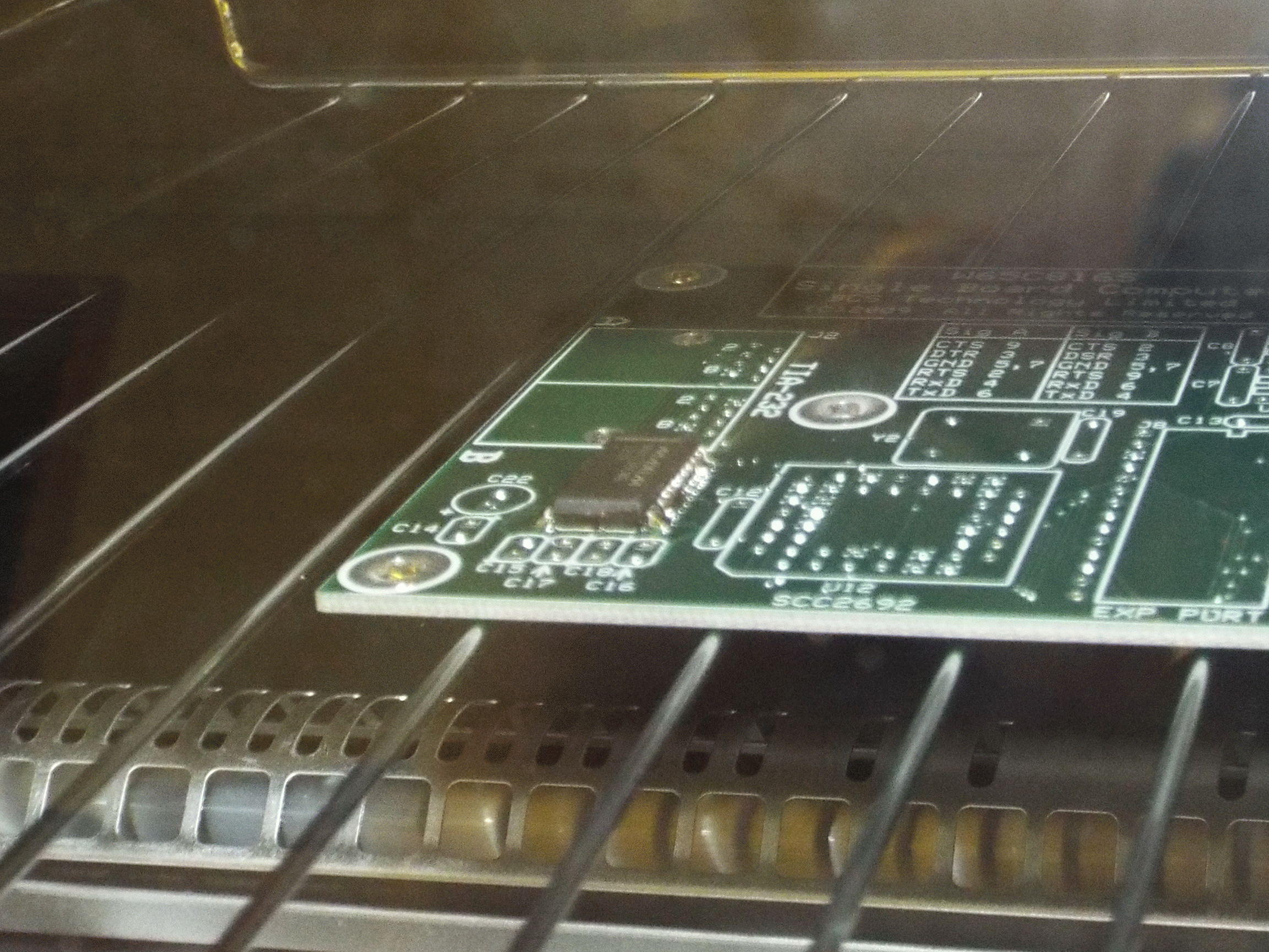

File comment: Into the Oven
Here is the board ready to go into the oven. Needless to say, handling the board carefully is essential so the chips don't move out of position.

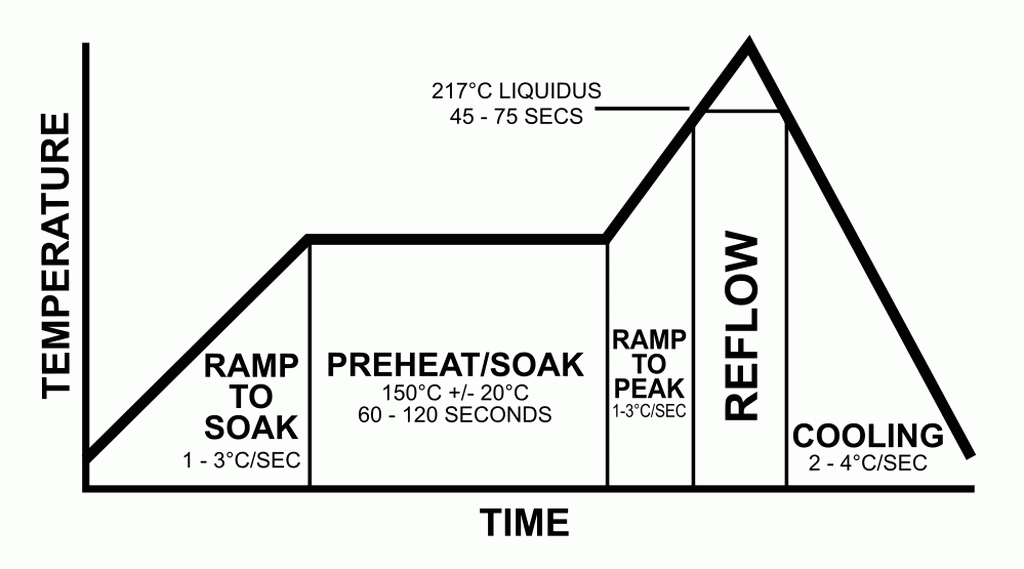

File comment: Typical Thermal Profile
Once the board was in the oven it was time to bake it and see what would happen, following a thermal profile that is relatively common in the industry. A goal of the thermal profile is to evenly heat everything in a way that won't subject devices to undue thermal shock. The PCB itself isn't particularly vulnerable to damage from thermal shock, but devices are and can end up DOA if heated too rapidly or for too long. So after doing some reading on others' efforts at homebrew reflow, I decided to try a four phase process, viz.:
  • Soak phase. After initial preheat, the oven was held at 200 degrees for four minutes. Soaking assures that all parts have expanded equally, reducing the chance of thermally-induced fracture of an internal connection in a device.

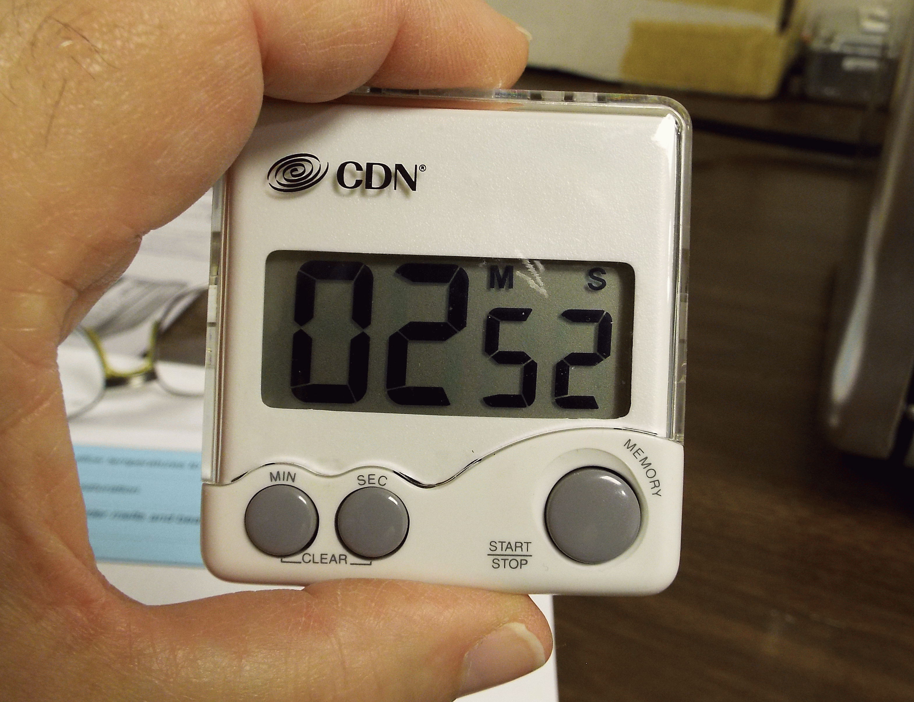

    File comment: Timing the Phases
    Phases were timed with a kitchen timer—which makes perfect sense, given that the "reflow oven" is a kitchen appliance and the solder paste was stored in the refrigerator, also a kitchen appliance. :lol: As an aside, my EPROM erasing rig was concocted from what started out as a light fixture intended for mounting under a kitchen cabinet. :shock:

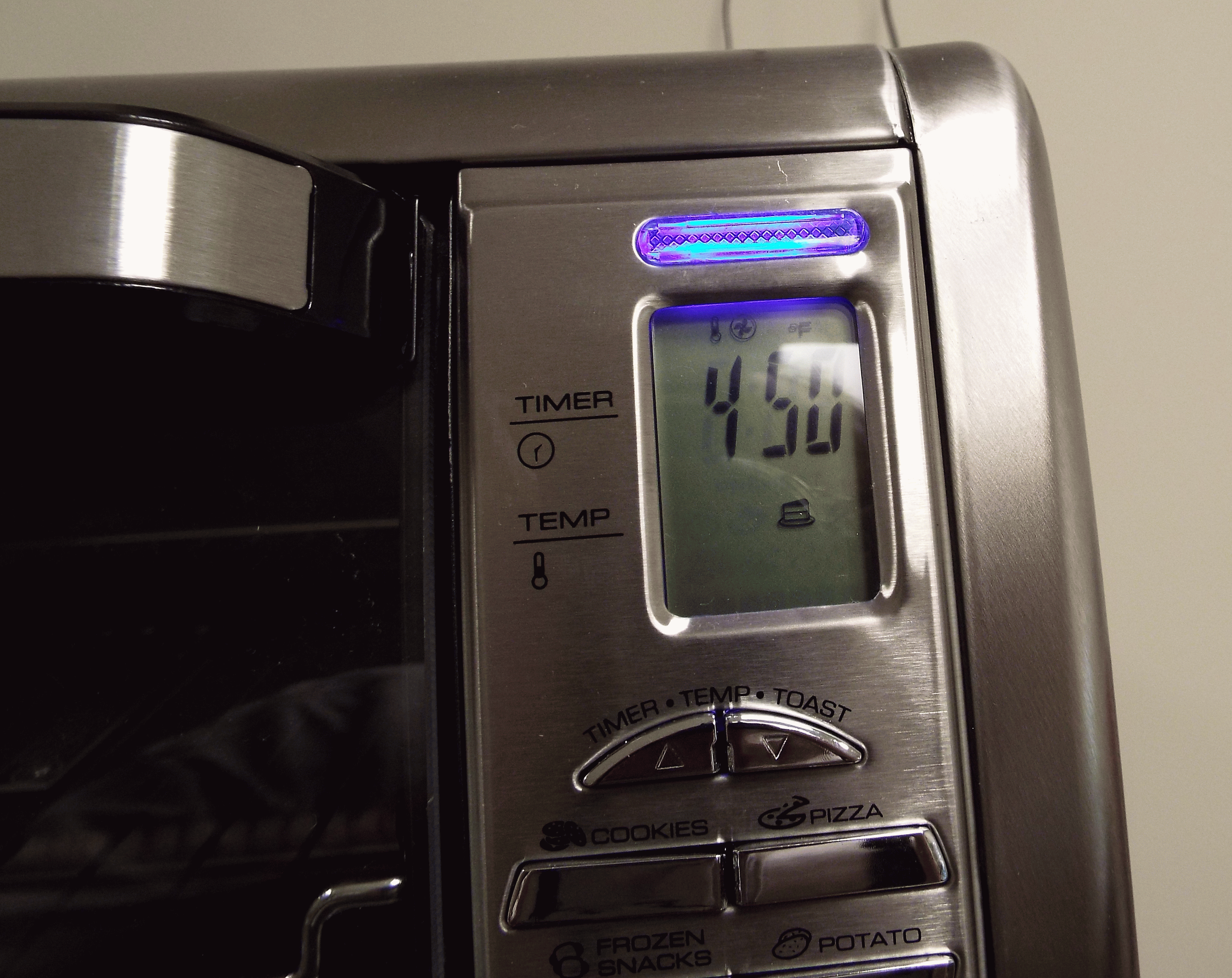

  • Saturation phase. Following the soak phase, the oven temperature was elevated to 325 degrees and kept at that level for two minutes. Saturation brings the temperature of everything up to just below where the solder paste and reflow on the PCB start to liquify. Again, the object was to avoid thermally-induced damage.
  • Reflow phase. Following the saturation phase, the oven temperature was increased to 450 degrees and kept at that level for 30 seconds. Liquification commenced at about 390 degrees and was essentially complete at 420 degrees. At that temperature the paste was bubbling and doing its thing.
    File comment: Oven at 450 Degrees
    File comment: MAX-238 Reflowing
    In the above picture, reflowing is occurring on the MAX-238's pins and it is patent that there is too much solder paste. Getting a good picture through the oven's glass door proved to be difficult, as the camera was having a hard time focusing. So the picture isn't as clear as I would have liked.
  • Cooling phase. Following the reflow phase, I shut off the oven and carefully opened the door. I allowed the board to sit for about five minutes before removing it from the oven for inspection.
