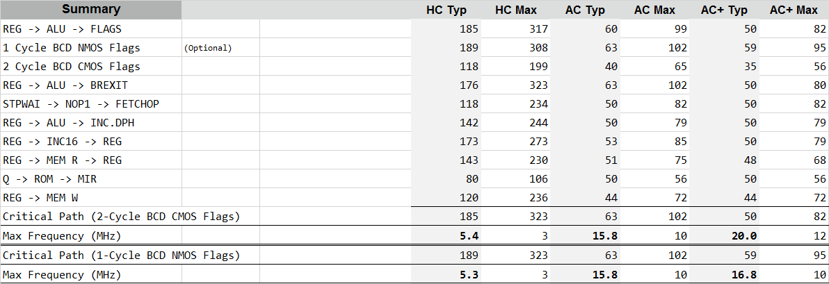

I agree, 20MHz would be great! BigEd's comment was very encouraging, and so I thought I'd better have a thorough review - with some luck, maybe we could manage without the "icepack"! :) Turns out, the target was further away than I thought ...
For starters, I noticed I was using several "optimistic" tpd figures from NXP data sheets. When I re-worked things using more conservative Fairchild numbers, it was obvious more work was needed. But the clincher came when I realized that disabling the ROMs was now on the critical path (I disabled the ROMs and enabled a 74AC541 buffer to drive the control lines in specific situations). Here I had managed to avoid the 45ns access time, only to replace it with a 20ns disable time! :twisted:
Happily, I was able to work around the problem by using a pair of 74AC574s at each ROM - one primary one to latch values directly from the ROMs, and a second to latch special instructions. The control logic then simply selects one or the other as required while the ROMs are kept enabled throughout. The '574 pairs only replace the '273 / '541 combination I was using before. And, rather significantly, the typical Setup Time for a Fairchild '574 is 0ns, which, I'm happy to report, also makes the math I had to fudge before work very nicely: 5ns to bump a counter, 45ns to access the ROMs and 0ns to latch the data = 50ns. No fudging required!
Now this notion of selecting from pre-prepared results is something that ttlworks referred to in his collection of CPU-improving ideas, and it proved useful in all sorts of ways. In particular, a Carry-Skip-Adder pulled the INC16 circuit out of the critical path, where it had once again landed when the ALU was made faster. And, of course, no sooner had that obstacle been overcome, than others popped-up in "Whack-A-Mole" fashion. For instance, a 74HC688 comparator which was used to detect certain opcodes had to be replaced with faster gate-only logic. Similarly, a 74AC161 counter could be reset faster by "loading" it with zeroes on the clock-edge rather than waiting for a correctly-timed "clear" signal to travel through a latch and an inverter (a journey which added 9.5ns to the critical path!). It all adds up.
The net result of this is that every path, so far as I can tell, is now at or below 50ns, at least on paper, and it seems more likely that the CPU might deliver something akin to 20MHz (or perhaps it is better said that almost certainly it would NOT have done so before!). An ancillary target was to improve the 1-Cycle-BCD path as well. Doing that required help from both Dr Jefyll and ttlworks (which as always, they generously provided). In the end, through a combination of FET switches, skip-adders and pre-computing results, the 1-Cycle BCD path is clocking-in at nearly 17MHz - enough for "twice the C64 dot-clock rate", as ttlworks had suggested. Just for kicks, below is a summary table for the various paths with HC, AC and AC+CBT logic families (the last is shown as AC+ below). I've also attached the full table showing details of each path for those that are interested.
Cheers for now,
Drass

Great result! Selecting between two values is a very nice general technique for accommodating late inputs.

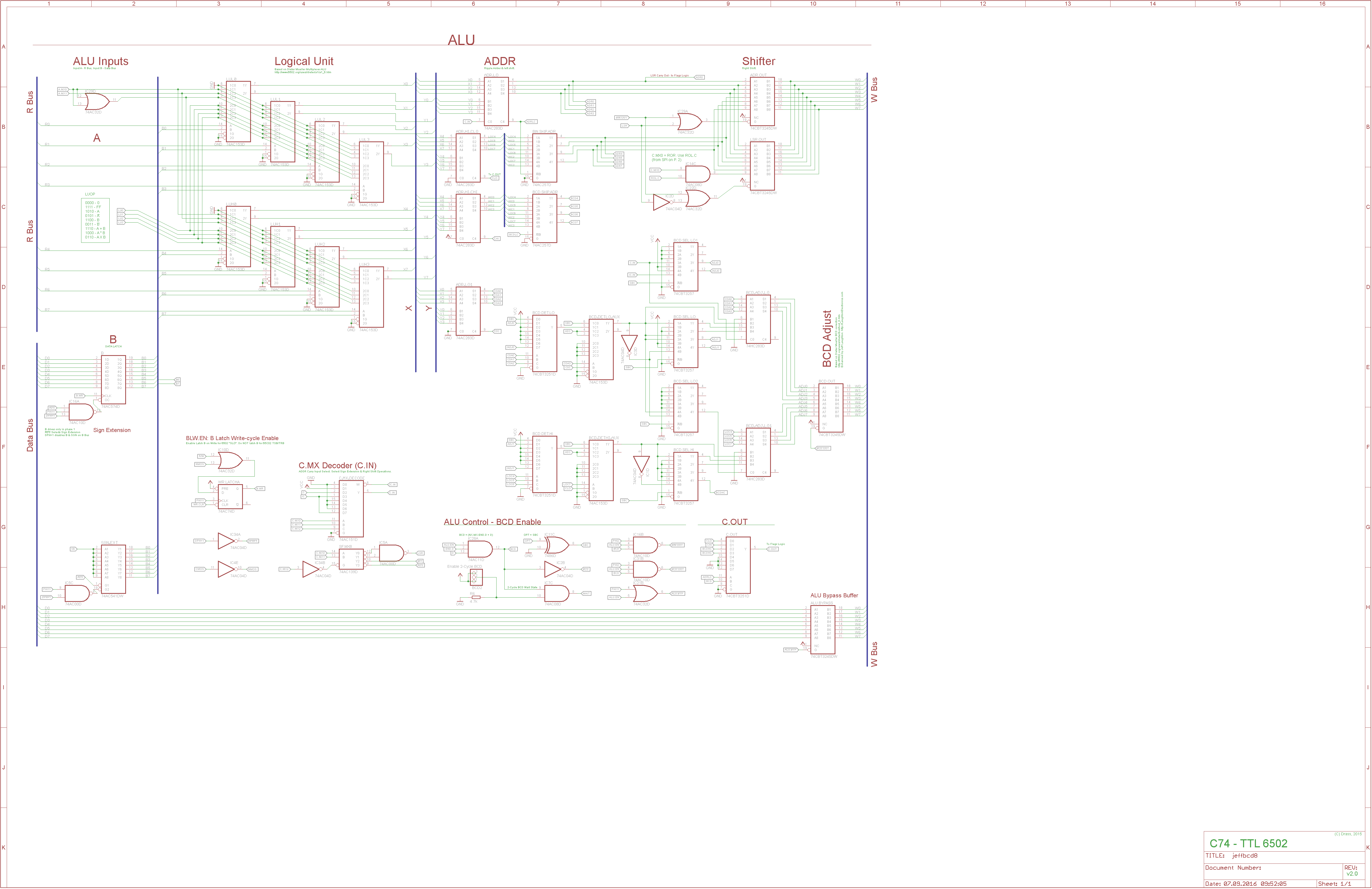

Just wanted to share quickly that, through one last bit of inspiration and creative use of FET switches, Dr Jefyll has managed to further enhance the 1-cycle BCD performance. The critical path on a BCD operation is the carry chain, which looks like this:
ADR.LO ('283) -> BCD.DETECT.LO ('151) -> BCD.ADR.HI ('283) -> BCD DETECT.HI ('151)-> BCD.SELECT. HI ('257)-> BCD.ADJ.HI ('283)
The revised arrangement feeds the carry from ADR.LO directly into BCD.ADJ.HI (which is an adder used before only for the BCD adjustment) so the new carry chain becomes:
ADR.LO -> BCD.DETECT.LO -> BCD.ADJ.HI
In order to make this bit of magic work, the threshold for triggering a BCD adjustment had to change on the fly. Normally. that threshold is >9 for ADC (i.e. if the result of an addition is A, B, C, D E or F, we add 6 to adjust to decimal) and < 0 for SBC (i.e. if the result is F, E, D, C, B or A, we subtract 6 to adjust it to decimal). The basic concept is to take the carry out of BCD.ADR.HI and conditionally set new thresholds at >8 for ADC and <F for SBC respectively.
It turns out the changes could all be implemented using FET switches in series and the total propagation delay is minuscule. It took some effort to adapt the idea to work with the BCD NMOS flag evaluation logic (and we lost some efficiency as a result), but it all worked out in the end.
I'm happy to report that the new BCD circuit delivers the 1-cycle BCD operation in just 58ns, vs 50ns for binary. Wow!
Nicely done Jeff :)

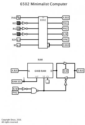

Attached is the Logisim file as well as a RAM image of Klaus Dormann's 6502 Test Suite. To make it go:
1) Load the Test Suite into the ram on the main page (Shown below)
2) Set the RDY and BE pins high
3) Start the clock (/Menu/Simulate/Ticks Enabled)
4) Hit the reset button
The test suite will start to run. Go into the "6502" sub-circuit to see all the blinking lights ... Keep an eye on RAM address $0200 to see the current test number being executed.
Bonus points if you help me find any bugs! :)

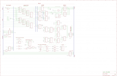

The current implementation uses a modified version of the BCD correction circuitry
from my homepage for Bit 3..0, and Jeff's circuitry for Bit 7..4.
Tried to modify Jeff's circuitry to work for Bit 7..0,
but from the PCB layout I'm starting to think we don't have enough free space left
on the PCB for implementing something like this.
Also, it appears that it won't increase the speed of the CPU.
Since it might be interesting (or maybe even useful) for other people's projects,
I think it would be good to post it here before it disappears into /dev/null.
Without any warranty that it might really work, and absolutely untested on whatsoever:
jeffbcd8.zip [47.44 KiB]
Downloaded 87 times
The basic idea is to have 74283 adders in the ALU with the carry input tied to low
for calculating A+B, A-B.
Then to add a carry to a 4 Bit nibble as late as possible: in the BCD correction adders.
