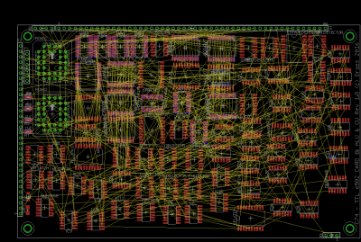

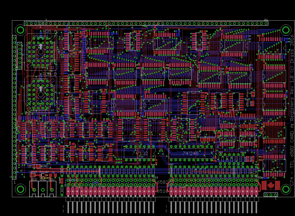

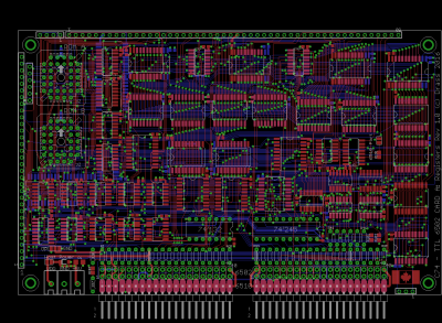

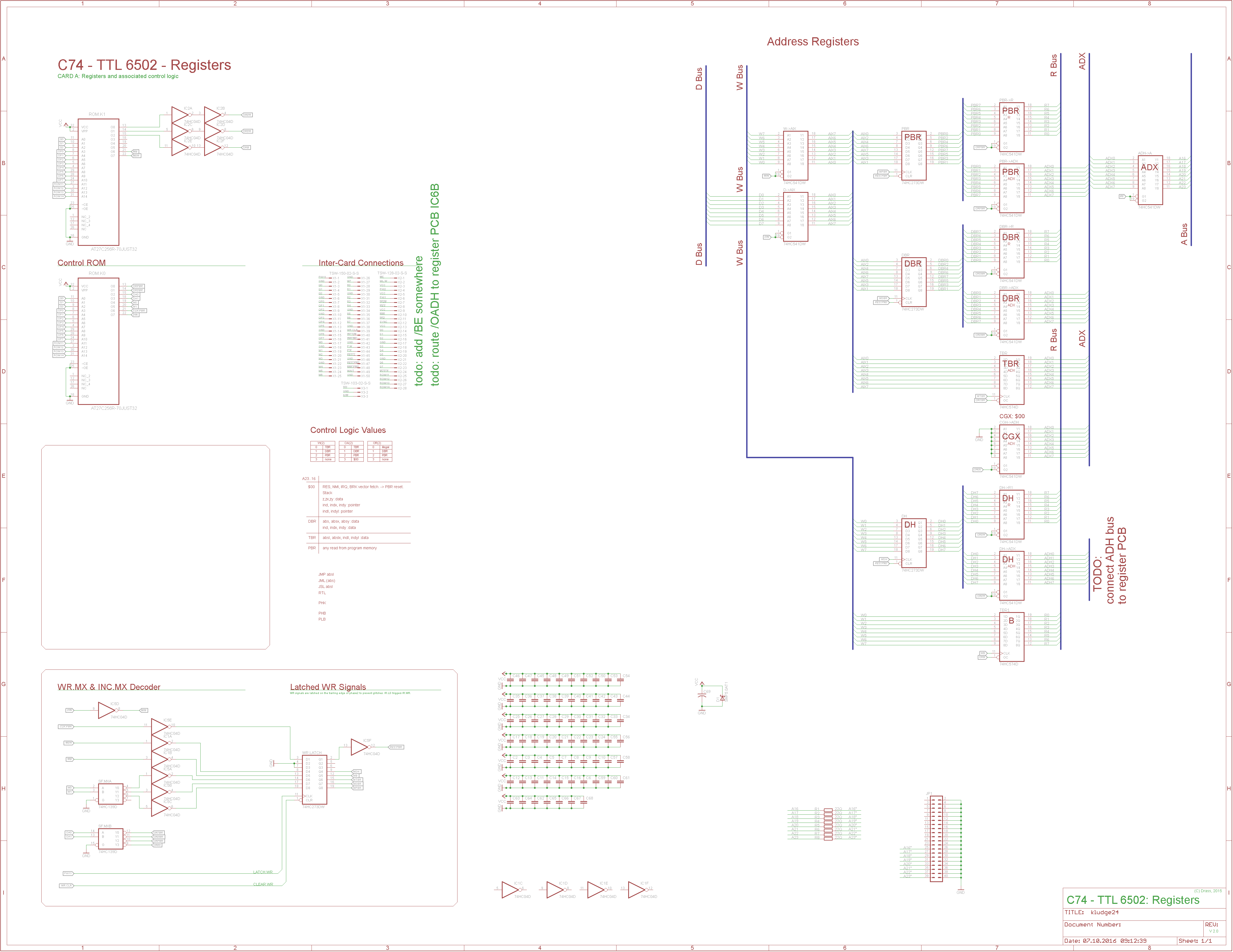

PostPosted: Wed Jul 13, 2016 12:42 am
Posts: 428
Location: Toronto, ON
I had to look back to check ... I posted this on March 20th:
I decided to take a pause from routing and look at 65C02 compatibility.
It's hard to believe it's nearly 4 months later! Additions since then:
  • 65C02 instruction set
  • 65C02 plug-compatible pinout
  • NMOS undocumented opcodes
  • NMOS and CMOS compatible BCD flags
  • Microcode pipeline with 14MHz clock-rate
The design now feels like it's reached a nice milestone: a cycle-accurate, pin-compatible 6502/6510/65C02 TTL processor capable of modern clock-rates. The instruction set is selectable on distinct ROM banks and various other jumpers do the rest. If all this works, the CPU should be able to plug directly into either NMOS or CMOS 6502-based computers and run without any appreciable difference ... that's pretty amazing to me, and well beyond my original goals. :D (it's also more than a little amusing to think that all this work is merely to replicate what the original chip does but in a much larger and cumbersome package. :roll:)
I finally had the opportunity to go back and re-route the Registers Card. Ironically, it doesn't look very different, but there are now five additional ICs on the bottom layer and every new trace was a challenge to sort out! :evil: Happily, it all still fits on a Eurocard pcb. Pic below:
The ALU & CU Card has even more ICs (about 20 actually) but luckily many are smaller gates and selectors rather than the much larger registers and buffers. And there are no pinout headers, resistor arrays or large DIP packages here. A rough layout (below) suggests this card just might be ok as well, which would be pretty great. The two cards would then stack together with all external connections on the top card. It will still take while to route the second board so time will tell how things will turn out.
Cheers for now,
Drass

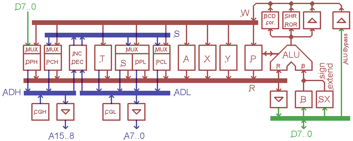

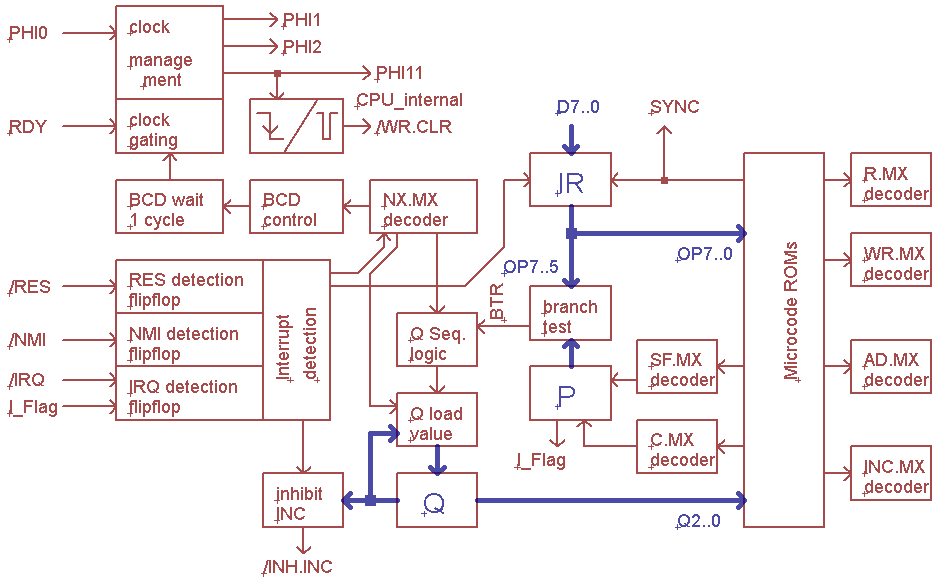

Oh, and I also happen to have a crude block diagram of the CPU.
So I'm just posting the pictures before they become obsolete
by the next revision of the CPU. :)
PostPosted: Sun Jul 24, 2016 2:17 am
Posts: 428
I wanted to drop in just for a moment to say thanks Dieter for posting. The block diagrams look great!
As it turns out, the data path looks correct, even after the microcode pipeline changes. The CU block diagram will need only minor changes. I'll review and update and add them to the schematics when I get a chance. Wrt, the "kludges" - after the quick "recon" layout, it looks like there may still be room on the ALU & CU pcb for an SPI interface (which is a great idea). I think also I can manage a "Kludge24" header to fit the optional 24 bit address bus expander as you suggest. It would be a great follow-on project.
Many thanks as always.

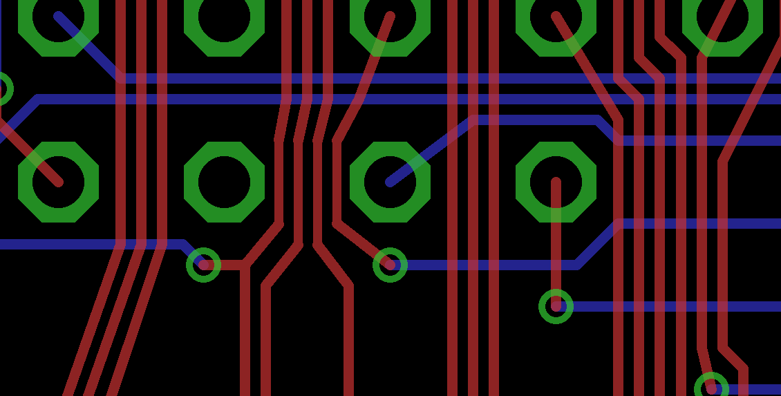

I'm sorry that this is a mundane query, but can I ask: what tolerances you are working to? I see you have 4 traces routed between 2 pins on the PLCC44 socket. This must make for some pretty fine traces and clearances! Also, who will be making up the boards for you?
Good luck with your project. It looks like a fantastic undertaking!
PostPosted: Tue Jul 26, 2016 12:42 am
Posts: 428
Thanks Aslak3, and good eyes! That's the tightest spot on the whole board.
The specs are from OSHpark.com for 4 layer boards: "Minimum design rules are 5 mil trace clearance, 5 mil trace width, 10 mil drill size, and 4 mil annular ring."
As it happens, I'm using 6 mil width, 5 mil clearance and a 13 mil drill size most of the time (not sure why, but so it is). The traces between the two pins of the PLCC44 socket are in fact 5 mil width/5 mil clearance - just taking OSH Park at their word and hoping for the best. I have very little prior experience with this (as in none) so I'm very open to any and all suggestions on all matters PCB! Please don't hesitate to point out anything that looks dodgy. Chances are I am not aware of it :oops:.
Btw, here's a close-up of the section in question:
