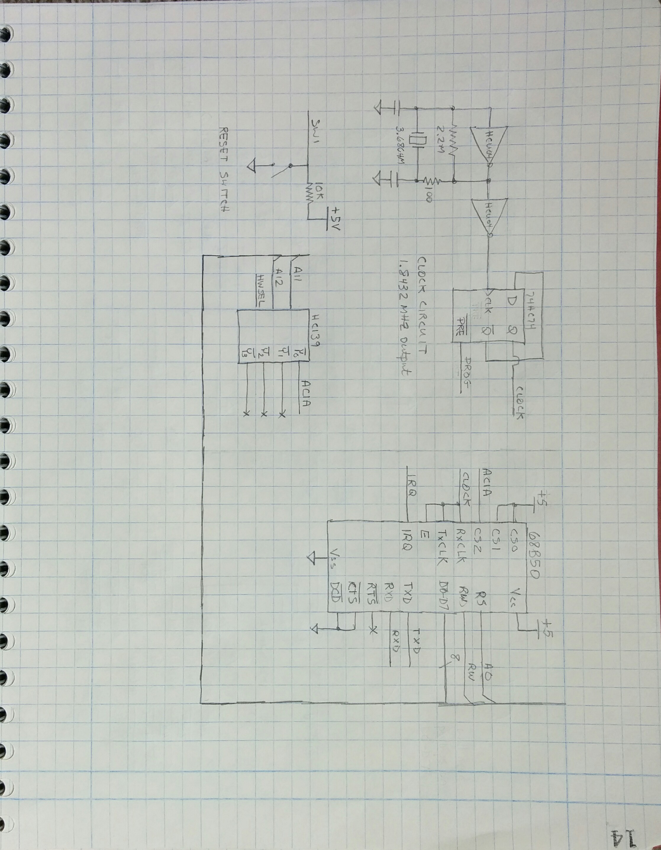

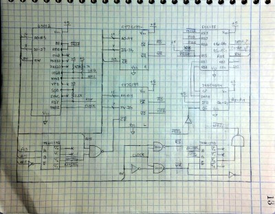

As a prelude to testing a PIC-based UART replacement, I find myself in need of a simple 6502-based computer for testing and prototyping purposes. To that end, I've put together a simple design and started building it.
The goals of this system are as follows:
  • Breadboardable
  • Little (preferably no) soldering required
  • No EPROMs
  • No DRAMs
The only potentially interesting thing about this system is the ROM Emulator. It should probably come as no surprise that I'm using another PIC microcontroller to create it. The PIC holds the 65C02 in reset and causes it to release (tri-state) the address and data lines by setting BE low. Then it loads the contents of the upper 8K of CY7C199 SRAM with a user-specified program. Once that's done (hopefully not more than a couple of seconds), the PIC releases the address and data lines it was controlling, enables the 65C02 BE and releases it from reset. Here are the preliminary schematics for the hardware buffs. When it gets closer to final form, I'll redraw it as several sheets in AD for readability and archival purposes.

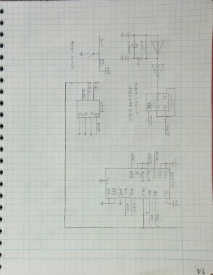

(sheet 2):

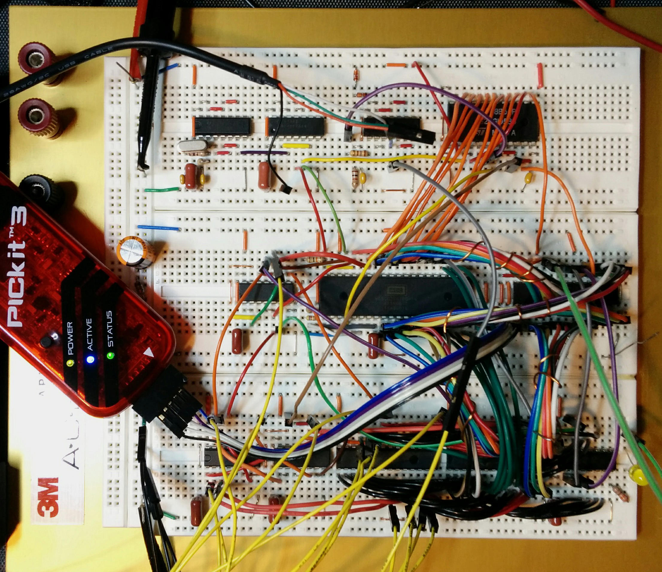

And here is the breadboard work in progress for those who prefer eye candy:
The only testing I've done so far is to wire up the data lines to return NOP and then check the address lines for expected operation.

PostPosted: Sun Oct 04, 2015 11:27 pm
Posts: 8507
The 65C02 data sheet doesn't indicate or even imply if BE is effective while RESB is held low. Have you determined if this will work?
Need to check the gate delays though to make sure it's not worse...Eventually I will turn up the clock speed further to see how close to 14 MHz I can get.
You will need logic that is faster than 74HC to go much over 8 MHz. Most 74HC logic is no faster than the 74LS equivalents. I recommend 74AC if you want to go up to 14 MHz. However, the much faster output transitions of 74AC may give you grief with your breadboard.
PostPosted: Mon Oct 05, 2015 12:17 am
Posts: 171
Location: Philadelphia, PA
This is extracted from the WDC data sheet:
The Bus Enable (BE) input signal provides external control of the Address, Data and the RWB buffers.
When Bus Enable is high, the Address, Data and RWB buffers are active. When BE is low, these buffers
are set to the high impedance status. Bus Enable is an asynchronous signal.
You make a good point that I should test to insure it is still effective when RESB is low and I will do so soon and report back here. I would like to think that if it is not effective when RESB is asserted, however, that they would have called that out in the datasheet.
I have a strong aversion to the 74AC logic family and will avoid it at all costs on breadboard designs. Instead, I prefer the 74AHC and 74LV logic families. The reason is -- as you suggest -- the 74AC logic requires a better ground than is usually possible to achieve on breadboard and this leads to lots of difficult to resolve problems for circuits placed close to the AC logic. Unfortunately, I can't find all of the logic gates I'm using in DIP form in the AHC and LV logic families, but I will cross that bridge when I get there.
Thank you for your input! It is appreciated and may well end up saving me a lot of debugging time!
PostPosted: Mon Oct 05, 2015 5:27 am
Posts: 1748
Location: Sacramento, CA
jmp(FFFA) wrote:
I can tell you that BE does work during /RES on the 65816, as my SBC-4's RAM get's loaded from an AVR microcontroller during /RES. Hopefully the logic works the same with the WDC 65C02's.
Daryl

PostPosted: Sat Oct 10, 2015 3:47 am
Posts: 171
I've got the basic circuit working with the PIC now. There were a couple of errors in the schematic which I found and corrected and I will upload the corrected version over the weekend. Even with the 74HC4094 shifting out the upper 8 address lines on every read and write, the system is capable of loading 64 kB of SRAM in under 1 second, which is more than fast enough for my needs at the moment.
Next step is to either put the 68B50 UART on the bus and then try a hello world program for it, or I could be more conservative and put a 74HC374 register on the bus with some LEDs connected and try to use that to verify the rest of the hardware is functioning as intended first. Either way I think I'm not far off from being ready to start on the PIC-based UART. Time to order a second PIC programmer for that too.

PostPosted: Sun Oct 11, 2015 2:05 pm
Posts: 171
The test system is now up and running and flashing LEDs on the HC273 Battlestar Galactica cyborg style. I see now why Phil P. used a latch instead of a register in his design as it was a bit tricky to get the timing of the arrival of the clock pulse to arrive within the window of arrival of data from the 6502. Thanks to the placement of a patented delay device (a resistor), it's working now. During testing, I discovered that the 16 channel logic analyzer limitation of my PICO-scope was a real PITA to work with. I've got an old HP logic analyzer with something like 128 or 256 channels on it but it has some bad electrolytics in it or I would already have switched to it. Can't decide whether to take the time out to repair it now or if I will be able to make do with the PICO. Guess I'll see how it goes.
I did take the opportunity to up the clock rate as high as 12.5 MHz and the system continued to correctly flash the LEDs. I'm a bit surprised as my decoding uses four levels of HC logic which seems like it would have a worst-case delay of more than half the clock period. I didn't have the right signals connected to my logic analyzer when I did this test in order to be able to see the correct signals. For all I know it won't work reliably at that speed either as it was a simple program and I left it running for only a few minutes at that speed.
I'm adding the 68B50 today and hope to have a, "Hello World" program working with that shortly. Once that's done, I'll freeze the 6502 code, remove the 68B50, and install another PIC in my attempt to build a clone of the 68B50 that is virtually indistinguishable in software from the real thing (and that will run at up to 32 MHz, not the 1.8 MHz the 68B50 is limited to). If you hate the 68B50 UART, never fear. For so long as your favorite UART doesn't have more than 4 registers, it should be a straightforward matter of changing the firmware to change the personality of the device.
