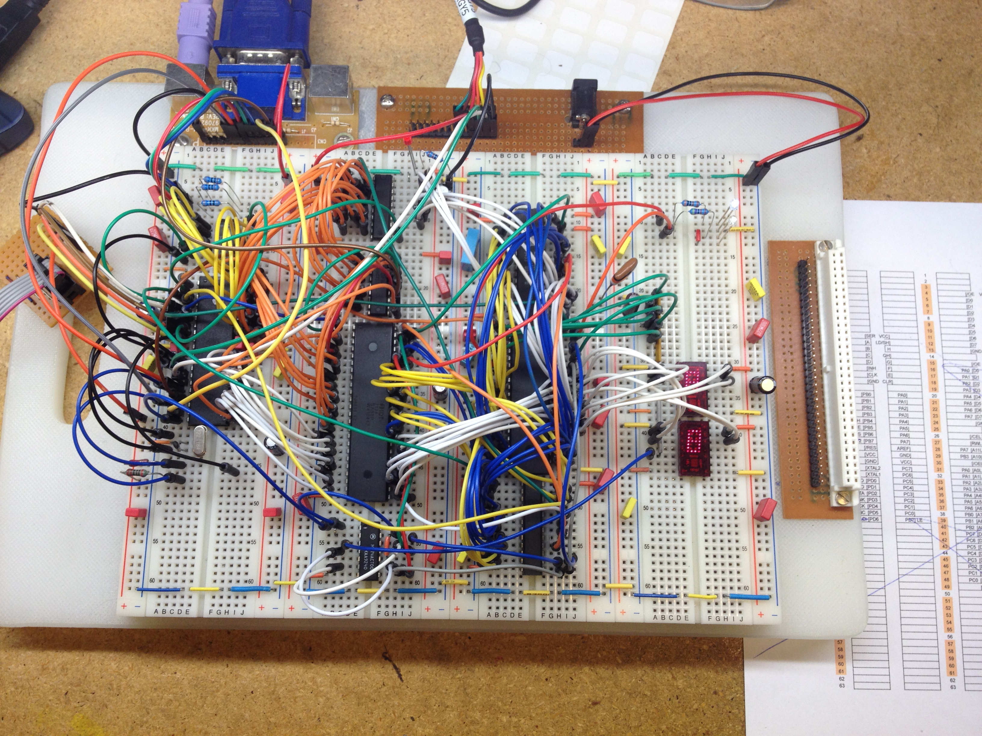

After a series of tests and proof of concepts I finally put all the pieces together and built the first version with all features together on a breadboard. "ROMulus the 1st", named after the fact that it is my first fully functional ROM less SBC.
Overview of the breadboard
It has the following features
  • W65C816 processor, not because it is needed but because it's the only CMOS version I currently have, a CMOS version is mandatory
    AS7C1024-20PC 128kbyte SRAM although only 64kbyte are used
    VGA text display (supporting 24x40 and 24x80 characters) using a 4k Dual-Port RAM (IDT7134)
    PS/2 keyboard
    The ROM Image is loaded to the RAM using the IML/blink-load method

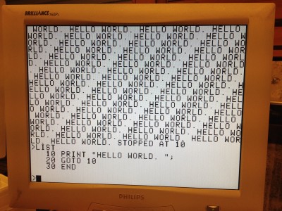

The VGA signal is generated using a ATMega1284P. The MCU uses a 22.1184MHz baud-rate crystal. This is also the VGA pixel clock. The VGA timing uses the 640*480@60Hz standard, but with only 560 pixels. A 74HC166 is used as the parallel to serial shift register to create the pixels and a 74HC573 is used as I/O port expansion.
VGA Display
VGA Display
The 22.1184MHz was selected to
  • support higher baud-rates (115200baud) for the XModem upload function
    support 7-bit wide character ROMs of legacy systems that have patterns which look good only with 7-bits per character
    only slightly overclock the MCU

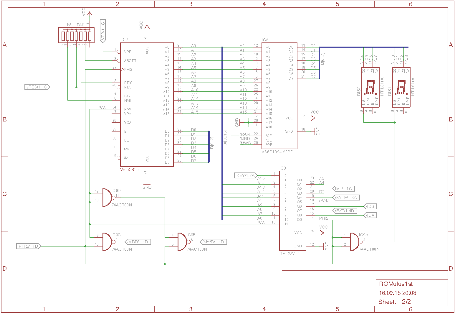

The glue logic uses a GAL22V10 and a 74AC00. The GAL implements the key wait flag and the address decoder. The 74AC00 is responsible for the Master-Read and the Master-Write signal (read and write enable signals qualified with PHI2). At the moment the memory map uses the old Apple II scheme and looks like the following
  • $0000..$BFFF RAM
    $C000..$C00F Keyboard Buffer holding the ASCII code in Bits 0..6 and the key wait flag in D7
    $C010..$C01F Clear the key wait flag
    $C020..$C0FF General IO
    $C100..$CFFF RAM for IO support routines, write protected after initialisation
    $D000..$FFFF RAM for the ROM Image, write protected after initialisation
I used the Apple II scheme so I could be using the original Apple II ROM (D0,E0, E8, F0, F8 ROMs) giving me time to concentrate on the MCU code first until everything worked. As all the address decoding takes place in the GAL22V10 the memory map can be easily adopted to the final needs without changing the wiring.

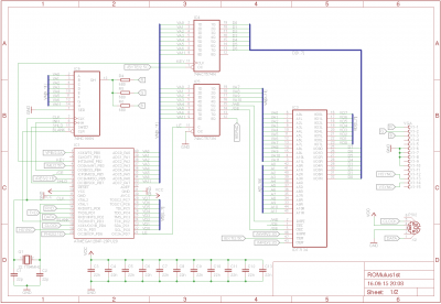

So here is the first set of documents I have created. First the schematic in two sheets
Schematic 1st Page
Schematic 1st Page
Schematic 2nd Page
Schematic 2nd Page
And the WinCUPL design file of the GAL

One question about the schematics, on sheet 1, is the parallel input to the shift register supposed to be VA0..6,11? I was expecting to find VD0..7.
I'll look forward to watching your progress!!
That's correct. This is on purpose. One issue I have is that the 80-column display only leaves 7 cycles per character and that I only can update 8-bits of the video RAM address. So I need to pack all address bits that might change in a row into the lower 8 address bits. The mapping you see is used when the VGA controller is used in my Apple IIe clone. The Apple II normally packs 3 character rows with 40 characters each into one linearly addressable memory block of 128bytes (3 x 40 leaving 8 bits per block unused). Thats why I have VA0..6 in the low-byte and I only need to change VA0..6 when I build the video display. VA11 is then added to the lower address byte so I can toggle the highest address bits for every other character when I mimic the Apple IIe 80-column mode and still only need to change one byte of address bits. The 6502 in Apple IIe mode then connects A0..A10 to address lines A0R to A10R of the DPRAM and A11R of the DPRAM would then connect to the Main/Aux RAM selector signal.
