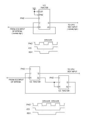

It occurs to me that in my earlier post I was describing Jeff's (Dr Jefyll's) "wait state generators" from this post and this post in another thread. My apologies to Jeff for the missing attribution.
Forgive me if I'm going off-topic, but, I'm curious... Could that wait-state logic be duplicated in a GAL/PAL?
Look here -> http://sbc.rictor.org/wsgen.html
You can use this as a starting point.
Daryl
Daryl pointed you to his GAL implementation of a wait-state generator, which is a good way to go about it. The same logic will work in a CPLD or an FPGA—Daryl's CUPL code with minor alteration is how I implement ROM and I/O wait-stating in POC V2's CPLD.
As a reminder, the NMOS 6502 does not respond to RDY during a write cycle. That deficiency was one of the reasons Commodore used "clock stretching" in the C-128 when I/O devices were being accessed.

All these wait state generators generate a fixed predicted number of wait states. Has anyone a more bus related wait-state generator? I mean something like used in typical bus protocols where the CPU is always halted until a ACK signal is generated by the selected device (IO, Memory, ROM etc). Preferably the ACK should be a edge sensitive signal. E.g. in a PDP-11 system the CPU always stalled when performing a read or write until a CONT signal was asserted on the bus. Even Memory had to create the CONT signal.
