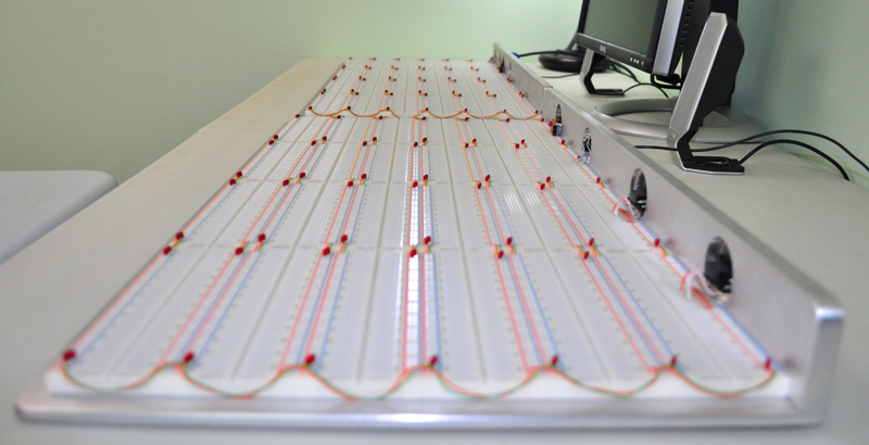

Even if I do eventually to a PCB, I will still take it through a hand wired board first.
The hand made oak / glass cabinet will have windows to both sides of the board to show off the insanity as well.
Yep! Aside from its functional abilities, the mess 'o wires is very impressive to gaze upon. With my background in areas such as PBX switching systems and early "computers," places where a lot of wiring was commonplace, I can fully appreciate a breadboarded contraption like this. :D No reason to not show it off "under glass."

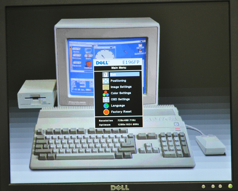

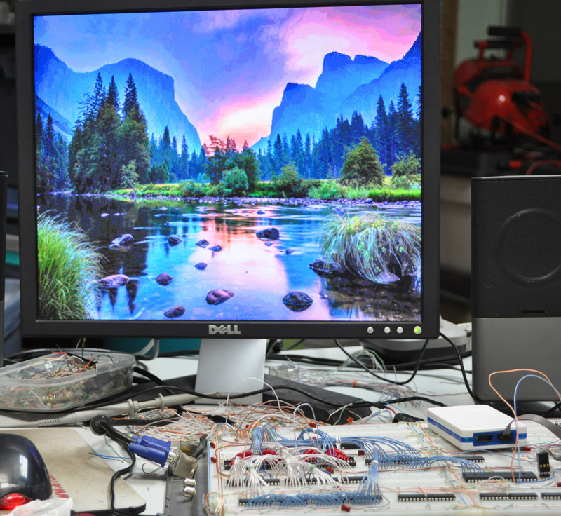

Does it work?
Well, my monitor thinks so!...
An old friend being immortalized with retro logic!
The image is not perfect yet because the DAC is not perfect, and my converter program simply divides by 16 to go from 8 to 4 bits.
I know there is a better way to convert 24 bit RGB bitmaps to 12 bit, but I have to learn how. Dividing by 16 is just a hack for now.
Also note the frame frequency of 71Hz instead of 70Hz. The VGA standard wants a 28.322Mhz clock, but I had a 28.636Mhz clock available.
I also plan to go to 640x480 instead of 720x400, as this is a more favorable aspect ratio for most monitors, and for game graphics.
But hey... I had to see if I could crank out 720 HD Video using nothing but 1980's logic chips!
So far, this is the best image that Vulcan-74 has achieved, and I have only done slightly better on a Spartan-6 FPGA!
The 4096 color, high resolution display offers a very rich experience...
Not bad for 12 resistors and some logic gates!

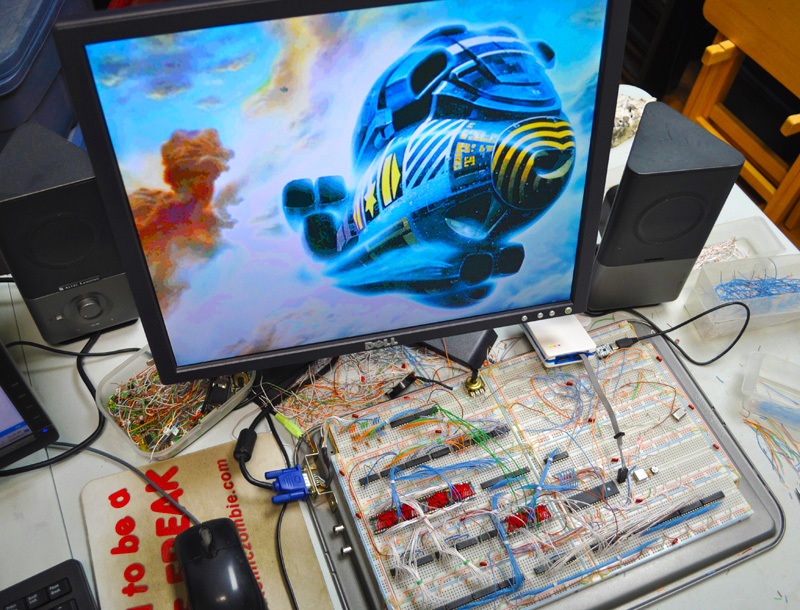

PostPosted: Tue Feb 28, 2017 5:23 am
Posts: 632
I did a bit of fine tuning tonight, and now the image looks much better.
Instead of dividing each of the 8 bit color values by 16 (to go from 8 bits to 4), I use a table.
The values are best match to one of these 16 values...
0,17,34,51,68,85,102,119,136,153,170,187,204,221,238,255
This seems to blend the shades between colors a bit better.
I can also save an "advanced bitmap" from photoshop as 4x4x4, and that looks good as well.
I also tweaked my serial routine to receive the entire 640x480 16 bit image in 15 seconds.
This is pretty fast, considering an image is 614,400 bytes in size!
Serial loading my be the final option for loading cartridges into the final design.
The resistor DAC is still a bit too "hot" at .85 volts, but the image sure looks decent now...
640x480 with 4096 simultaneous colors.

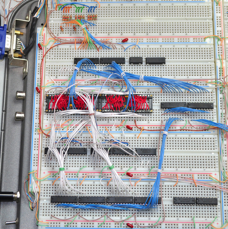

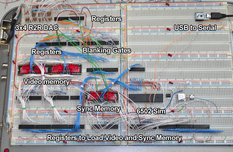

Alright... Vulcan-74 now has a new Video Generator design!

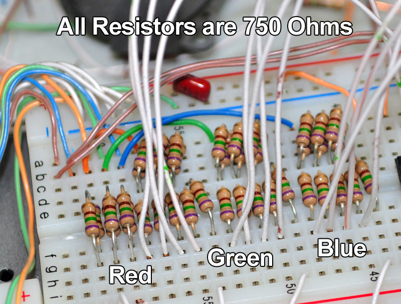

I replaced the simple 4 resistor DAC with a triple R2R DAC using 750 ohm resistors.
The R value is 375 ohms (750 in parallel), and the R2 value is 750 ohms.
This works out to .72 volts, which is much better than what I had before.
The results are so much better now, only the last shade of white is a bit too hot.
I am seriously pleased with the image, and plan to use this in the new Vulcan-74 design.
The massive breadboard will once again start taking on millions of wires!
What is shown below is only half of the Video Generator (single buffer)...
Sync Logic has been replaced by an SRAM lookup table.
The Video Memory is addressed as 1024 (10 bits) by 480 (9 bits).
Since the Pixel Data is 12 bits wide, it takes two 512K SRAMs to make a single Video Buffer.
The Sync Memory is addressed as 50 (6 bits) by 525 (9 bits). A 32K SRAM would suffice.
The reason for the 50 x 525 Frame is due to the way I divide the VGA standard down...

Here is the triple 4 Bit Dac that generates the video...
Three R2R DACs, each with 4 bits.
Yep, it's just a bunch of cheap resistors. We don't need no high end digital DAC!
The resulting image is actually amazing... crisp and vibrant.

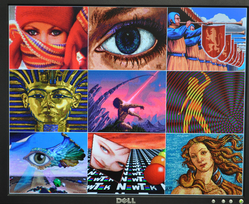

Here are a few of my favorite Amiga images made into a 3x3 mosaic...
640 x 480 VGA with 4096 simultaneous colors on screen!

Can't wait to see some animations at this resolution and color depth!

Every time one of these crazy "upgrade" ideas actually works, it just drives me to keep on building this thing! When I first started building video systems using logic gates, I was amazed to see a 256 x 240 image being displayed with 256 colors. Even last year, I would never have thought that getting 640 x 480 with 4096 colors from a breadboard would even be remotely possible. The only other 640 VGA generator I have seen out there uses AC logic, and can only push mono color using the old shift register technique. Vulcan-74 also follows the posted VGA spec to the exact nanosecond in every way. Not one clock cycles is lost during the entire 460,000 cycle frame.
Using only 74HC logic (withing specs) was certainly a challenge, but thanks to many register levels (74HC574), it has been possible. So instead of trying to get from point A to point B in 40 nanoseconds, I simply alter the course, and go from point A to point B then from point B to point C, running each race in under 40 nanoseconds. Not cheating... just altering the rules!
This register level system does have its limits though. I have found that 28MHz is the absolute maximum speed that a 10ns SRAM can register data. 16ns from the counters, 10ns from the SRAM, and 8ns setup time for the register equals 34 nanoseconds, which is 29.41 MHz. At 28MHz, 720x400 VGA is possible, but I chose 640x480 because it has a better aspect ratio, and only requires a 25MHz clock speed.
I am going to strip the two giant breadboards completely bare this week, and start rebuilding Vulcan-74 with this new 16 bit Video system, which also includes the Sprite Generator. I will probably start making posts on my Vulcan74.com site since there will be a LOT more detail and photos in the final breadboard build. I will still keep updating this thread as well.

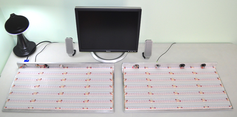

Vulcan-74 is officially getting rebuilt.
Faster, stronger, and more colorful.
Now that I have tried several design ideas to see what works and what doesn't, it is time for the final breadboard.
After the breadboard prototype is functional, I intend to hand wire another duplicate on hand driller perforated board.
The two massive breadboards have been striped clean, and are awaiting re-population...
That 19 inch monitor looks small beside those huge boards.
I probably won't run out of board space, but you never know!
There are 48 panels here, for a total of 42,336 connection points!
The new VGA System is 640x480 with 4096 colors.
The new Blitter system will also use 12 bit color, and an epic amount of SRAM.
Vulcan-74 will be able to copy and scroll Bitmaps of 2048 x 2048 in size!

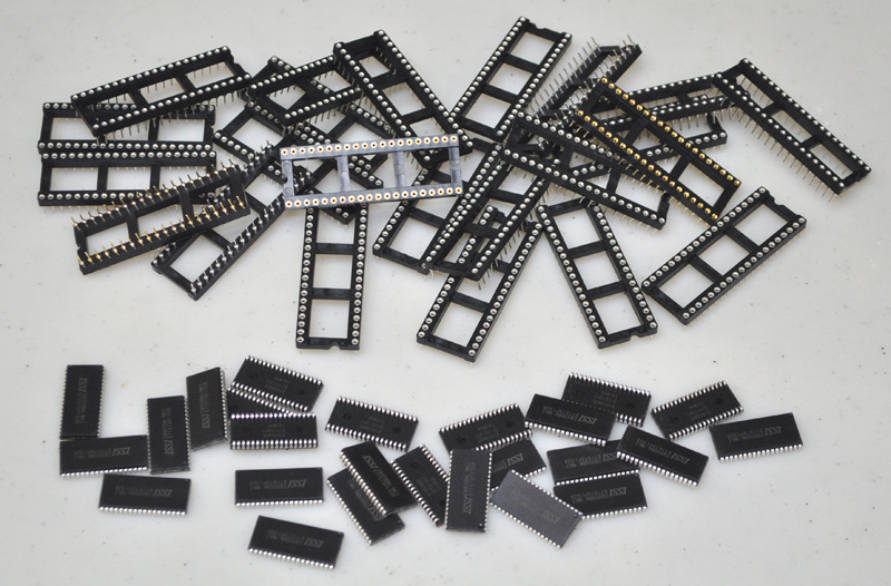

The sound generator will have its own 2MB of dedicated SRAm as well.
For this kind of performance, you need a lot of high speed (10ns) SRAM...
This is 13,107,200 bytes of Static RAM.
Yes, I now have to hand wire 25 of those 36 pin packages to their DIP sockets!
I might not be reporting back for a while. It's going to be a monumental task of patience.
Once I have all of the SRAM mounted, the rebuild shall begin.
