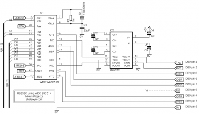

Yeah, so I'm finally tackling my nemesis: Well, one of them at least! RS232C.
I've already got a serial card installed in my PC, have got some WDC W65C02N ICs and a MAX232 or two.
Hooking up. Here's my circuit digram. I've made it by examining circuit diagrams that I've found elsewhere.
Can someone cast a beady eye of it to ensure that I've gotten it right?
I'm havaing a good e-read through Garth's guide and the W65C51N datasheet to see how it actually works. I get the whole -10 to -12V as a 1 and +10 to +12V as a 0, the bit sequence, and parity so far. Or at least I think I do :mrgreen:.

I might replace the 1.8432MHz crystal with an oscillator can of the same speed.
[edit] I wonder if, over longer distances, that a ferrite ring would help at all? Or what about splitting ground to 2 wires and twisting them together - much like Ethernet?

I've been running a serial port as a console on my 65C02 system for a couple years now. I implemented a full RS232 port using a Maxim 238. Some things to think about:
1- Use RTS/CTS handshaking (hardware handshake, aka 5-wire null modem) to ensure you can send and receive without losing data.
2- Use a double rate can oscillator and you'll get 38.4K baud rate (been running this way for a long time).
3- Consider a Serial/USB adapter instead of the Maxim level converters if you ultimately will be interfacing via a USB based serial port (like the FTDI stuff).
4- Careful on selecting a 65C51 chip and search the forums for the defective W65C51 issue with all new WDC sourced chips.
Highly recommended.
None of those steps are beneficial in my opinion. Ethernet is balanced to ground, whereas TIA-232 (aka RS-232) is not.

Hi banedon,
With the 6551 I always use crystals and have not had any issues. Just carefully read the datasheet, some 6551 require a 1MOhm between XTI and XTO others don't. I prefer this solution as I can use the space under the 6551 for the crystal and the capacitors to save real estate on my PCB.
Normal baud-rates with a 1.8432MHz crystal indeed go only up to 19200. However there is the "external clock" setting for the baud rate register (set SBR to 0), then the baud-rate will be at 1/16th of the external clock. When you have a 1.8432MHz crystal this gives you the additional baudrate of 1843200/16 which is 115200baud. The 6551 does not know that he himselfs generates the clock at XTI :lol:.
By the way, as I don't have serial interfaces I mostly use http://shop.clickandbuild.com/cnb/shop/ftdichip?productID=49&op=catalogue-product_info-null&prodCategoryID=105 cables. They are also available with a 3v3 output. USB provides enough power for a CMOS based 65xx SBC,so I even power the SBCs from that cable, especially during setup and testing. Just make sure you use a inexpensive external USB Hub to protect your precious USB ports on the PC. This saves the MAX232 level converter.
Yes the 16550 complement pair of read and write enable signals can just be used as you said. Tying RD and WR to VCC and connect /RD and /WR to the respective signals created by the GAL should do the job.

Being able to reliably use just a crystal is part of the 51's design; and yes, it is totally reliable if you follow the rules and put the tiny capacitors in. [Edit: I see in a 2005 WDC data sheet that they had problems with the oscillator on the '51, and they recommended using an external oscillator. The Oct 2014 data sheet does not have this, so hopefully they got it fixed.]
The transmit-register-empty bug in WDC's '51 requires that you be sure to leave enough time to shift a byte out before writing another one. It's a disgrace that they introduced that bug; but it does not keep the whole thing from working.
The only thing I would recommend is using jumpers for selecting options, like:
  • whether or not to go through the line drivers and receivers
  • whether or not to use the hardware handshake inputs
  • choose between DCE and DTE (so you never have to use a null modem adapter)

Hi banedon,
If you want to directly connect to a serial port of the PC (RS-232) you need a MAX232 or equivalent to shift the TTL logic levels of the 16550 to the RS-232 levels and protect the 16550 from the high voltages that RS-232 uses.
When interfacing the 16C550 to the 6502 you normally tie /AS (address strobe) to ground. So the relevant times are the longer address setup time (there are two setup times in the datasheet) and the strobe widths (for /IOR or /IOW) and the read or write cycle delay.
Then you have the following rules to obey:
    PHI2 low time must be at least address setup time of the 65C02 plus the address setup time of the 16C550
    PHI2 low time must be at least as long as read or write cycle delay
    PHI2 high must be at least /IOW or /IOR strobe width
these times depend heavily upon the manufacturer. The TI is a very slow example and PHI2 high and low phase would have to be at least 80ns, the total read or write cycle must be at least 175ns, which allows you to run the 65C02 only with approx 5 to 6MHz. The EXAR is twice as fast. And the EXAR supports 3V3 operation.
cheers
