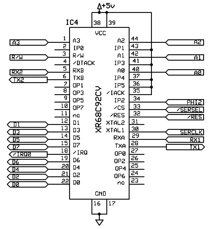

Hi BDD,
I'm curious, what about the XR68C92's bus is hard to interface? It bolts right up to the 6502's bus with no special interfacing?
Here's the schematic image of the XR68C92 from SBC-4:
The /SERSEL logic for pin 33 is simple AND'ing of the relevant address bus lines and PHI2. Here's my code straight from the SBC-4 CPLD source:
IOPAGE = !A23 & !A22 & !A21 & !A20 & !A19 & !A18 & !A17 & !A16 & !A15 & !A14 & !A13 & !A12 & !A11 & !A10 & A9 & !A8;
!SERSEL = !A7 & A6 & A5 & IOPAGE & PHI2; SER = $000260 - 027F
I'm not trying to criticize your selection of UART or your reasons for not wanting the XR68C92, and I have nothing against the other UARTs out there, I'm just trying to understand your statement.
Also, the package I used was a TQFP, which is relatively easy to solder compared to PLCC and SOJ style packages. It is sitting next to the green LED in the photo on this page: http://sbc.rictor.org/info4.html
thanks!
Daryl
I was using "interface" in the abstract sense, not the literal hardware hookup. I don't recall all the little details at the moment (it's been six years since I designed POC V1), but I think it had something to do with writing the drivers.
One thing I do not do is qualify any chip selects with Ø2. With the '816, as soon as VDA || VPA goes true the addressed device is selected so as to assure that it has plenty of time to respond and prepare for access.
I socketed the UART, so I didn't have the dubious pleasure of trying to solder 44 J-leads. POC V2 will be using the NXP 28C94, which is in a PLCC52 package, and also will be socketed. I'm tempted to try the TQFP package but know that I can't manually solder anything with that fine a lead pitch. I hope to soon have a reflow setup going.
Ok - I understand that. Thanks!
I cannot remember if I had an issue with the /CS not being qualified with PHI2, but having it qualified does work.
That would be nice. Since the SBC-4 has a solder mask, I was able to do the "glob it on and then use solder wick to remove the excess" method on the UART. TQFP makes that easier. I soldered the 36 pin SOJ SRAMS because I could not find a decent and cheap socket - I would not want to attempt to solder a PLCC chip.
