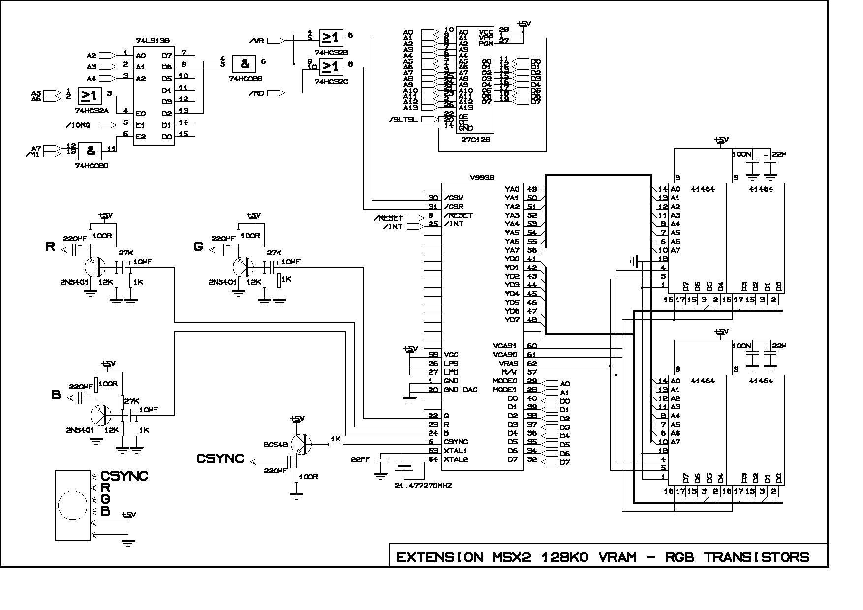

You can have a look at the MSX machines with a V9958.
Like the turbo-R. Circuit is in the service manual on http://msx.hansotten.com

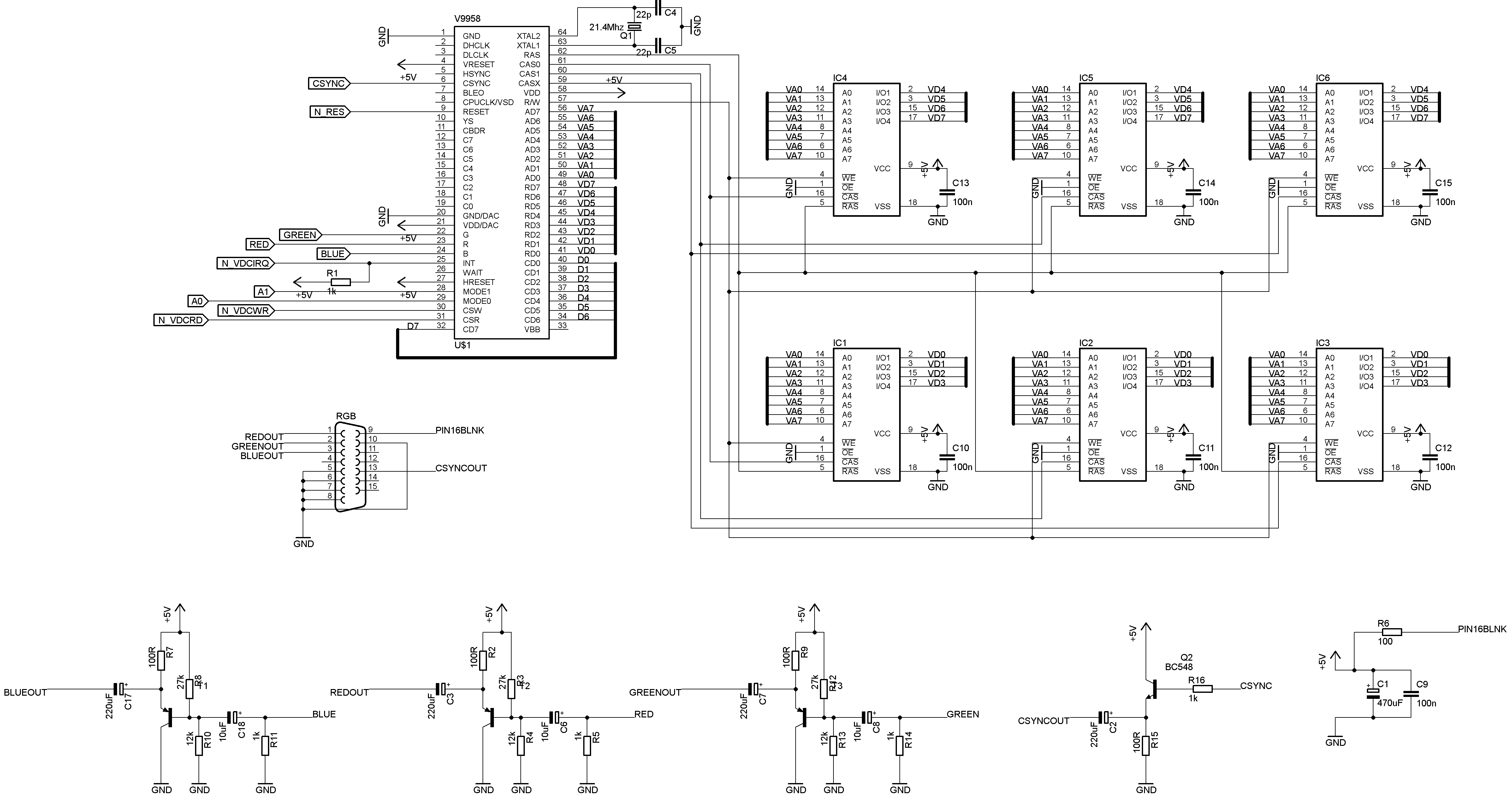

After Aslak3 successfully made an interface for the V9958 to his 6809 SBC, I made my own for the 65xxx CPU and modified the RGB output to get a better picture.
Furthermore I took the output drivers from a schematic which HansO provided.
(see attachment)
So credit goes to Aslak3 and HansO.
The picture is stable and sharp. Picture quality depends very much on a clean power supply provided for the VDP.

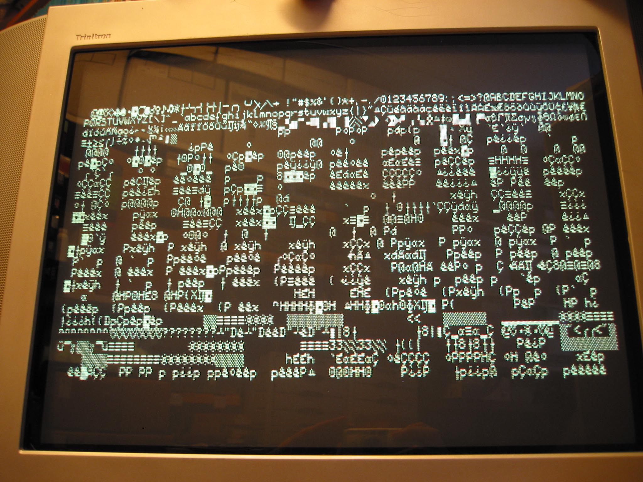

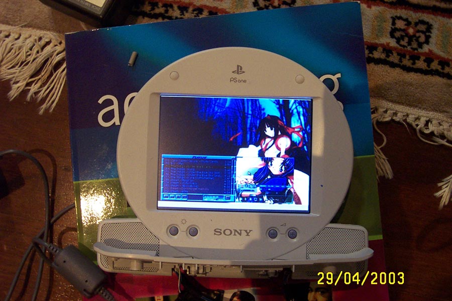

Sony Playstation LCD, aka PSOne LCD
lordbubsy wrote:
Why, do you want to connect it to a VGA monitor? If so, the VGA monitor has accept 31kHz, and as far as I know, only old MultySync monitors can do that.
the story goes more complex :D
i have also been designing a VDU in vhdl, i have realized something (a few vhdl lines of code for a very simple bitmap frame buffer) that works for a VGA lcd, so i am using H and V sync, as they are described in the VGA documentation.
For the V9958 & my VDU-fpga-project I'd like to use the Sony Playstation LCD, which is RGB-S, so, in order to re-use what i have done for VGA i need to combine my actual H_sync and V_sync into a C_sync in order to inter the PSOne LCD
The PSOne LCD AV-connecotr has these signals
  • video_R
  • video_G
  • video_B
  • video_composite Sync
  • LCD_enable
  • sound_right
  • sound_left
The V9958 could directly connected to the PSOne LCD, more work is required for the VHDL code.

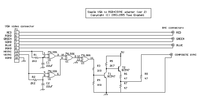

BTW, about C_Sync, it seems it is derived from the following circuit
 Post subject: Re: VDU, V9958
PostPosted: Tue Jan 20, 2015 9:01 pm
Joined: Sat Dec 08, 2012 8:29 pm
Posts: 62
this page is teaching something about
we know that
  • composite sync is a combination of horizontal sync and vertical sync
  • horizontal sync is short, frequent pulses
  • vertical sync is much less frequent, much longer pulses
  • H_sync pulses still occur during the V_sync
It seems to me that, aside from getting things to the appropriate polarity, and apparently some pulse shaping/limiting
that's what the XOR in the diagram is doing
or not ?
what do you think, guys

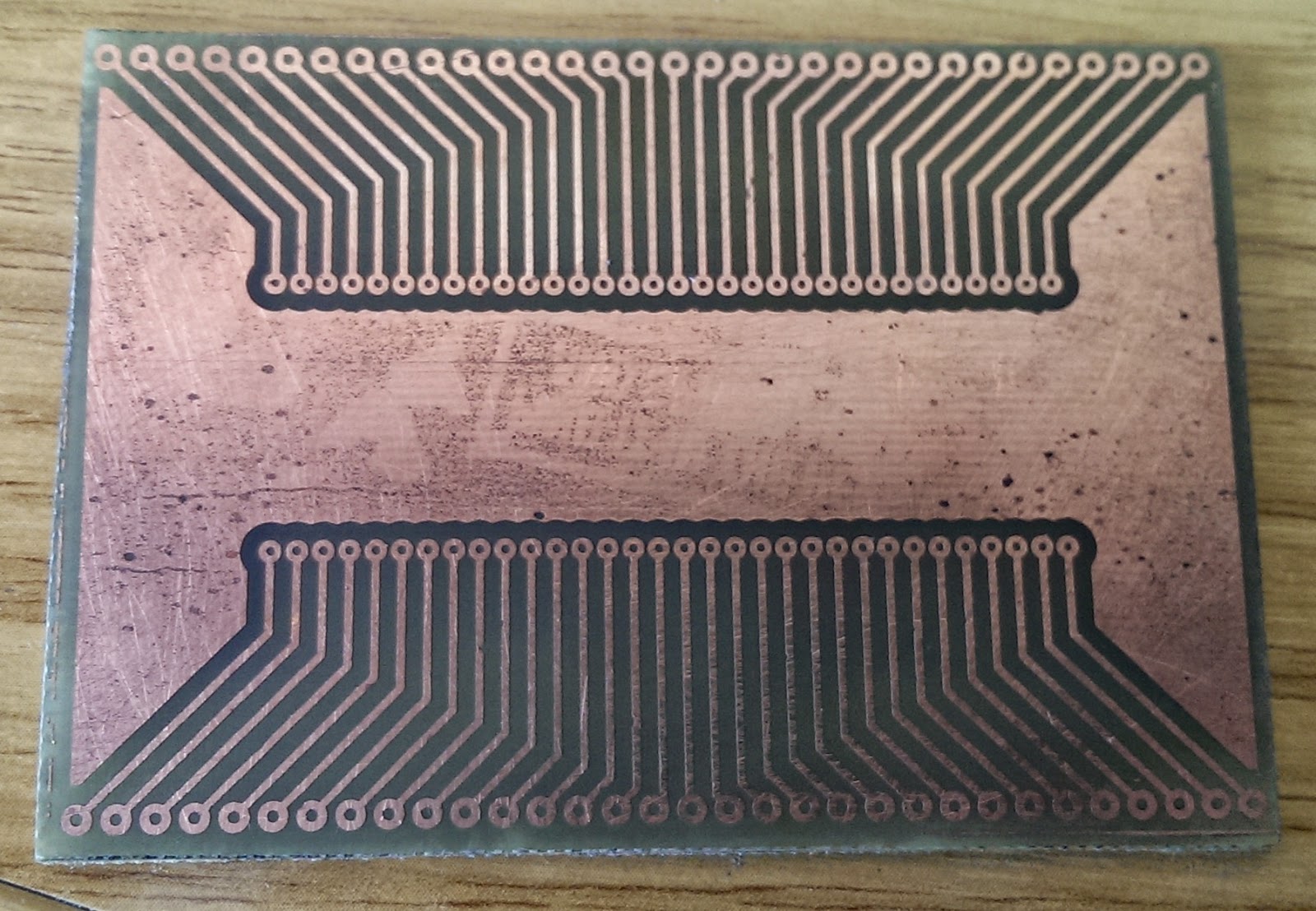

guys, a foolish question: where can i buy an adapter like to one in the figure ?
that guy has realized it to be home-made realized but i do not have the equipment to realize such a things, so … i could design it and ask a Service to realize it for me, or … buy it already done
it should be useful to "try & toy" with hardware configurations, e.g. try to use a SIM30, or a SIM72, or something like that
